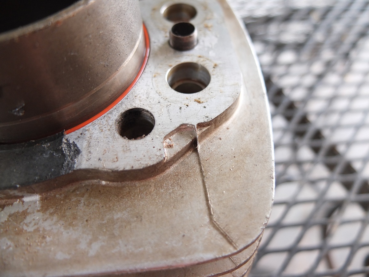

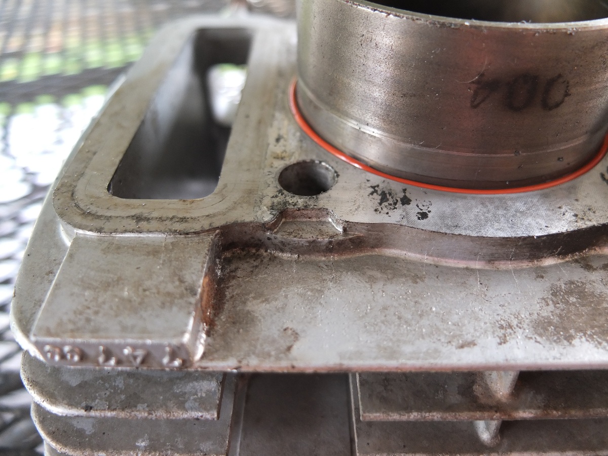

I don't know about that exact spot but I have seen similar details cast into yamaha crankcases - for lodging in a wedge and prying them apart (to break stubborn gasket cement). But yeah, seems odd just there?
+1 on that - same on quite a few Japanese makes - including my KZ750 (twin) ........
There's actually a pic in the workshop manual with a pry bar being used !!
Exactly correct, there are 2 points cast into the cylinders to help split it away from the cases if the gasket gets stuck.

Thanks for the pics and info... Lets hope its the left side engine cover leaking then and not the base gasket...

Exactly, those are pry points, even says so in the workshop manual! :) im guessing by your intake/exhaust setup and no power at small throttle openings you have not raised the needles? Mine needed to come at least one notch up with pods and 3-1 2" exhaust.
