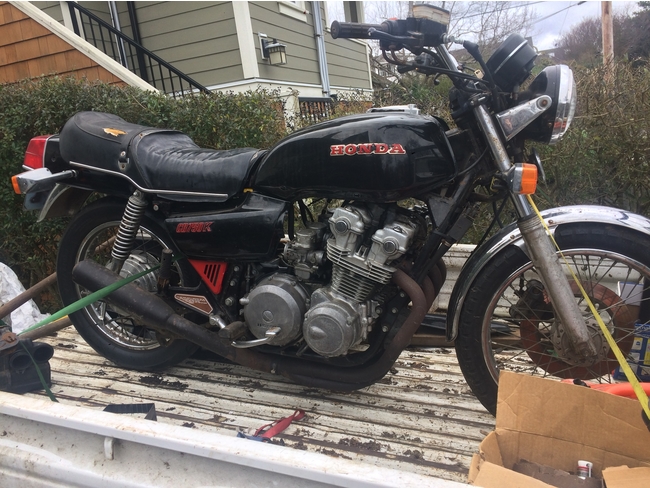

'79 CB750 K
Nybz
Well it is frick'n cold in the garage and I don't really feel like handling cold metal pieces right now, so I thought I might as well start a build project. Yet another CB750 DOHC! Long live!
My plan was originally to have this bike as a parts bike for my '79 CB750 LTD. Found it for a few hundred bucks, not running.
I got the LTD on the road and running great, so I started to strip down the bike, and I couldn't help but to want to rebuild this bike too. It was pretty rough, but after starting to take it apart it didn't seem like it was that bad to have all broken up in a million pieces sitting on a shelf.
So onwards and forwards!
The boat tail light is pretty rare for the CB750, I believe they were only made that way for one year. There was actually less of these made then the "Limited Edition" bike that I also have. So I wanted to keep some of the 'originalness' of the bike and not do a full blown café or anything like that. I am more of function over form kinda guy.
I wanted to create some sort of zombie apocalypse style bike. I have toned down the idea a bit but still want an aggressive looking black bike with some red accents.

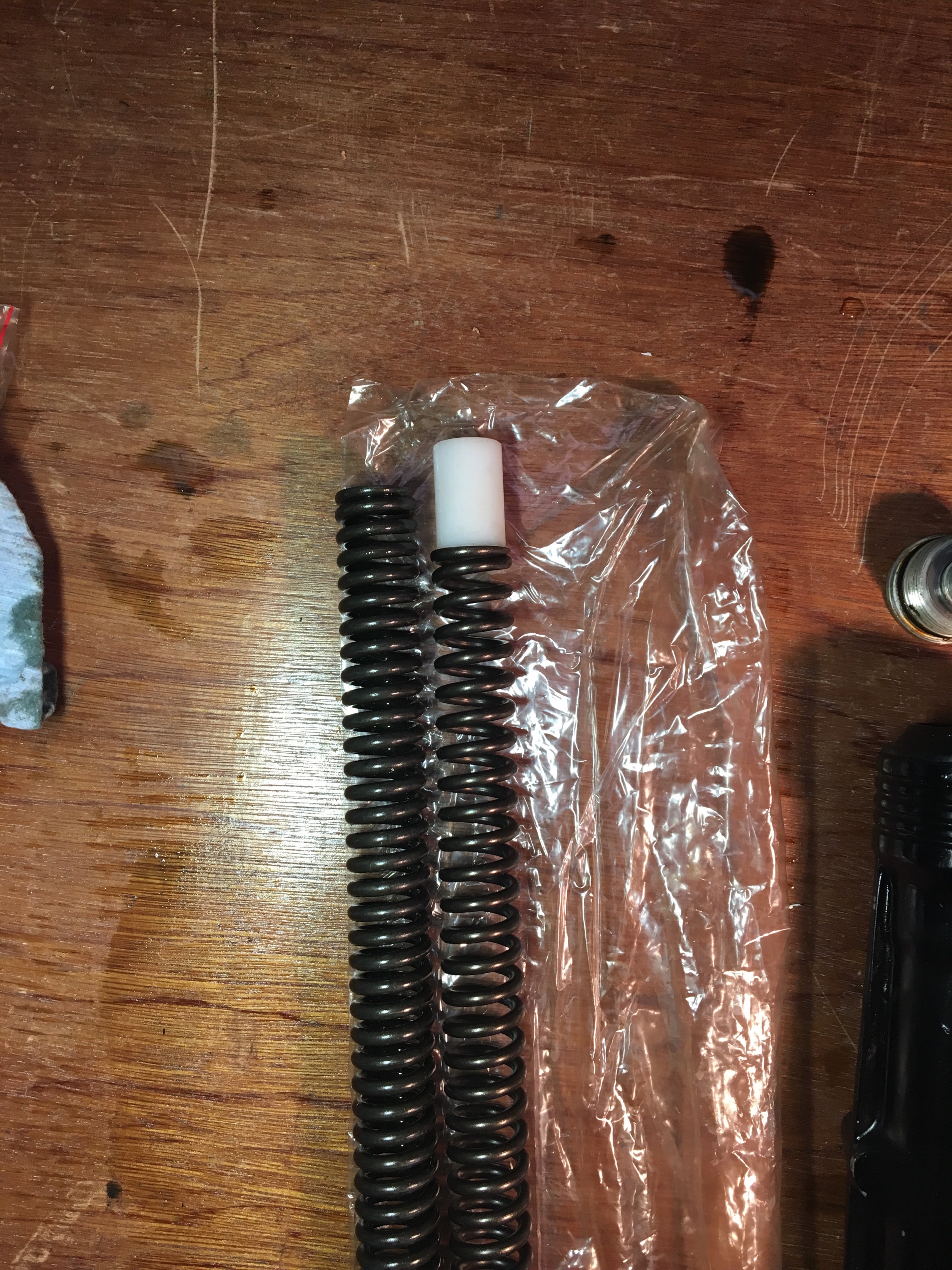

It is alot easier to take apart with them still attached to the triple tree. Made a quick bolt ‘tool’ to help me get off the top cap.
Comparing the new springs I got to the old one, they are smaller but they come with a spacer, which if installed would longer in length then original.
I wonder if I cut the spacer down to size to fit the original length or install it as is, and probably wrestle trying to put the top cap back on.
I got them from vintagecb750, and upon a closer look they say progressive ‘type’ springs. Perhaps I will send them a message.

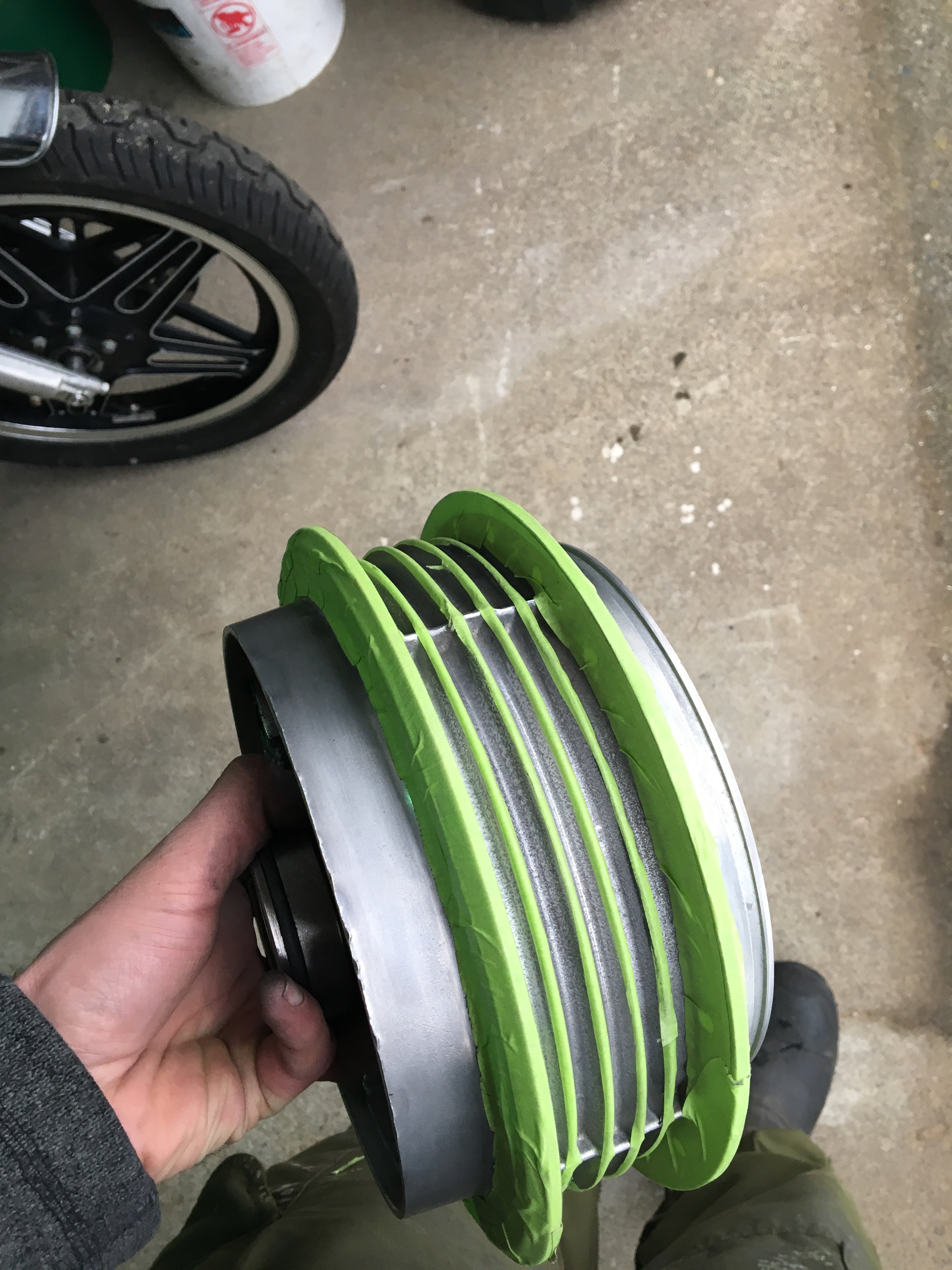

It has been difficult trying to paint in a cold damp garage, but I got a system going that I think will work. Anyone got some tips beside hot water heating spray cans, and a little make shift heat booth.
I have been heating the metal before painting with a blow torch and it is amazing how much moisture is held inside the pores of the aluminum. Dripping...Good to get that out before painting I would think.
Dripping? For real? I had no idea aluminium could hold that much water. I’ll be painting my engine soonish - never thought to heat the engine that much before paint. Maybe I’ll get a heat gun on mine first. Good call.
Getting the rear hub painted and ready to get put back together.
I used primer, semi gloss caliper paint, and a chemical resistant clear coat. I could have done a better job at taping. I will clean up some lines.
I really debated powder coating parts or not. Especially rims....might regret it. It is just really expensive to take it to a local shop here, for some reason? But I am hoping this paint will do the job with proper prep.
I might pull the trigger on a home powder coating kit from Eastwood for my next project. Cheap enough and would pay for it self quick. Just need figure out 220v out to the garage to put in an oven.

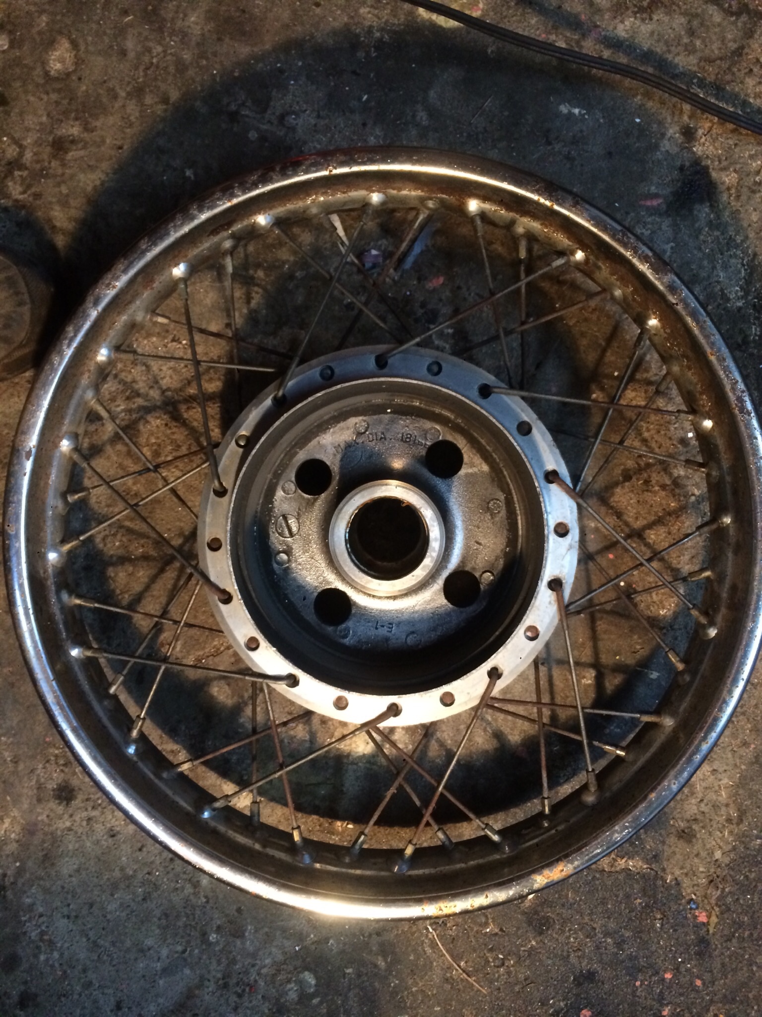

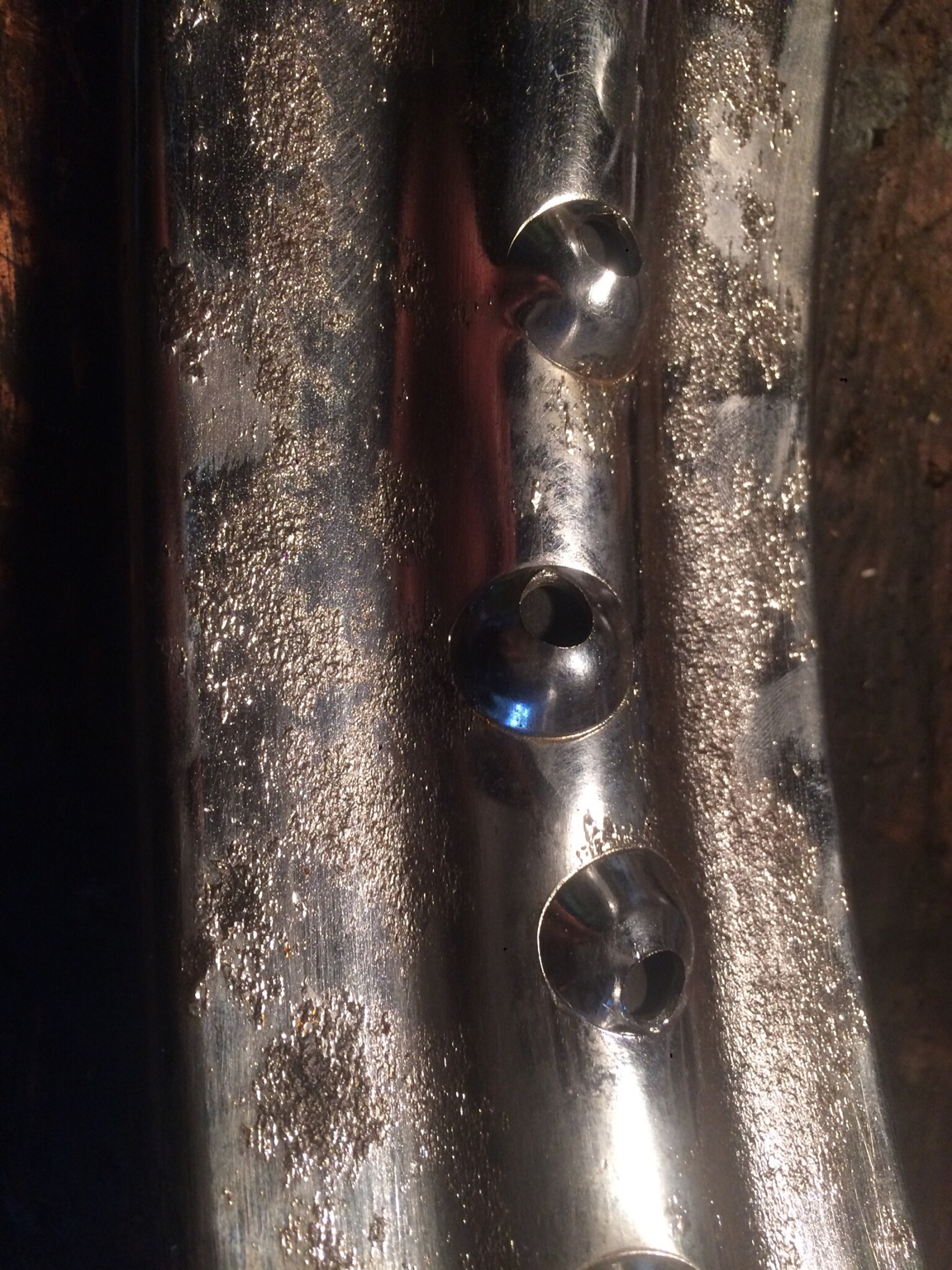

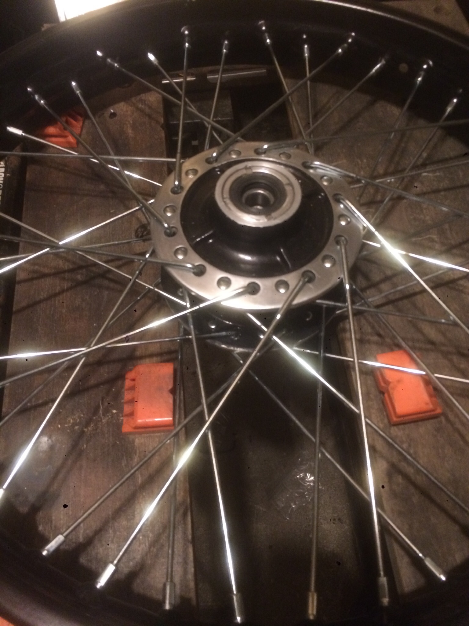

Here is the front hub.
New spokes, new bearings, retainers, seals.
Threw in some before pictures. Some pretty bad rust to deal with. Lots of sanding....

I'm on Tapatalk right now, so can't give the exact process, but there should be a link in the web site version of the forum that says INLINE. Make sure your cursor is where you want the photo, then click place inline (I think you do it after uploading the photo).
BTW, there is a good chance that the water you see dripping off aluminum when heated with an open flame is water condensed from the flame. Best to heat with a heat gun. If you had great results though, carry on!
I did my hubs like that, but painted the entire thing black and then used a paint pen to color the fins gold.
I like to keep my paint indoors if its going to be cold out, along with the part to keep it at room temp. Spray and then keep a space heater near it and should be good to go. Good progress so far though.
