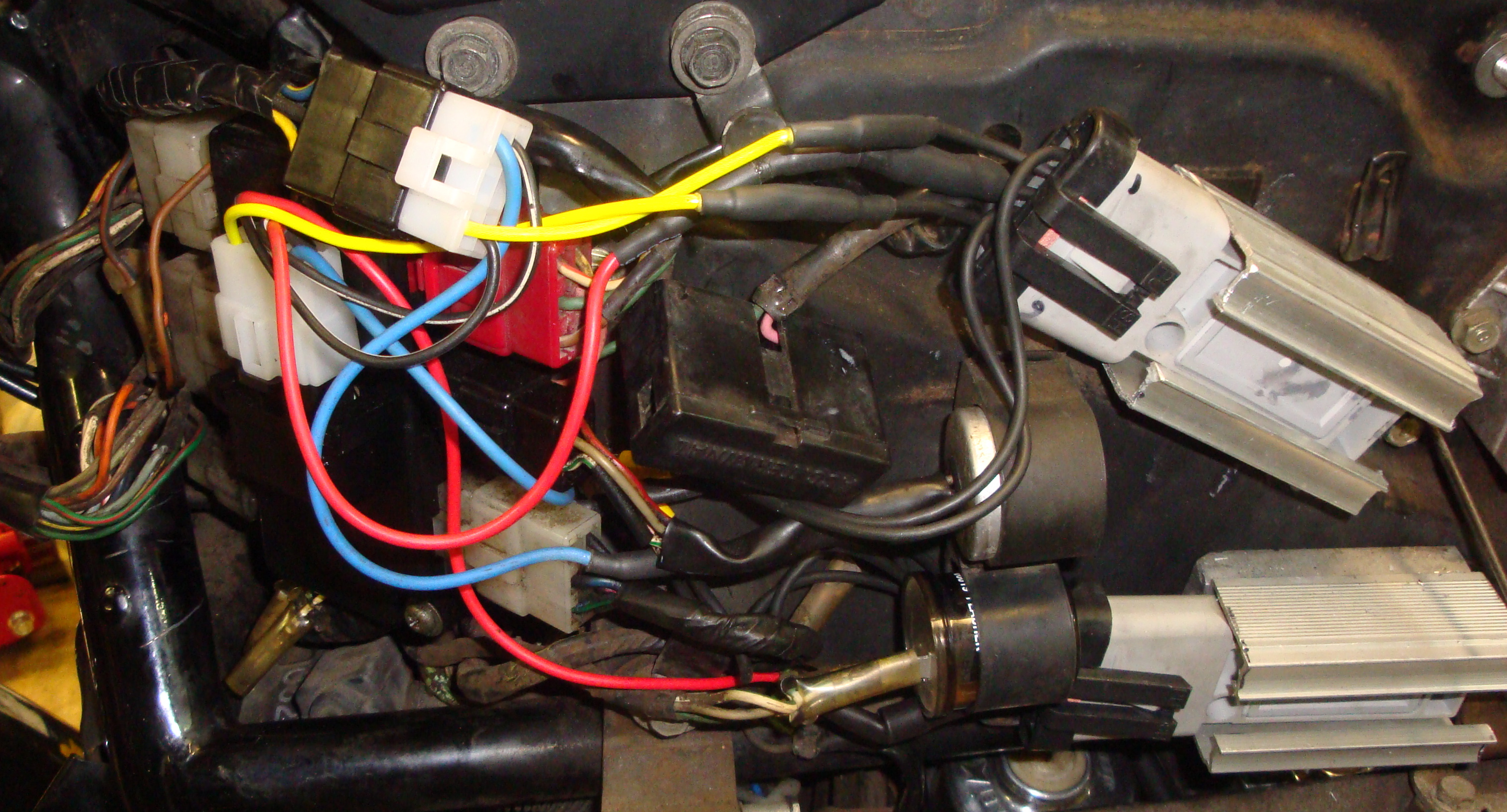

Been wanting to try an experiment of using Ford TFI modules triggered by the points to handle the coil current and dwell. So, today I finished up the wiring (well, I need to make it neater). Preliminary testing was good as it fired right up when I switched from normal ignition to the TFIs. But, then I ran out of gas so further work will continue when I get a petcock kit to repair a weepy petcock.

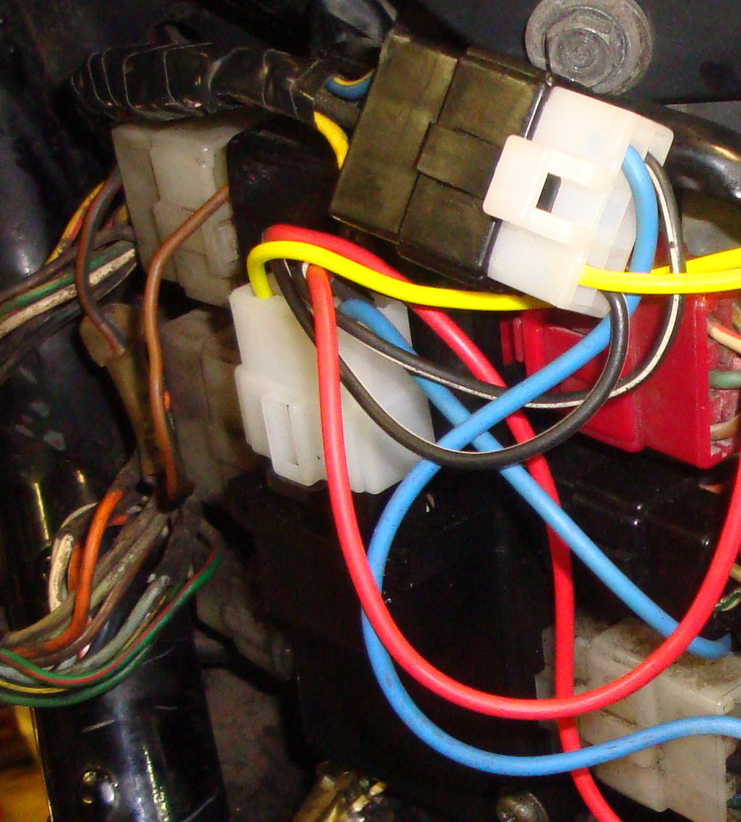

Anyway, it all connects via the six-prong plug on the front of the wiring interface. Just unplug the connector, plug the male from the TFIs into the box and the female into the cable that goes to the coils. Then unplug the condensers from the double connector near them. That's it! if a module should crap out all I'll have to do is swap back (takes less than a minute). I've read about the modules being used on drag cars. The main thing to worry about is cooling, and feel that the 1/2" aluminum blocks that sandwich the aluminum shower door rail with Arctic Cool heat transfer paste should carry away heat pretty well. Still I plan to scan them with an IR thermometer as soon as I can stress them. I see that I also need to re-route some of the cables going into the front of the interface. More PO fun!
The new white plugs go to the TFIs (yellow wire to the 1&2 Right coil, Blue to 3 & 4 Left coil). Red wires power the units from the old coil power feed that still jumpers to the coils and black leads to ground. Ballast resistor is jumpered in the plug as the TFI limits coil current to safe levels.

Took a quick ~5 mile ride this afternoon. Feels normal with the new ignition. Temp on TFI body 27 C when I got back to the house. Think I'll ride it to the Time Warp Tea Room this evening.
Neat TFI conversion. Should work pretty good and be reliable. The problem with TFI on Ford cars/trucks was placement which caused overheating. I doubt that will be an issue on a bike.

Rode about 40 miles RT to the Tea Room tonight. TFIs were not even warm when I got home. I think I like it!

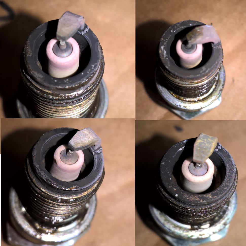

Brought her out a couple weeks ago from winter's slumber. Reset timing again but it was spot on. Adjusted one of the pilot screws out a full turn because the plug was white. Ran until hot, rode about 45 miles and after it was cold pulled plugs again. This time that plug was darker than the others, so I closed the pilot 1/2 turn. Checked compression (cold) all in the 160's. Today filled it to the rim with good gas while on the side stand. Took a good ride and stopped at a station to fill again (once again on the side stand). Only took 2.239 gallons (US) for 116.4 miles! I think the trip meter is pretty accurate, and I was careful to fill it to the same place in the filler neck both times. GoldWings do NOT get 50 MPG! It seemed a bit lean, but not that bad! Plugs will come out again tomorrow.
I pulled the plugs and a photo is attached of them. Actually not all that bad except #3 is now much whiter than the others. The tip also seems to be a little melted. Also, I counted the turns out on all pilot screws - they were all at 2. I reset them all to 2.5 except # 3 I set to 3. I'll see how this does the next chance I get to take a good ride.
The photos are arranged:
2 1
4 3
Like you would look down on them from the seat.

I have swapped the iridium plugs out for standards, and it really seems to like them better.

Testing and trying different things on the '79. Also took the rescue '78 for a run and it is running great, now! Finally, after swapping the coils on the '79 with no improvement at all, I took the TFIs out of the system (really easy - unplug two connectors, plug the coils back in where they were, and plug the condensers back in. Well, that did it! I think maybe the cheap Chinese TFIs are failing already. Also, they seem just too sensitive to any points bounce. If I ever try these again, I'll probably keep the condensers in and add a pull-up resistor. For now, it did a 45 mile loop without a hiccup.
