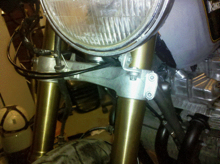

Last night i finally got to spend some QT rerunning wires and making things look pretty. Glad thats over with for the most part. I have been debating what to do with the headlight for awhile now and it came to me while looking for a bolt. I noticed my headlight has a threaded bottom mount. So i used some spare L shaped hangers i had in my bag of tricks and came up with an offset mount. Not sure how i totally feel about a 7" offset light at this time... but for now it will work because it saved me $$$$. Tonight i just need to tighten things up and get the front brakes bleed, and that should be it.(fingers crossed) Hopefully by midweek I will be rolling her out the garage for the first test ride!!!!
I am going to have to come up with an idea for a cover for the right side of the light... It is way to open in the front at this point in time. Tonight I am also going to toss around the idea of mounting a custom light to the headlight for a Neutral indicator. Where the bolts for the old mounts are located.
