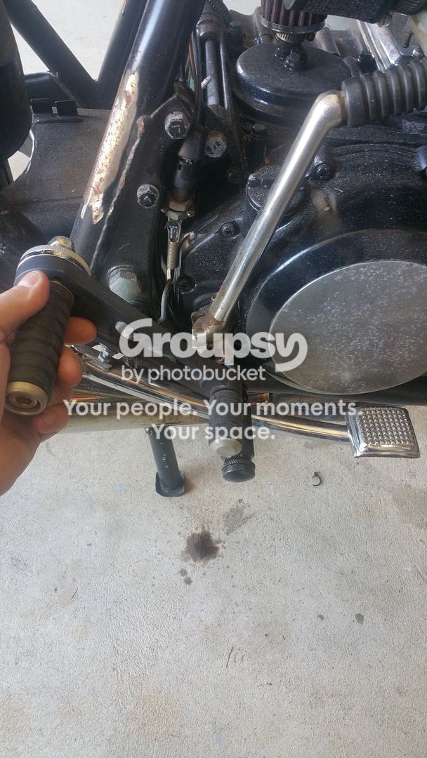

Let's see a pic of how the kicker hits the rearset. In most cases a torch and a vice can fix what ails ya.

bending the kicker might give you enough clearance. Folding foot-pegs on the tarrozis will help but the brake lever is probably in the way too. On my kz1000 it would have required a shitload of bend in the kicker to clear the rear sets, So after seeing some similar examples on the XS forum i came up this solution so the brake pedal can be folded back temporarily to kick the bike. the spring loaded lever keeps the brake lever from accidentally being kicked up.
Wow, that's quite the device you've got there. I think it may be a little out of my fabrication abilities right now (but once i get into my own garage possibly)
Here's the desired position, and obvious kicker interference.
I think i will leave the kicker for now, and revisit it once the bike is ride-able, as i don't have a rear caliper or the other required parts aside from the wheel to do the disc conversion. I do plan on a swinger and fork swap down the road, but that wont happen until after I've found a house and what not.

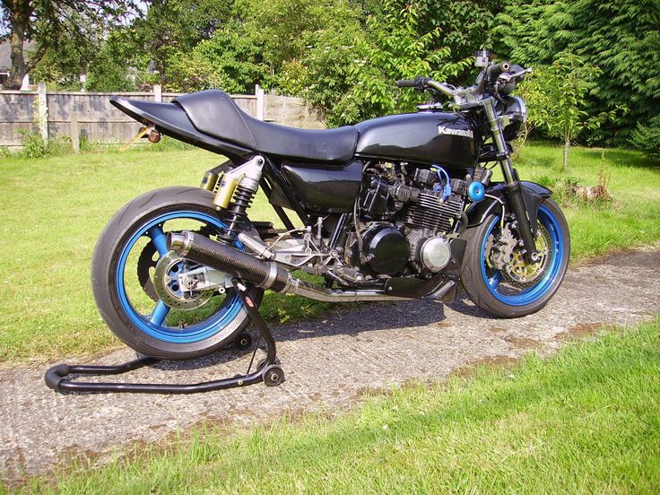

For some bike porn, and the reason i WILL be doing a swinger/ front end swap ( i love the 17 inch wheels)
looks like a GPZ750 with EFI in there. sweet

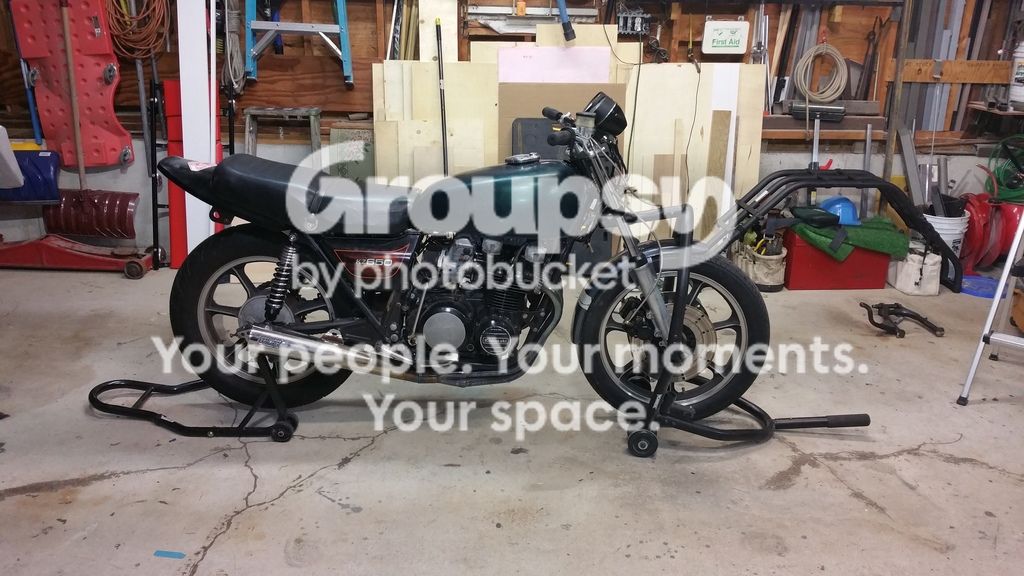

starting to look as it should!

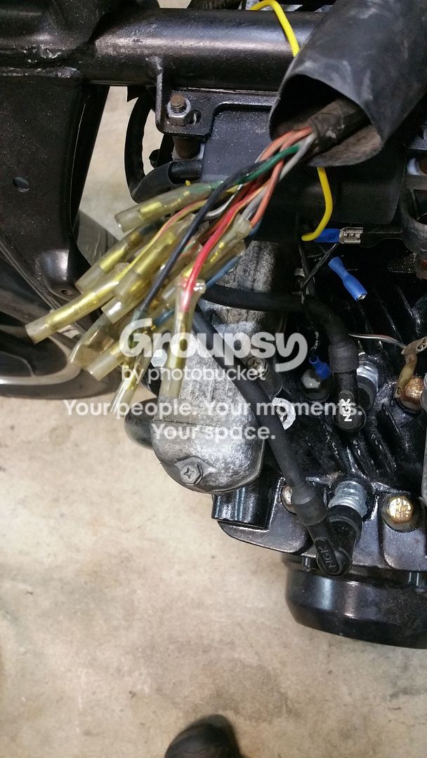

What i couldnt figure out, as its been quite some time since ive seen the stock harness is:
Where this cluster is supposed to go:
and if this lot is supposed to be inside the headlight bucket:

The wires in your first photo go to the handle bars/headlight/gauges. Yeah all that crap has to go in the air box(meant bucket). It looks like that may have been a factory vetter setup with the extra lights. If it's a stock motor I vote for the air box, they look fine on these bikes., I recently picked up another kz650 and I put the air box back on it. So maybe I'm biased
doc_rot said:
The wires in your first photo go to the handle bars/headlight/gauges. Yeah all that crap has to go in the air box. It looks like that may have been a factory better setup with the extra lights. If it's a stock motor I vote for the air box, they look fine on these bikes., I recently picked up another kz650 and I put the air box back on it. So maybe I'm biased
Yeah the harness is from a CSR model, but from what i can tell, the basic harness is the same. They've all got the same necessary functions as far as flashers/ headlight/coils/charging. Looks like i ought to start searching for an air box then. Thanks for the help!

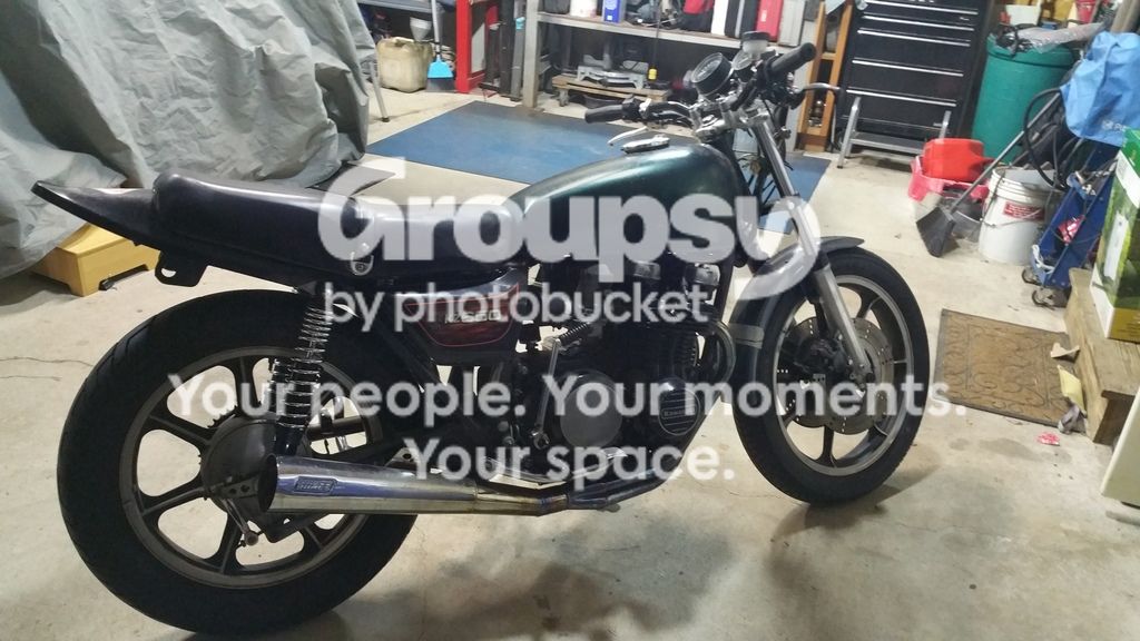

Not much visual progress, but im pretty happy with how its coming along. It probably wont get to paint until after ive found a house, but it should be road worthy pretty soon.

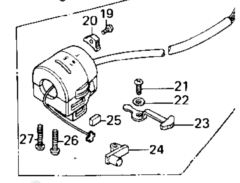

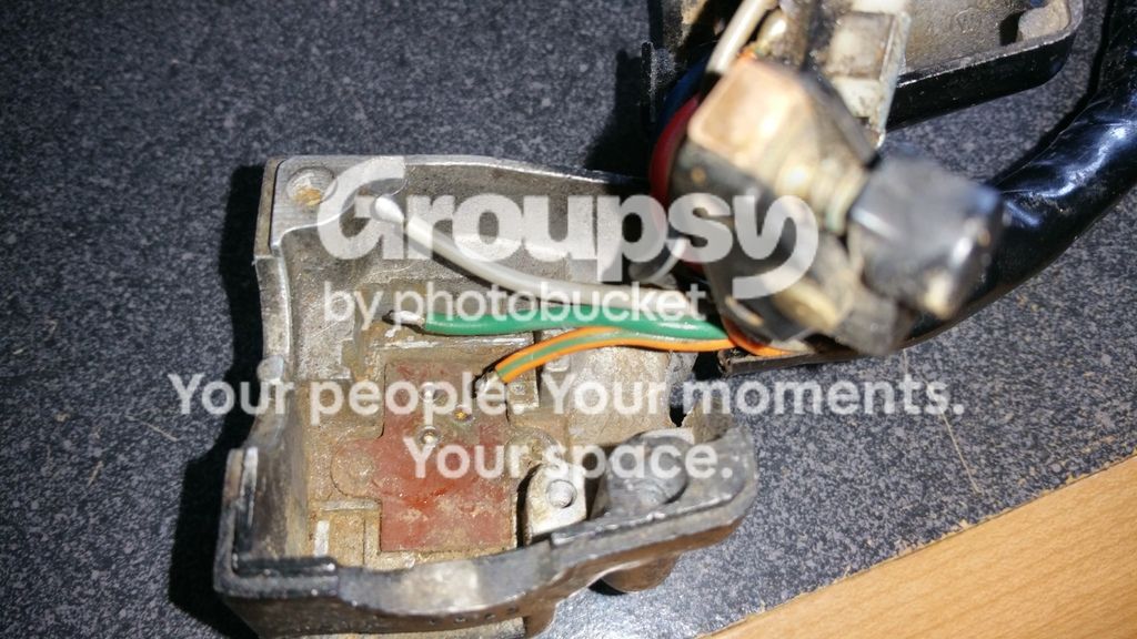

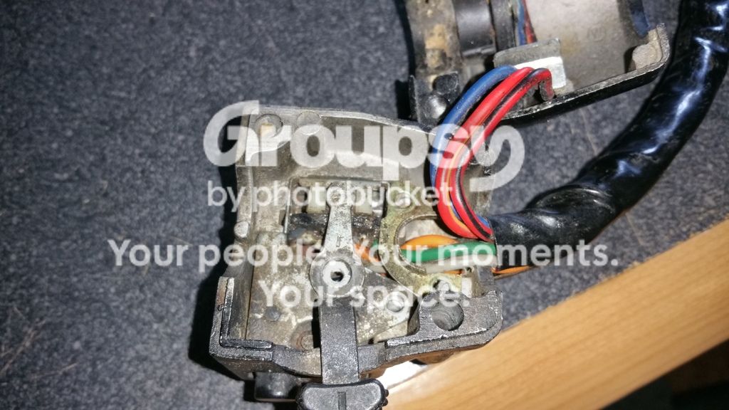

I recieved a left hand switch assembly, but there are 3 wires that have become detached from what i believe are the hazard light connections. Could somebody maybe take a picture of their switches, or tell me where they are supposed to be connected?
Also, it is missing some hardware for the turn signal selector, is there some sort of bushing that is supposed to go between the screw and the lever here?
Obviously it all needs to be cleaned, but id like to figure out what i am missing. any help is appreciated!
those wires are for the turn signal switch. the hazard button uses them too. There is supposed to be a washer and a 3x5 pan head screw.
