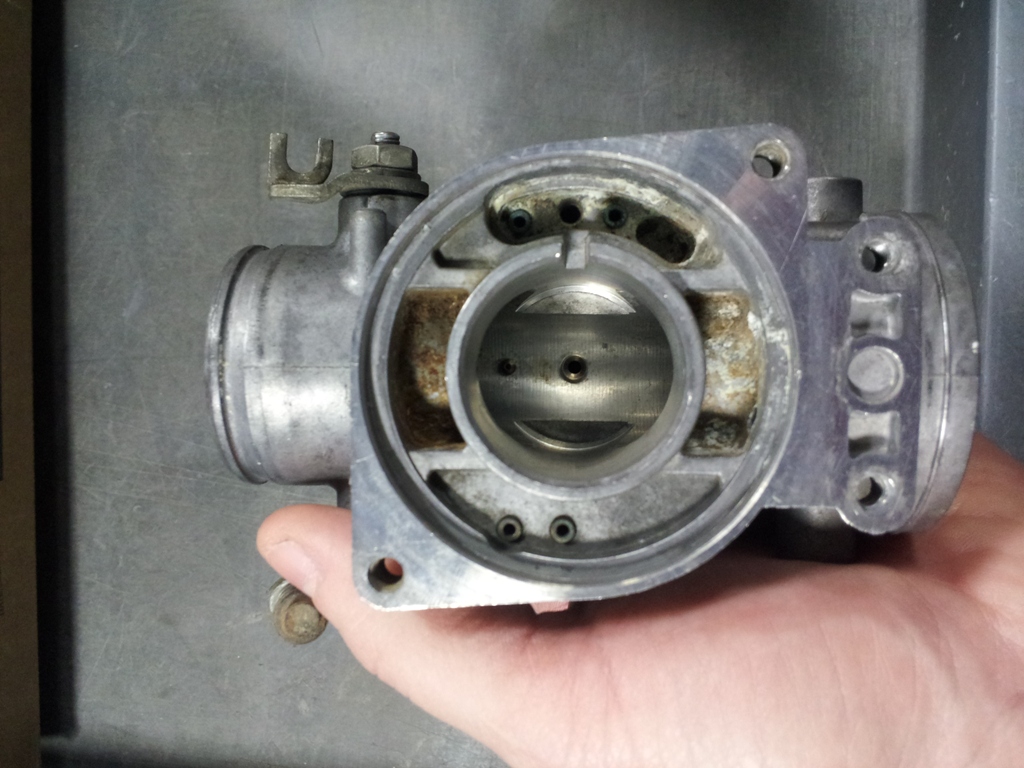

Carbs have a date with an industrial ultrasonic cleaner today! im stoked to see how nice they come out.
Lookin good Layn, you picked up some good deals, the thriftyness i was talkin about! Ill be polishing some parts soon, yours came out great!
Carbs are done with their bath in the ultrasonics... heres a before shot... I wish I took more :-\

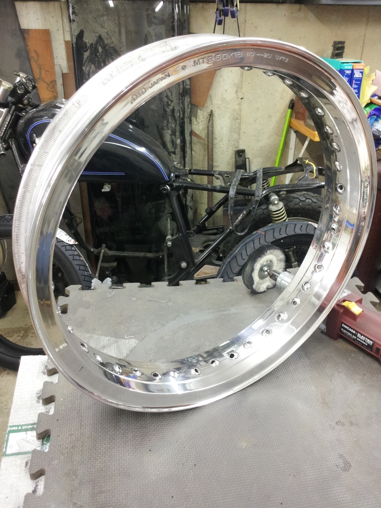

this is what it looks like after buffing with brown, grey, and white polising coumpounds... pretty nice... but not quite finished.

Anyone have a good method for removing the black build up around the dimples without harming the finish? Im thinking a liquid polish and q tip?

As for the polishing residue, I was able to get it off pretty easily with a polyester swab and rubbing alcohol... the alcohol was strong enogh to take off the polish but doesnt hurt the aluminum... seems obvious now.
