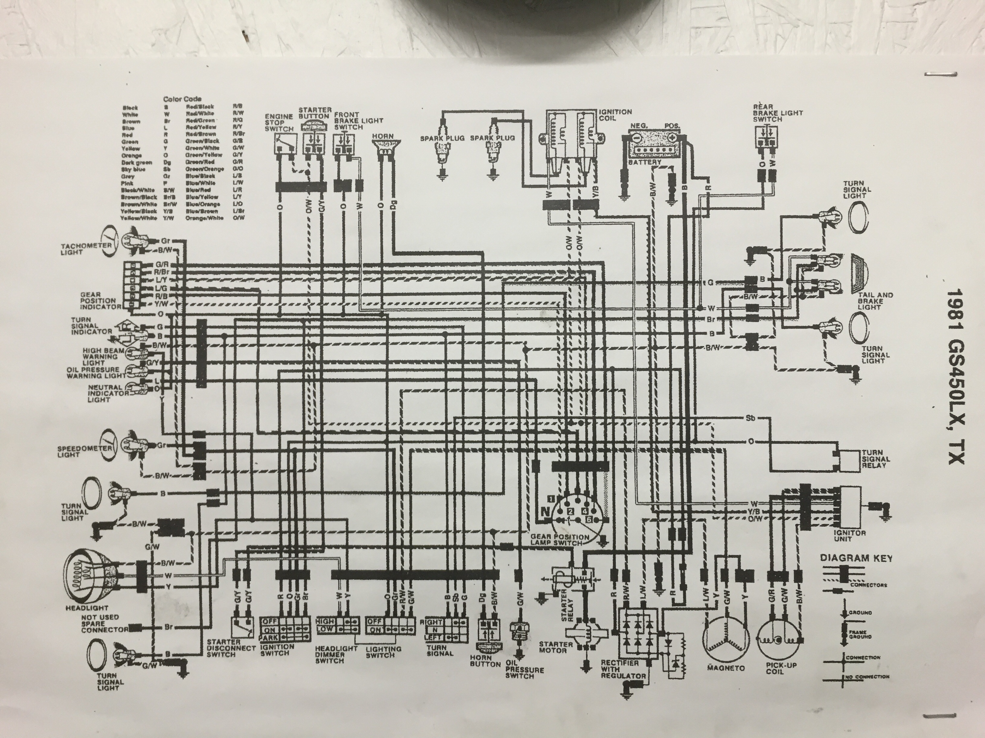

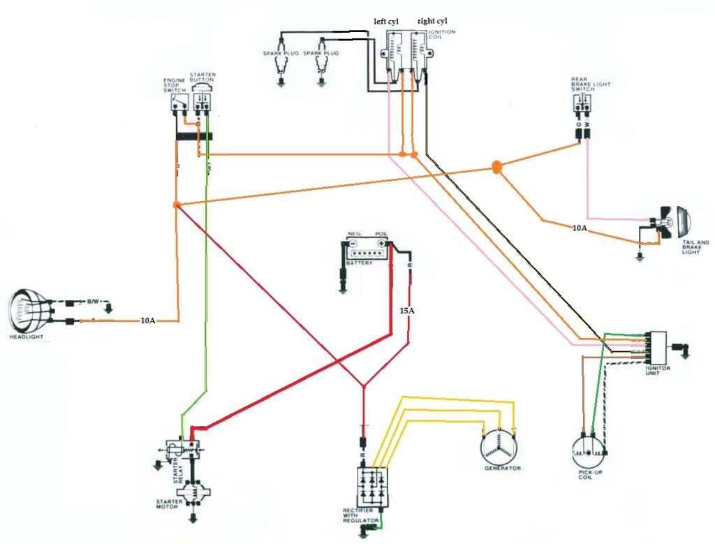

Original wire diagram for the 1981 GS450 vs. a simple diagram i used a basic guide.

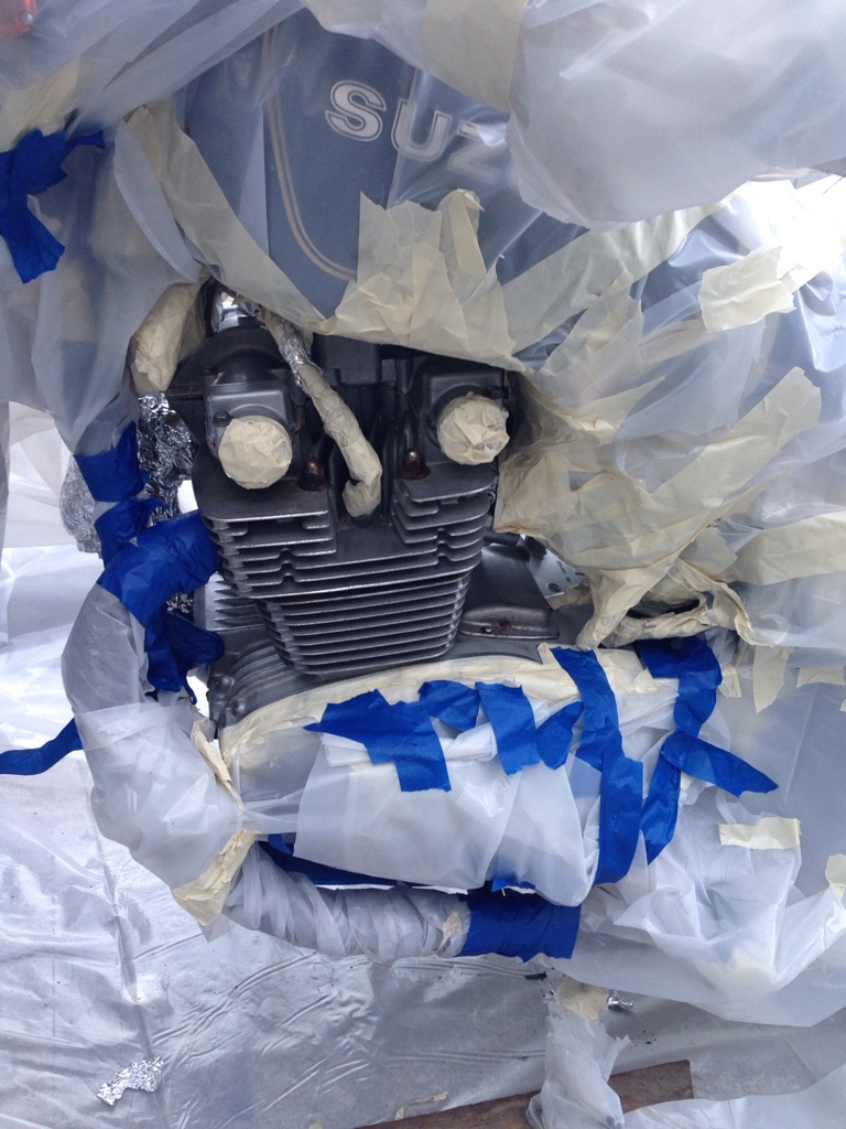

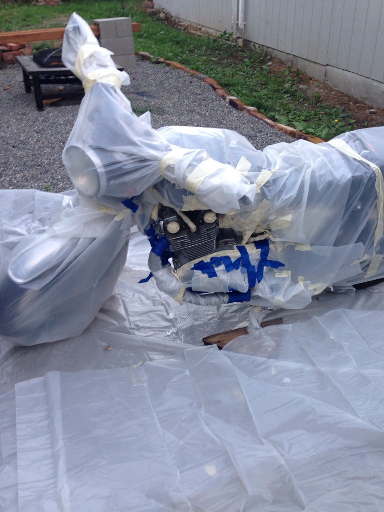

Masked
and primed
Basically I am going against every purist ideal, no spray booth, engine on bike, didn't sandblast the engine first (just a 3 hour cleaning), but without any of the tools necessary pull the engine and find a place to make a spray booth....

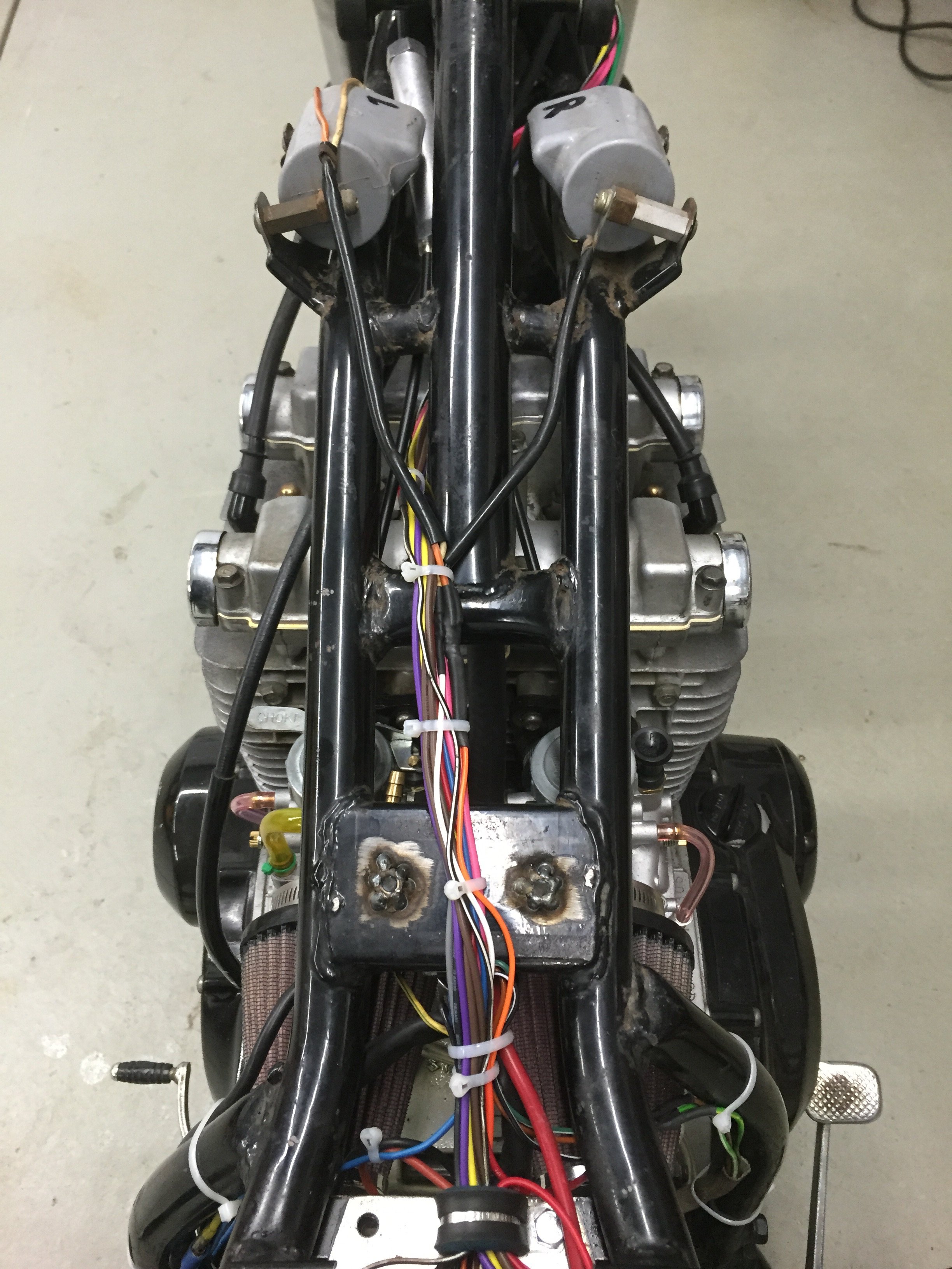

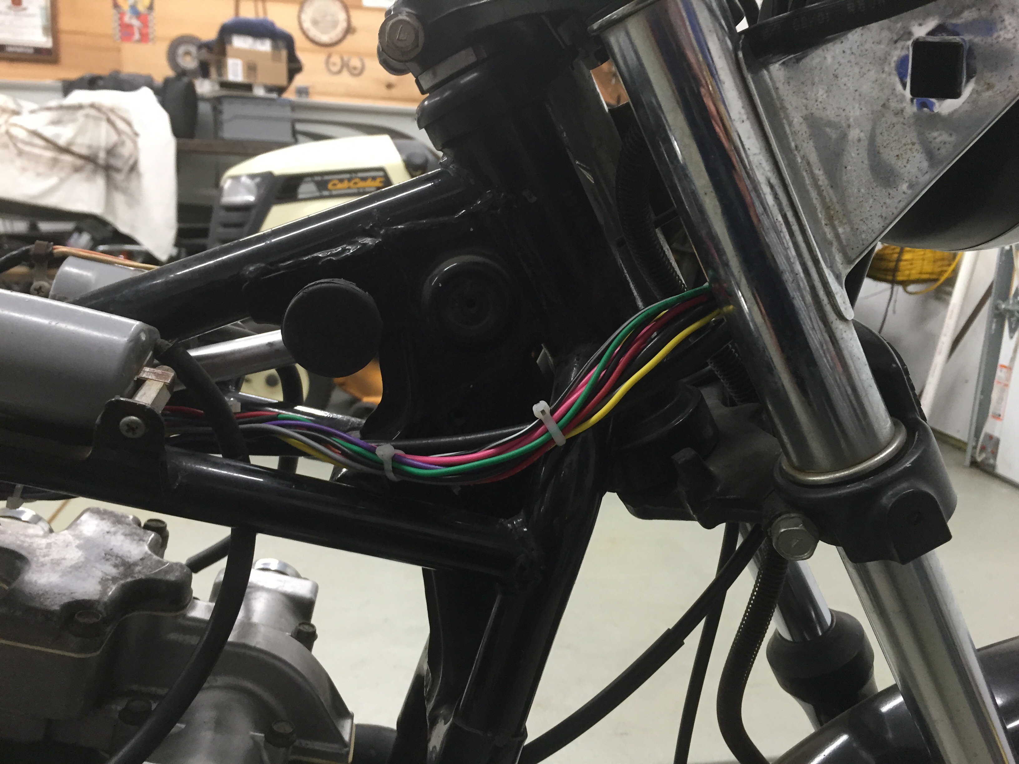

thanks bro, I am going to need to run more wires since I want turn signals and indicators. That's a project to tackle in the winter. Electric is not my strong point.

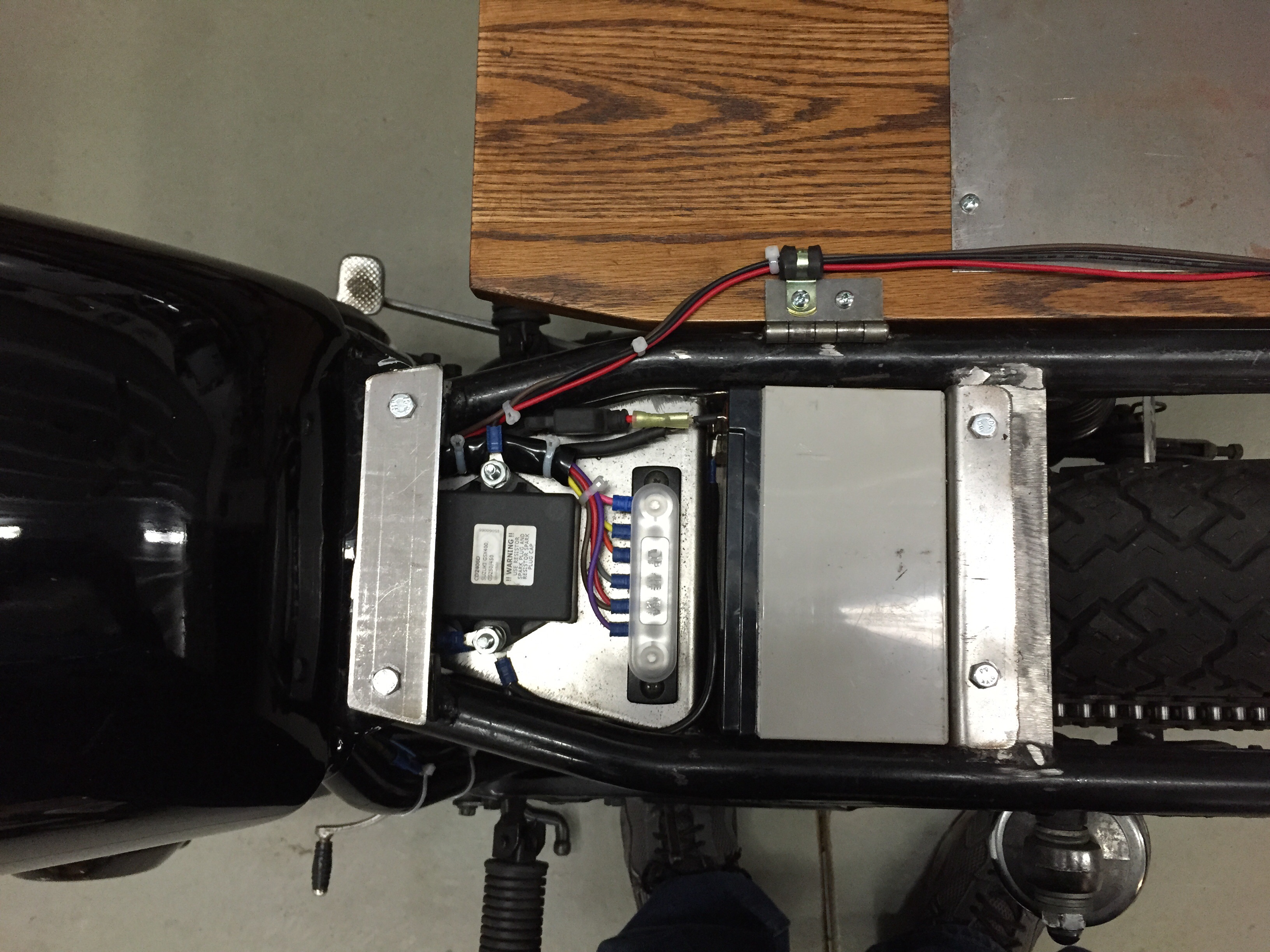

I can't tell but did you relocate your if ignition? I want to but the wires seem to short to put them in the front right under the gas tank
I used the original switch. But replaced 98% of the wiring. The switch powers up the bus bar under the seat. Everything gets power from the bus bar, lights, ignition, blinkers, starter relay, ect. The one thing to remember is the regulator has to be tied into the positve wire between the battery and the switch and after the fuse. If you put it to the bus you wont be able to stop the engine once its running. Its a magneto. I found my bus bar and wiring on amazon. Like Dohc said any indicator lights like nuetral, oil press warning, ect are grounding switches. Light gets the power and the sending unit is the path to ground. You can tie all your backlight for the gauges and the indicators to the same power wire if you want. What i did was pulled the whole harness off the bike and laid it on a table, took the wire diagram and studied it. Its actually kind of fun but than sad to see how goofy Suzuki made the wiring. It is so easy to simplify this bikes wiring. If a guy wanted to take a little extra time you could give each system its own fuse, like a car, so incase something did short out it wouldnt blow the fuse for the whole bike. I plan on carrying a screw driver and extra fuses. Worst case i disconnect each wire from the bus bar, put in new fuse and reconnect one wire at a time to see which system is shorted. You couldnt do that with the factory harness. Wiring this bike took one day. Its easy.
The reason i used "White" tywraps is because they are free for one and the kind with metal tabs, but mostly because its temporary. I plan on taking the whole bike apart son to get the frame re powdercoated and detail the engine and stuff. Im still tweaking a few things here and there now. When im done i want the bike to be as functional as my Hondas Shadow which means i can feel like i could jump on and ride anywhere without worries and i want it to look nice. I would like to get new handle bar switches and gips so i take away the 30 yr old bike look. I plan on finishing this bike. For a while i wasnt sure with the engine issues i had but now that is cured. It should be a nice bike. Well at least to me. Maybe not everyone.

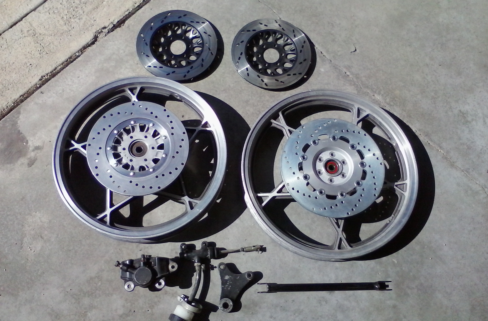

I have a disc brake rear wheel with the entire brake setup here that would be a very nice upgrade for someone with a drum rear GS. The rear master and caliper are available. There are minor grooves in the existing rear rotor. It has been drilled to match the pattern of a semi-floating EBC front rotor. The brand new never used front rotor and 19" wheel are also for sale. Also pictured for sale are a pair of small diameter slotted gs front rotors. Just thought i would throw that out there for you and any other GS guys watching this thread. I am willing to sell all or any individual part of the set.
The wheel is 18" and has some dings from tire removal but is overall in great shape. Bike had 25k miles.
The bike looks really good. PM me for a sketchy solution to the dent in that tank. Those pipes are killing me.

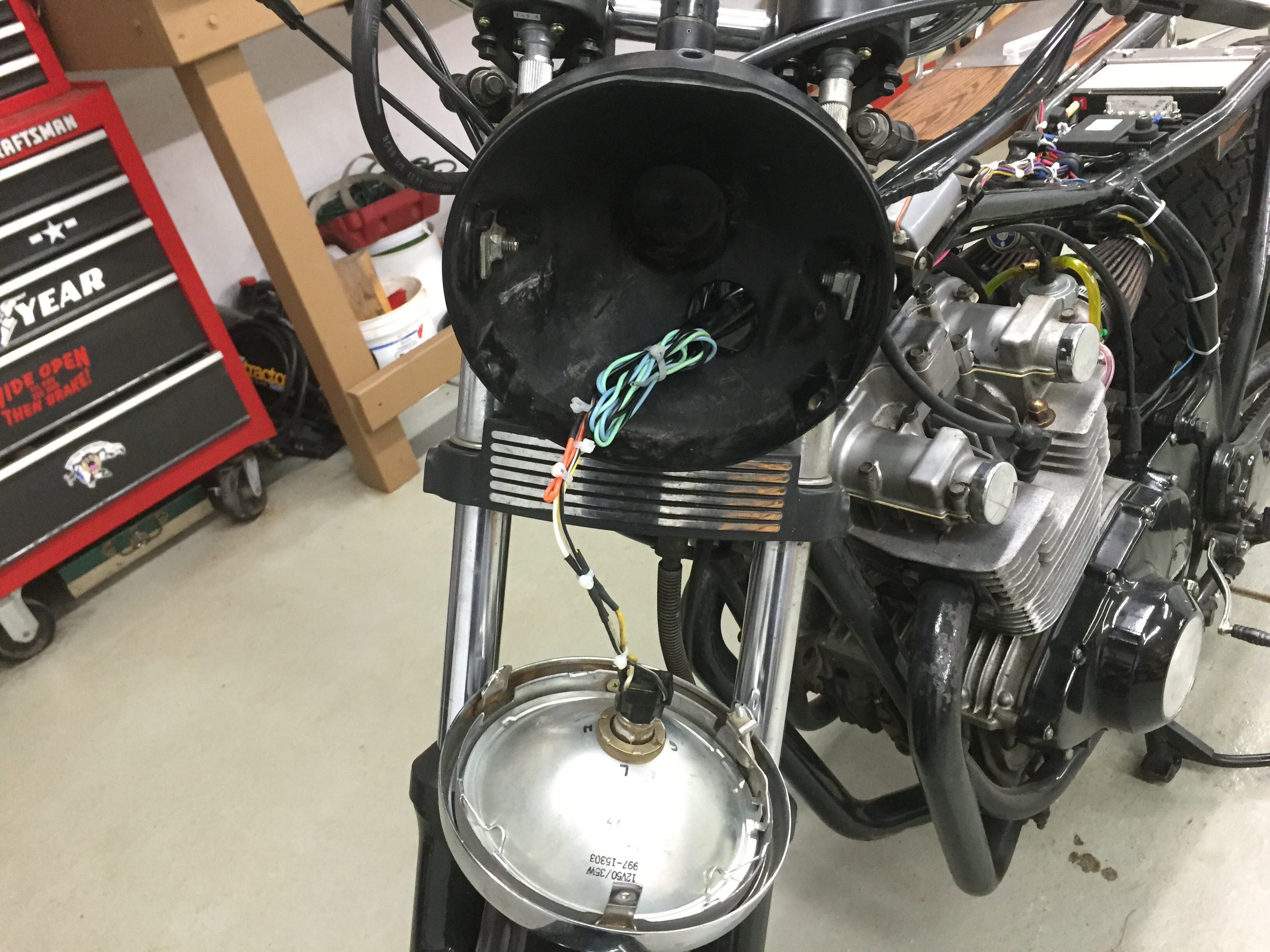

Idiot lights replaced with small .3" Diameter from Drag Specialties
Didn't know there was that Center mounting bracket piece from the old idiot cluster was a perfect place to mount the lights until I have a custom bracket fabricated, it's hard for me with the electric I don't have any of the proper tools other than a wire cutter and electrical tape.
I think it came out pretty decent just got back from a ride they work perfect. And the bike looks pretty good also haven't filed down the fins and I need to re-polish the side covers to a mirror finish but overall I'm very very satisfied my weekend
