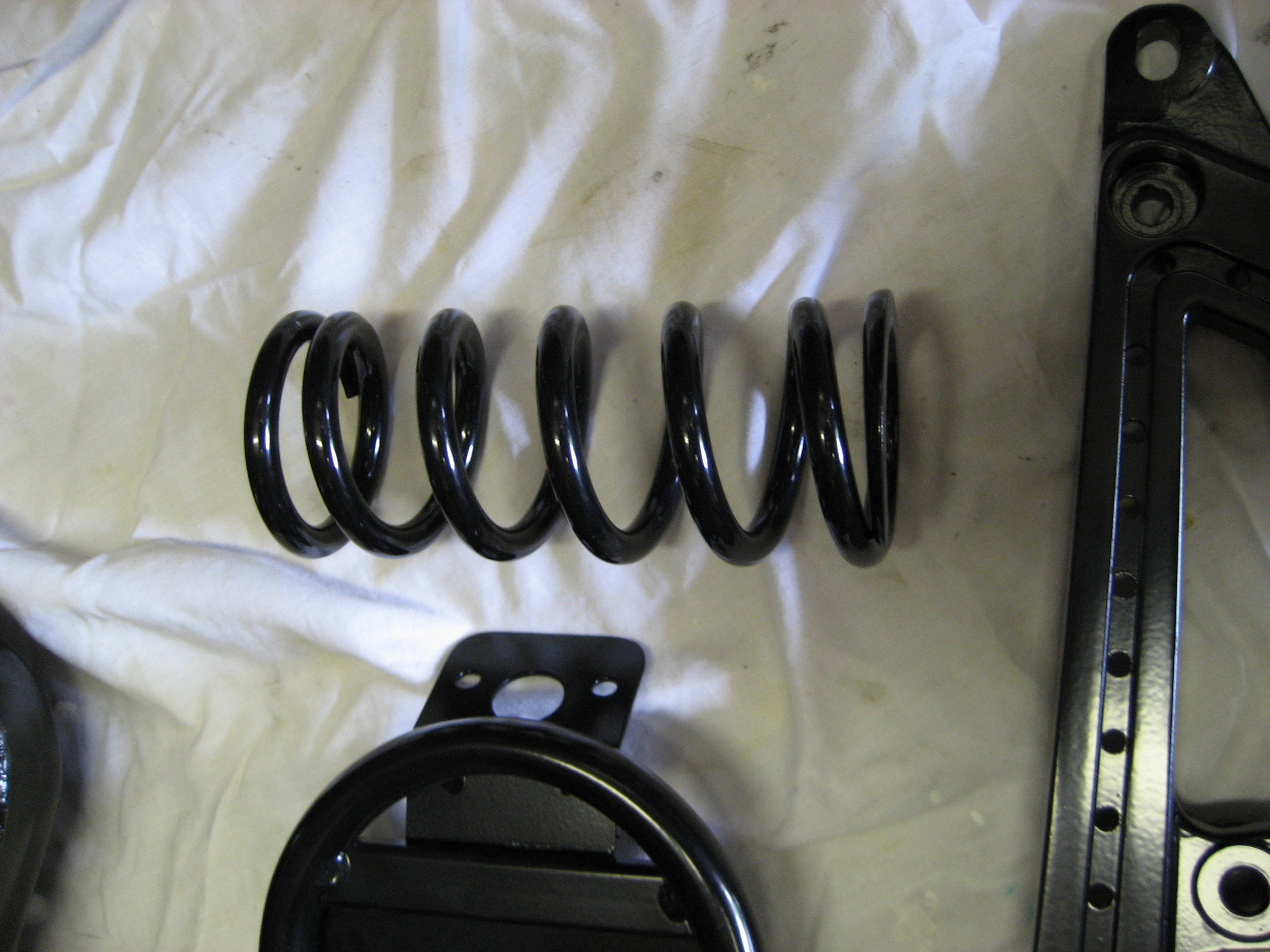

Managed to get some smallish jobs done over the summer, and made a start painting, powder coating and cleaning up stuff.

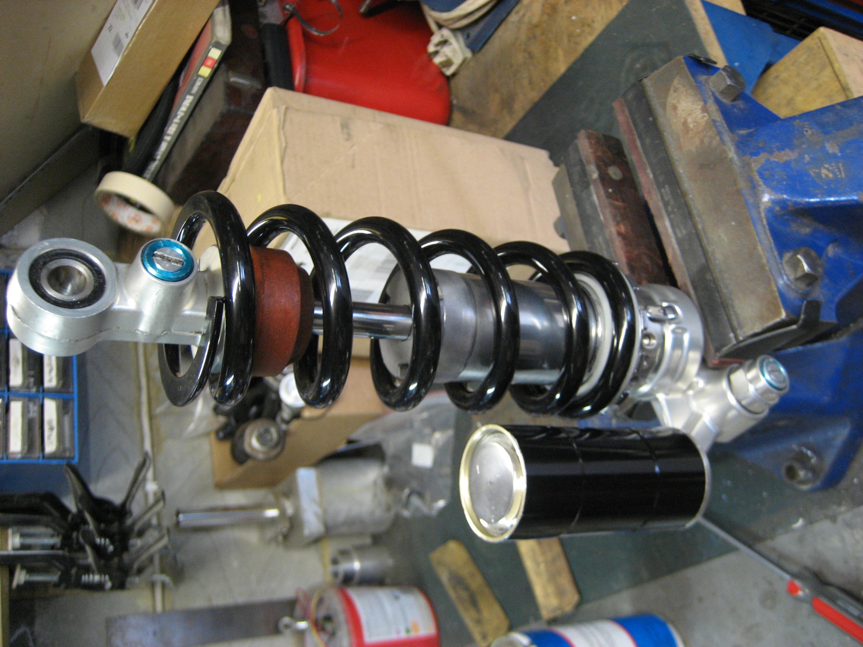

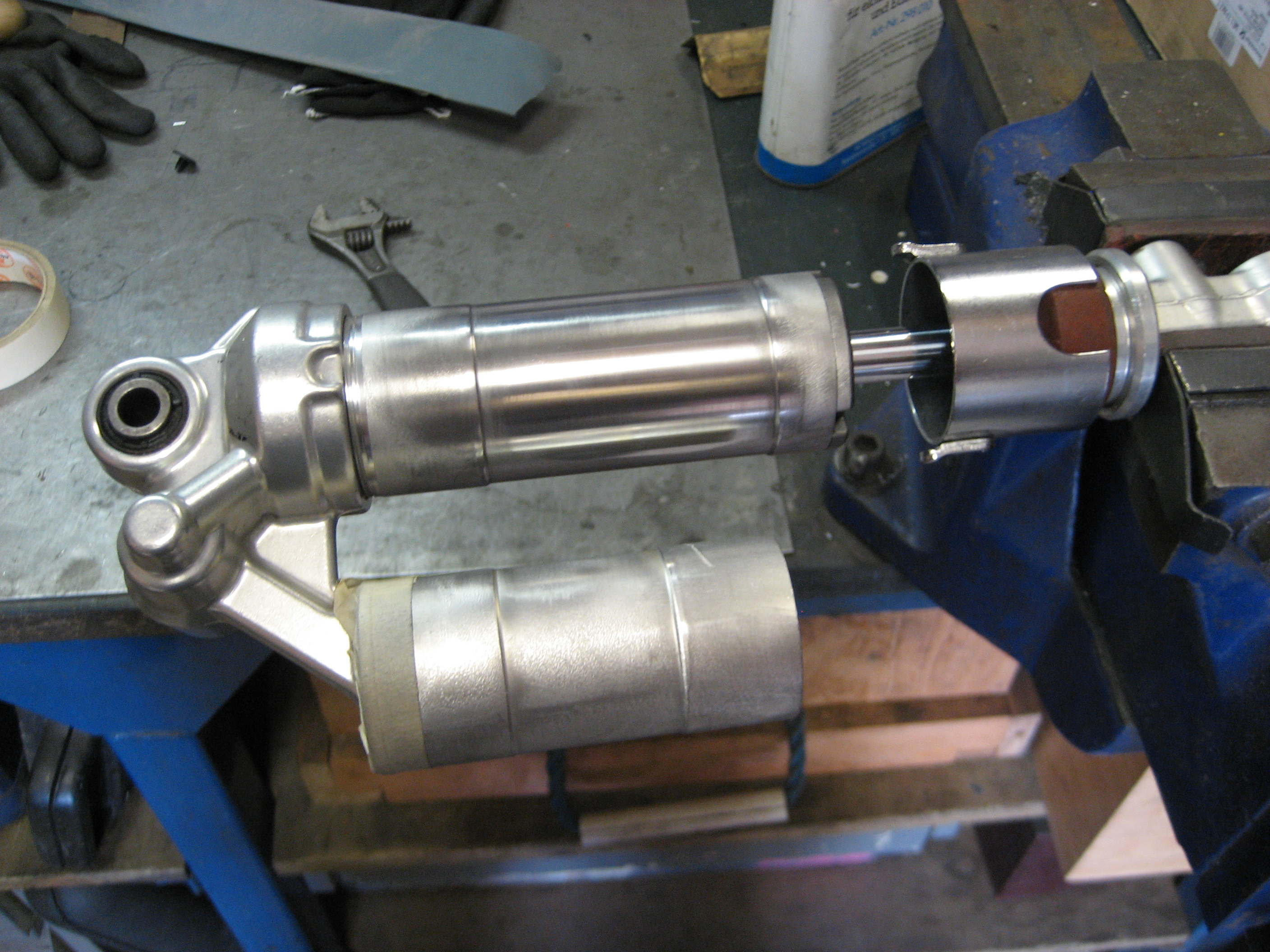

On with the pics...First up was the shock for a makeover...

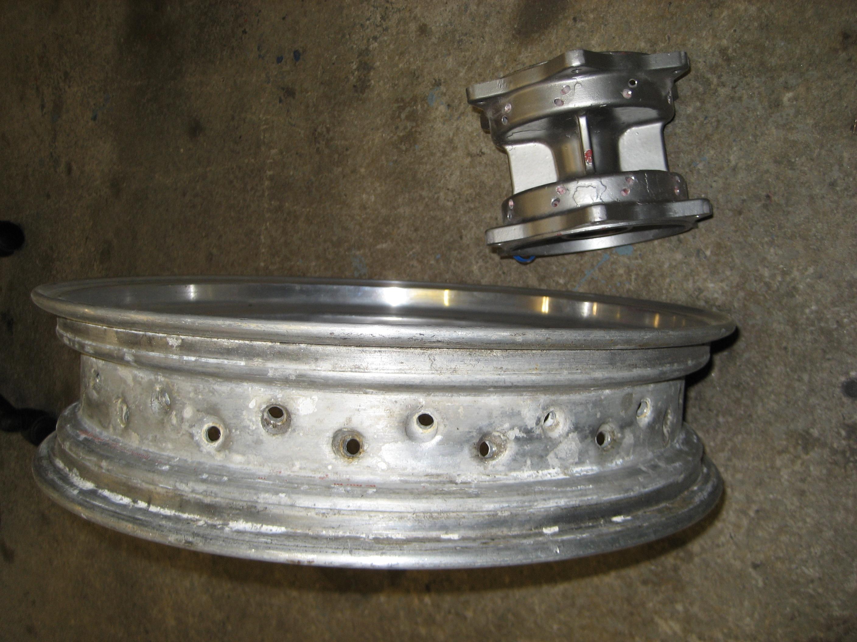

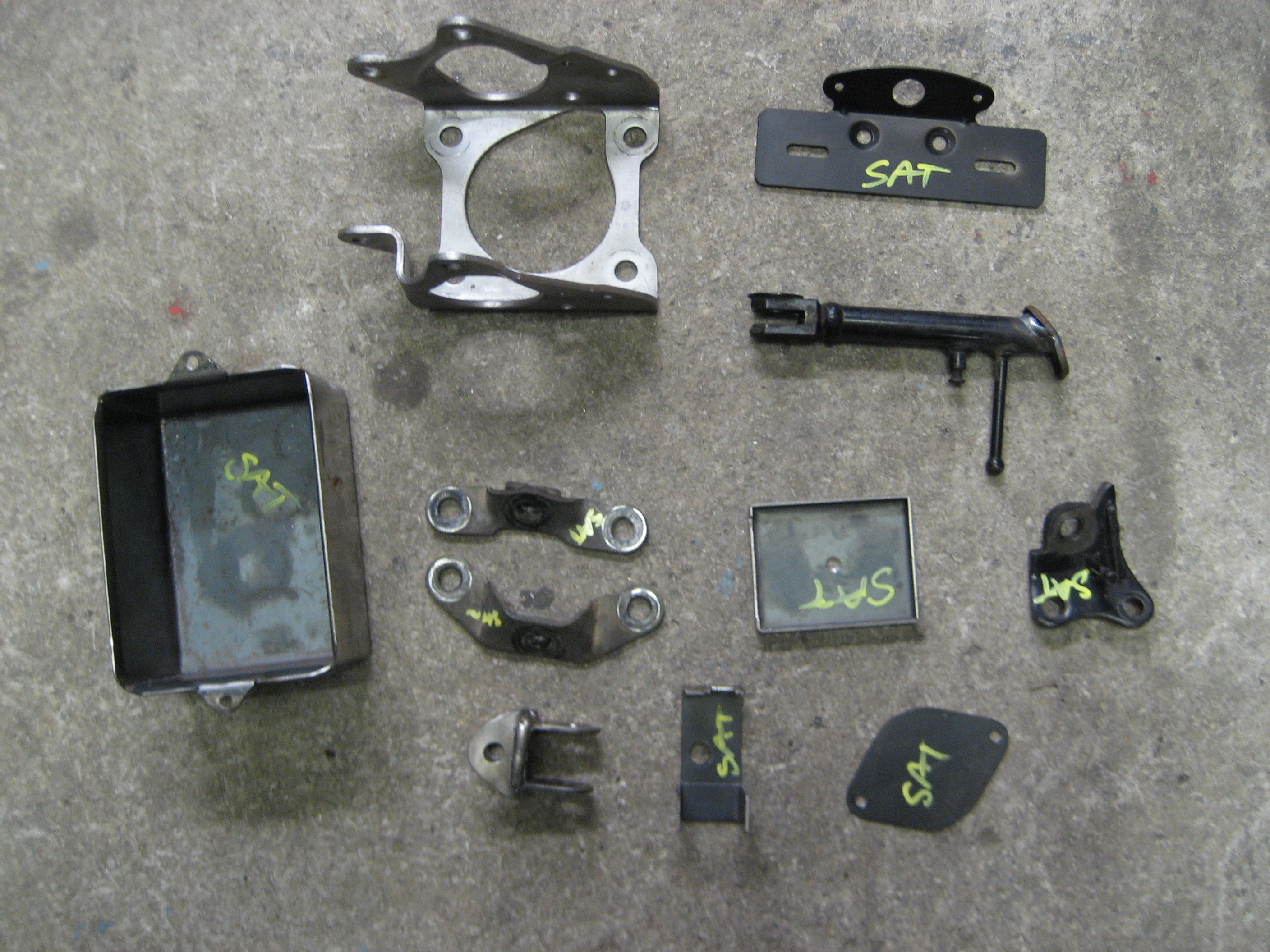

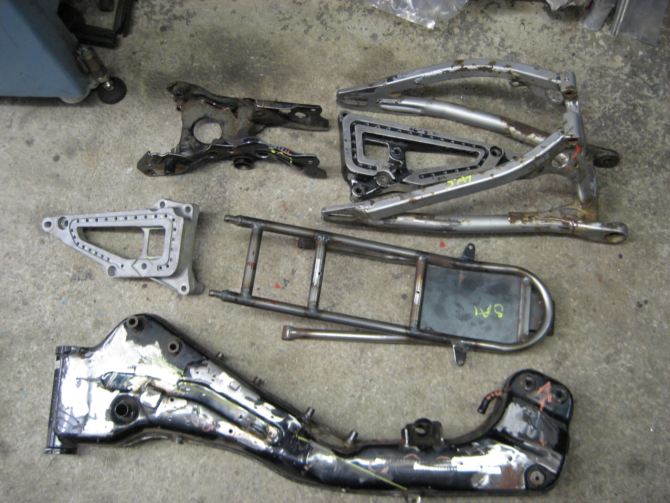

Made a start stripping down wheels, frame, brackets etc ready for powdercoating.
Overall was happy with the results, but the coater had a problem with the wheel rims. They were pretty poorly pitted, and needed doing twice. I was still not happy with them so have decided to flat them back, fill in the pitting with some polyester filler, prime and wet paint them myself.....

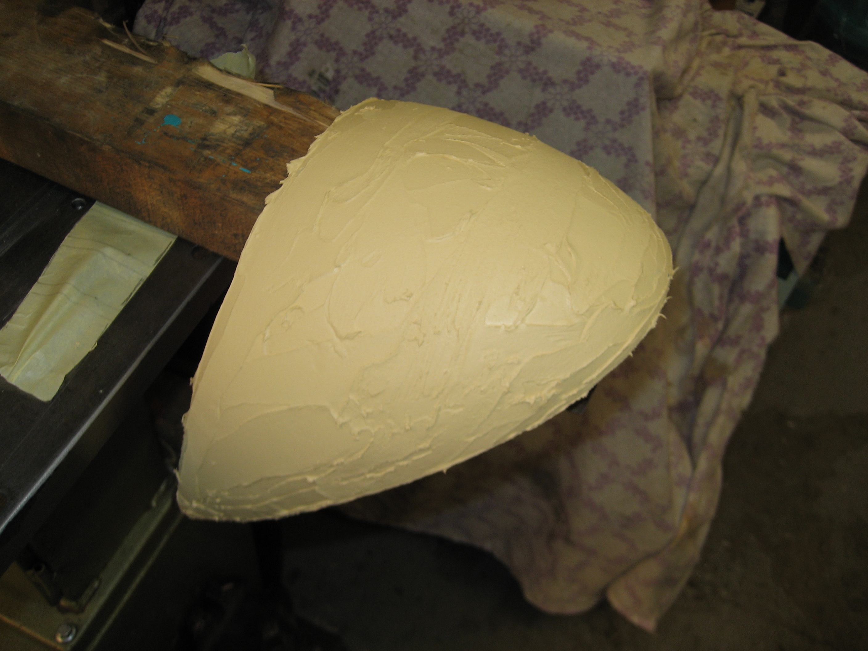

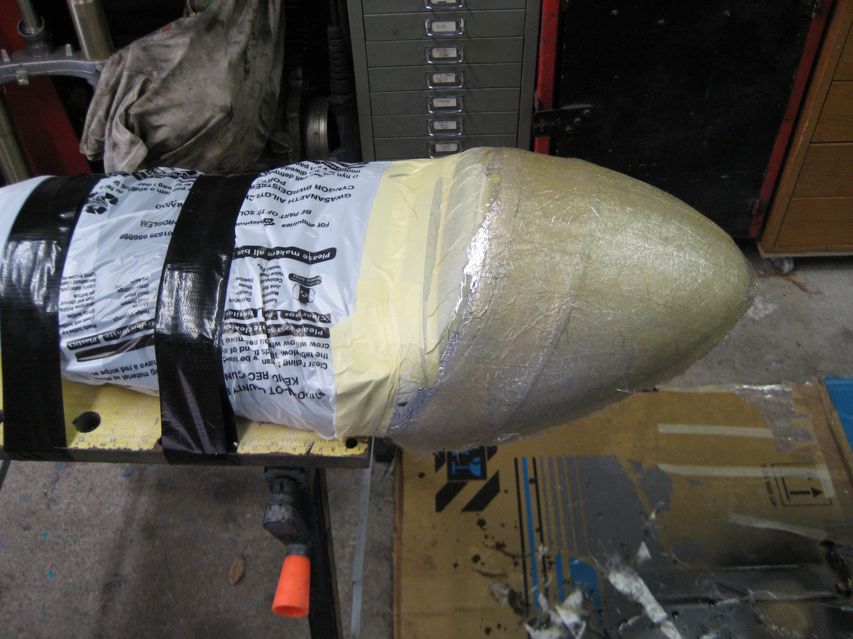

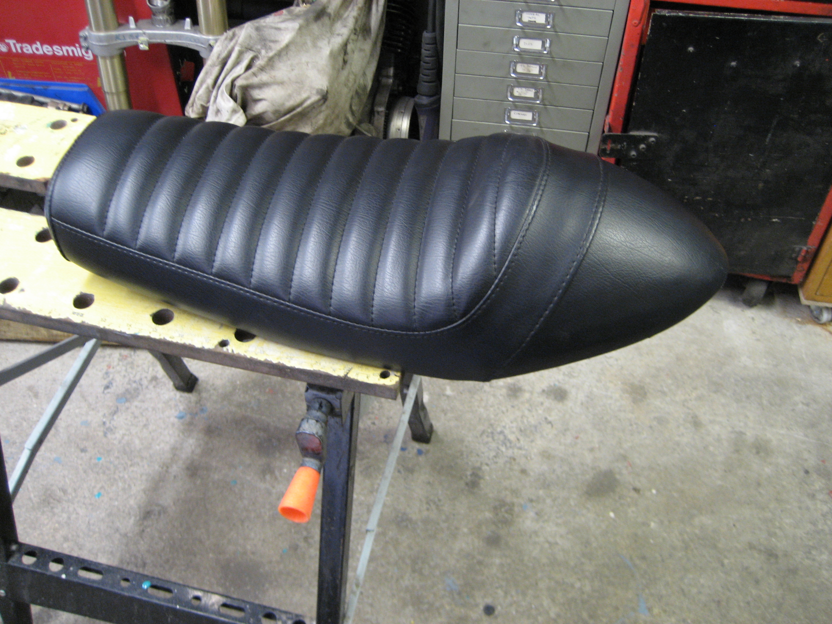

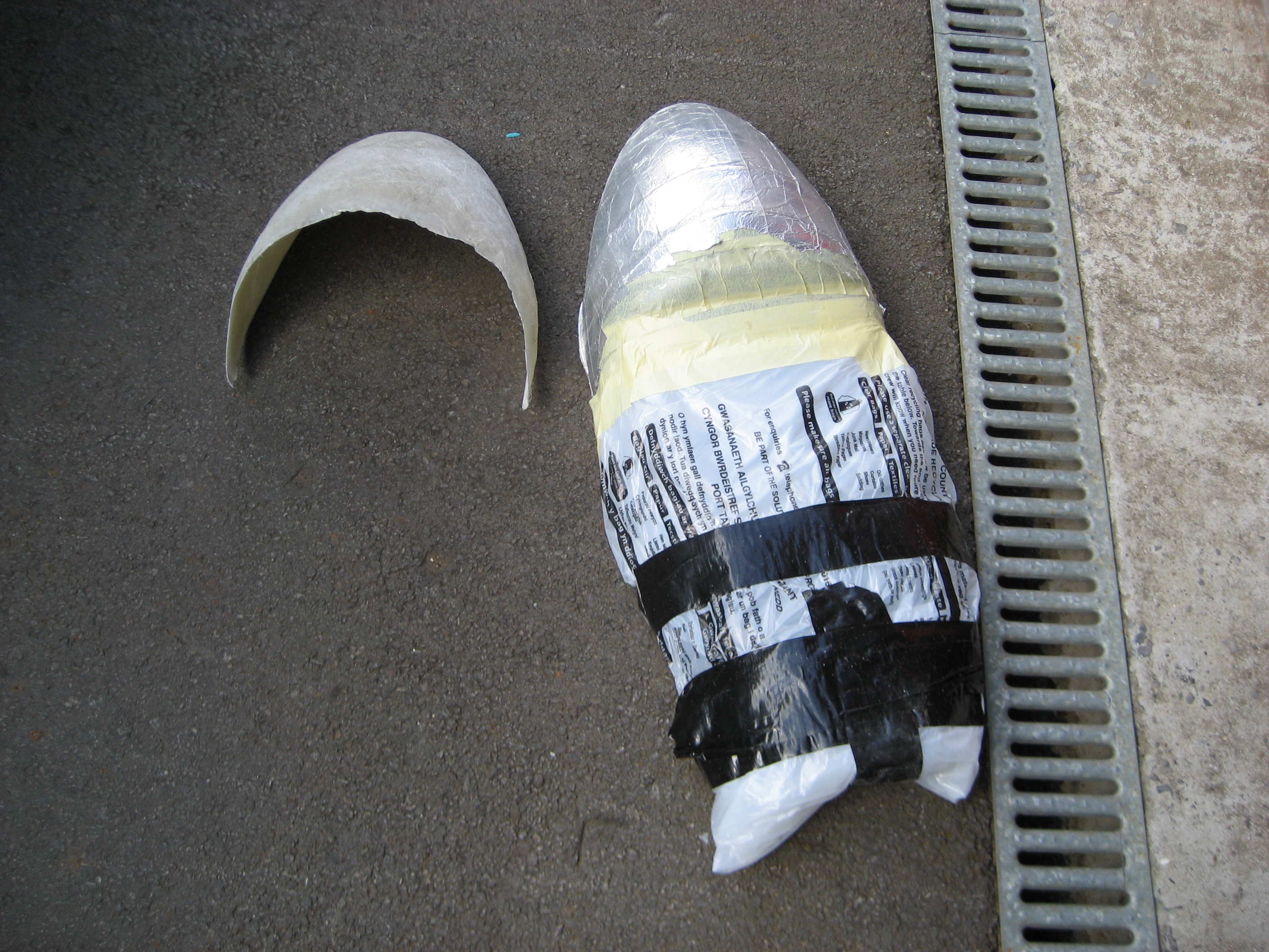

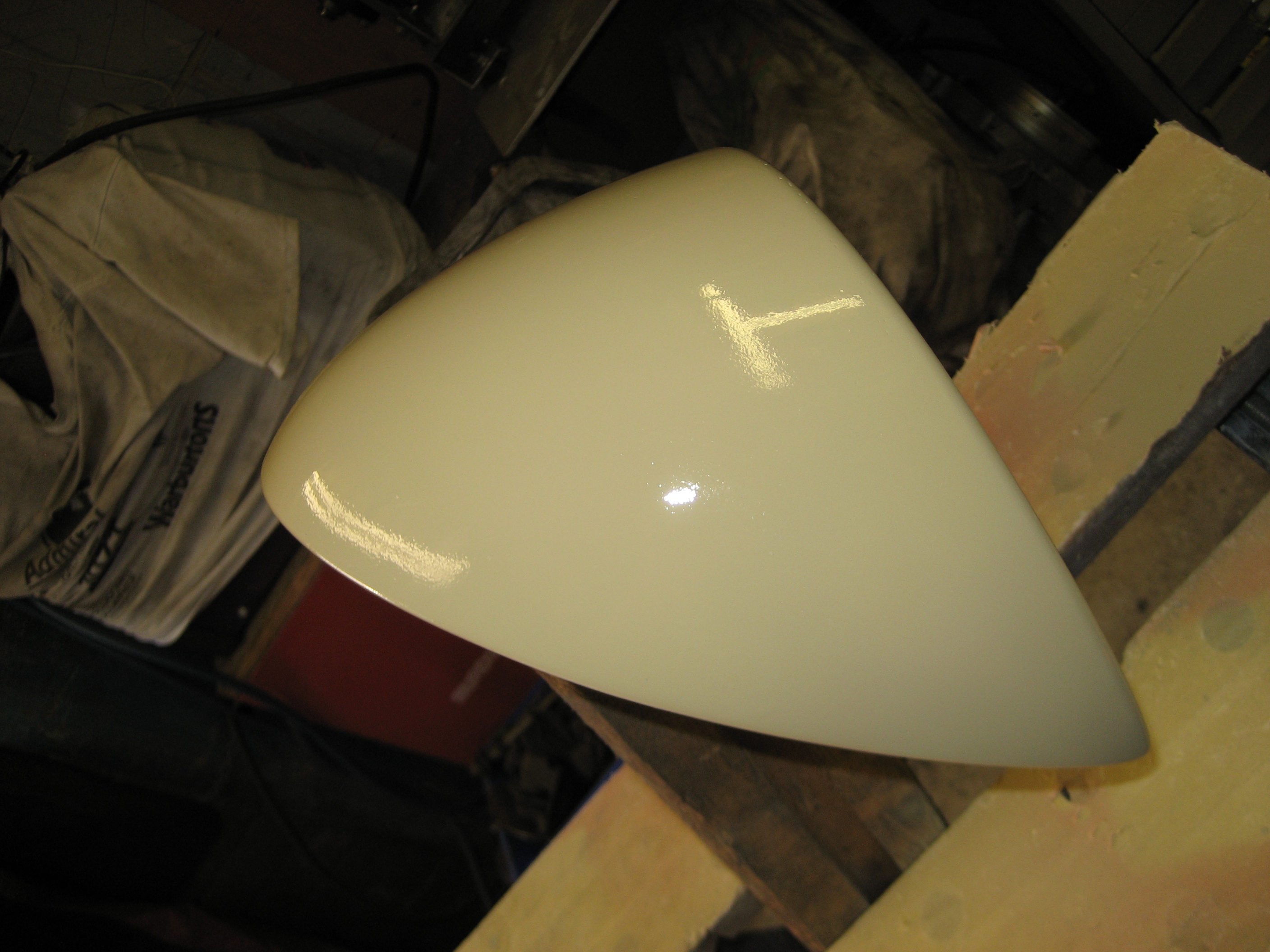

Was never 100% happy with the seat "look" as its got a bit of a "Bobber" look about it, so decided to make a seat cowl from fiberglass. This will be painted the same colour as the tank and should give it more of the cafe look I'm after.........

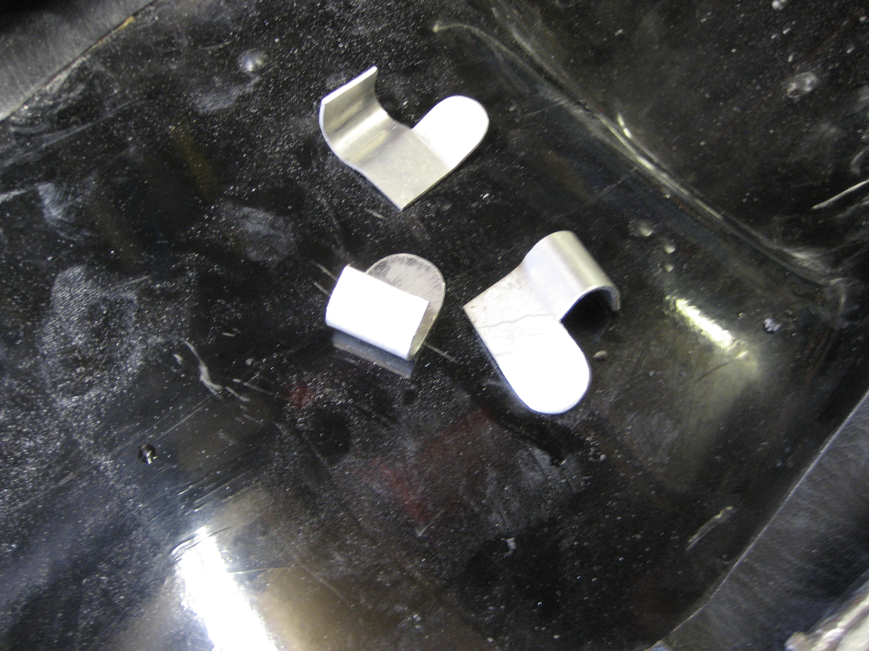

knocked up a few brackets to hold it in place when its fitted, then glassed them in place. Ready for its first rub down after filling....

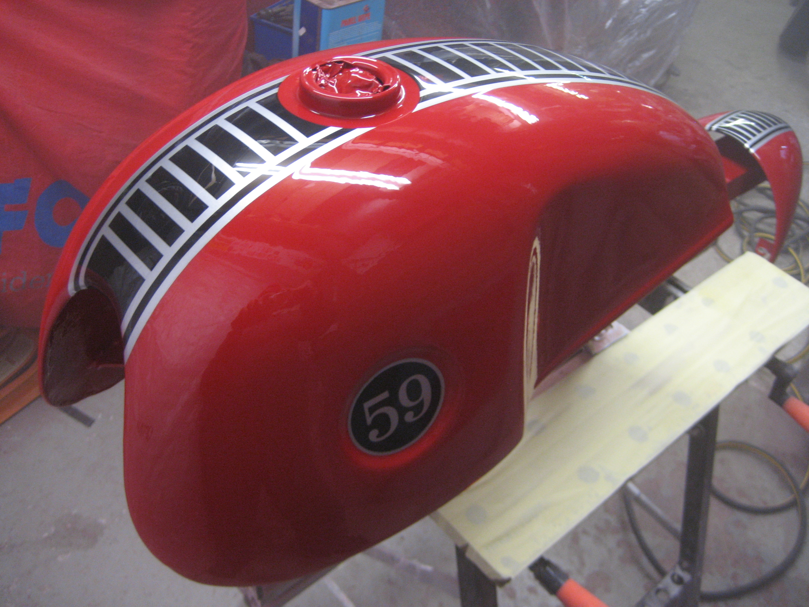

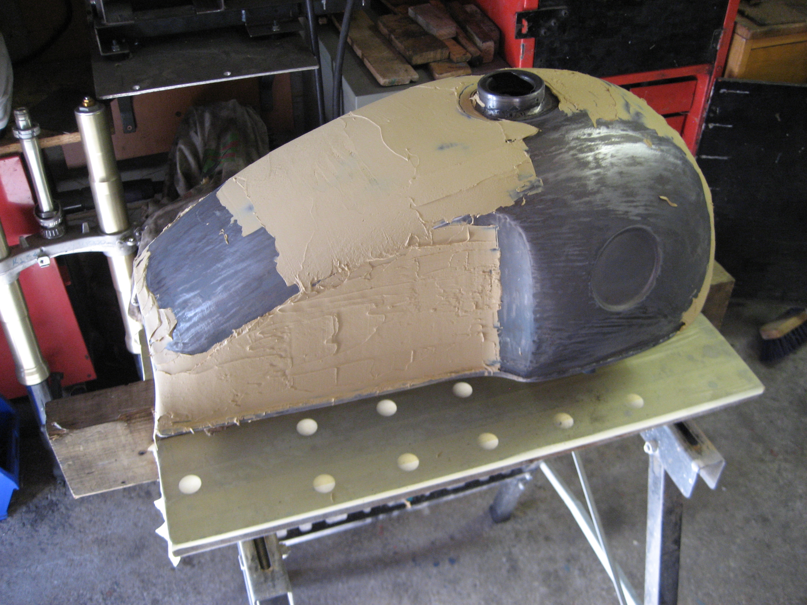

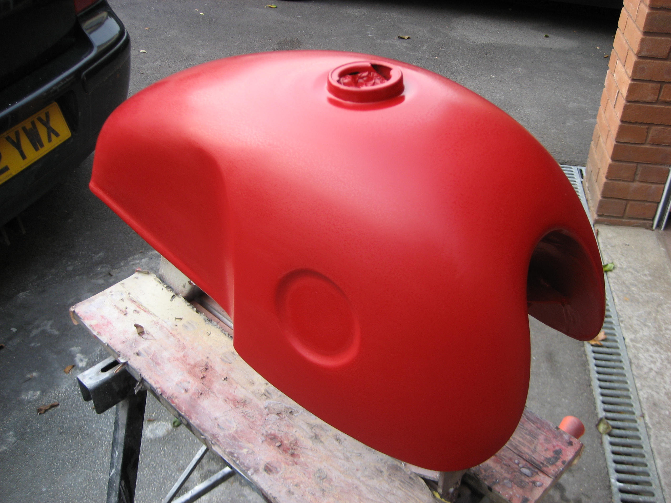

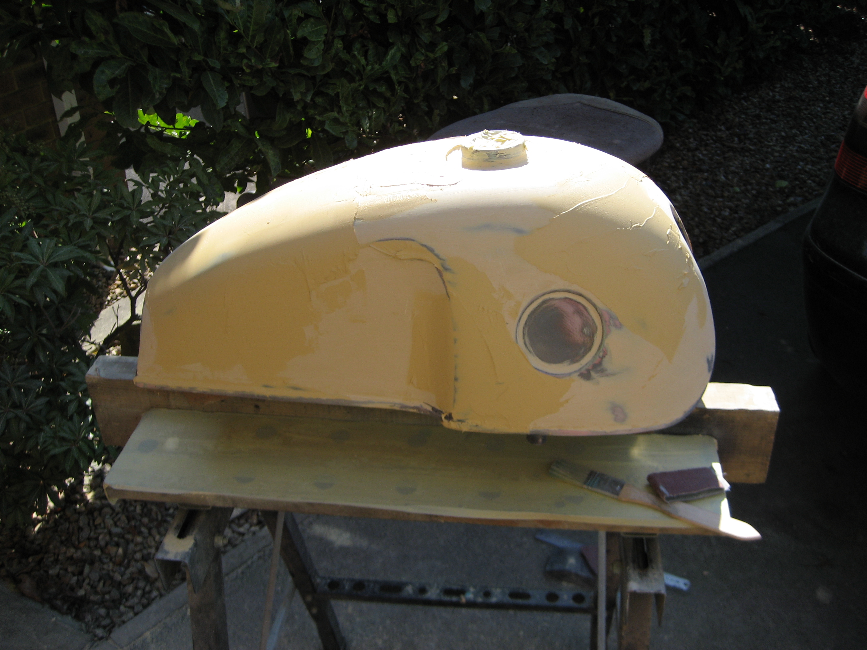

Next onto the tank.............This had been dropped several times during the fabrication work so was looking in a sorry state. Its been the single most time consuming part of the build, and its still not painted !!!! filing, sanding, filling, sanding, repeat............
Also messed around with the Yamaha speed-block pattern I'm planning on using for the paint job. Plan is to paint it myself, something I've never done from scratch. Just used normal rattle cans for the odd repair job over the years, but I've got the gun and paint ready to give it a go....

What a transformation, from "Trailer Trash Meth Head" to "Lean N Mean, Ultimate Fighter".
The Exaust, has the best thought out rear cylinder exit routing I've seen yet, I was hoping something similar was possible for when/if I get an XV.
Do make sure the tank's paint can withstand gas/petrol, I rattle can painted a tank black and white in a similar design to what you are planning, a hard stop caused some gas to escape from the cap and it stained the white paint. :'(
You just need some 2 compound clear coat. that way the gas can't solve your paint. or let a painter do it, they always use 2 coumpound lacquer.
Cheers guys. Got hold of some non isocyanate 2-pack paint and clear ready to shoot it when the time comes. Lots more bondo to go yet

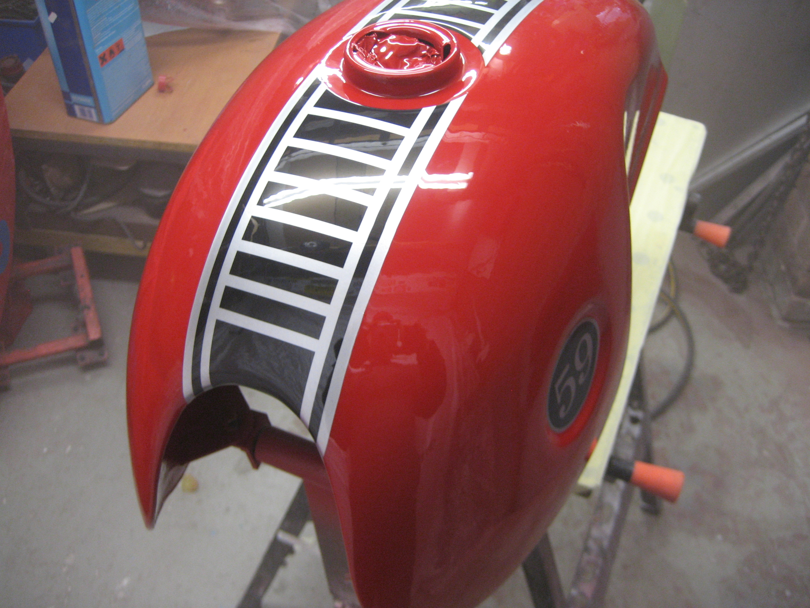

Finally the end of the tank......................well nearly ;D
Just a bit of flatting and compounding to finish off when the clear coat hardens. Its been a steep learning curve for my first gun paint job. Overall it worked out pretty good for an amateur....

+1 with jungalist paintwork is outstanding not just finish but colour combo sweeeet 8) 8) 8)
