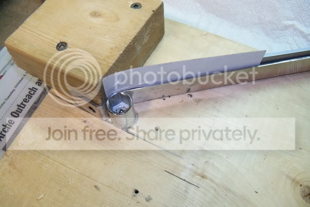

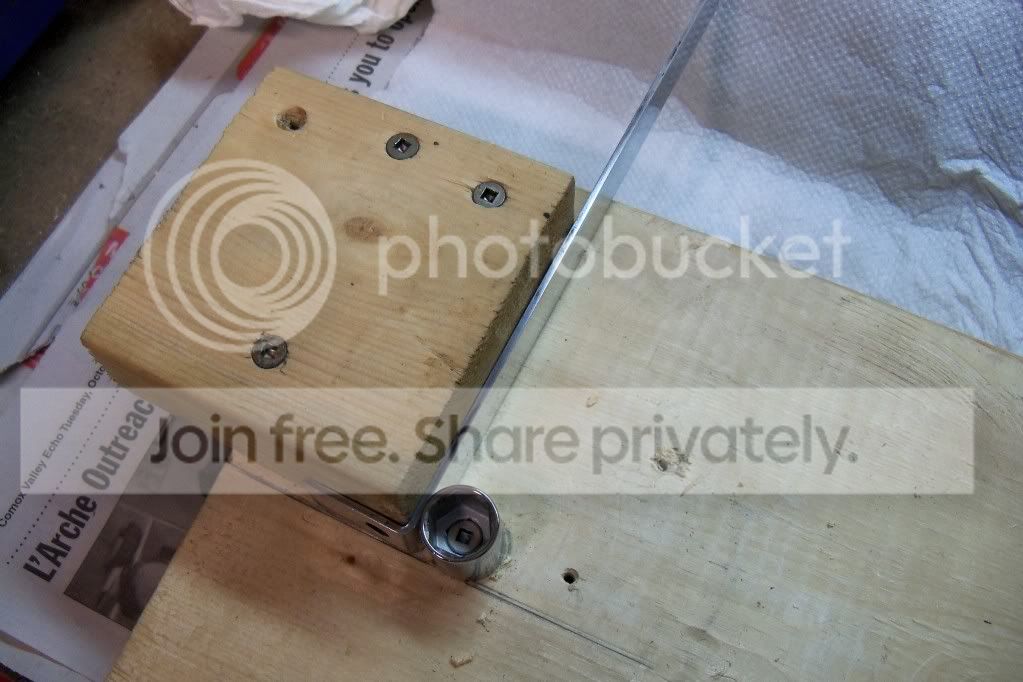

Bend 90 Deg.
I made a jig for the brackets. This also needs to be smaller than the tubing it is going over so it will grip well. I used one of my sockets screwed to a 2x10.
I used some flat bar as leverage with cardboard between so it would not scratch.
Do NOT drill the back hole until the clamp is around the "U" bracket. Then mark the back of the P bracket and remove from the "U" bracket, then drill. If you drill the hole now it will not line up when it is on the bracket.

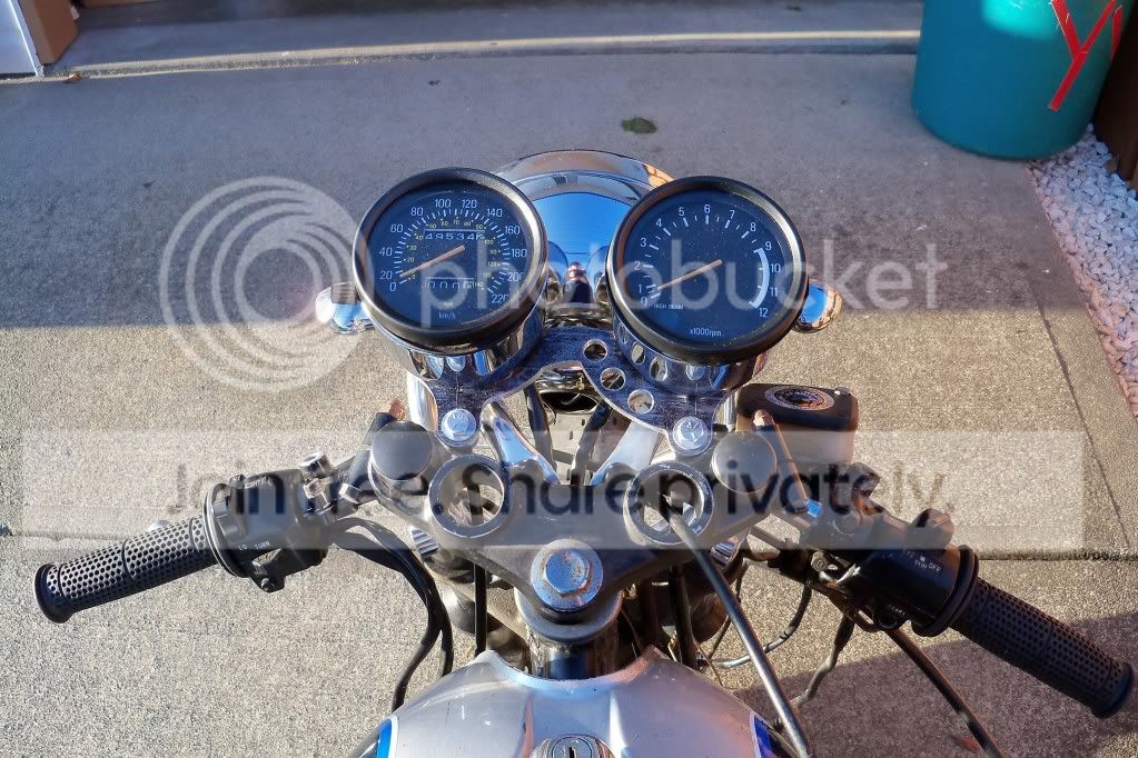

Next I designed my guage brackets. You need to know where the guages, speedo and tach cables are before you can plan the top headlamp brackets. Also take in to account any bolt or nut heads. This was especially important for me as I used acorn nuts.
The guage bracket was layed out on paper then transfered to a sheet of 1/4" aluminum. The holes were drilled and I cut the rough shape with a band saw. Finally it was hand filed into shape and polished.

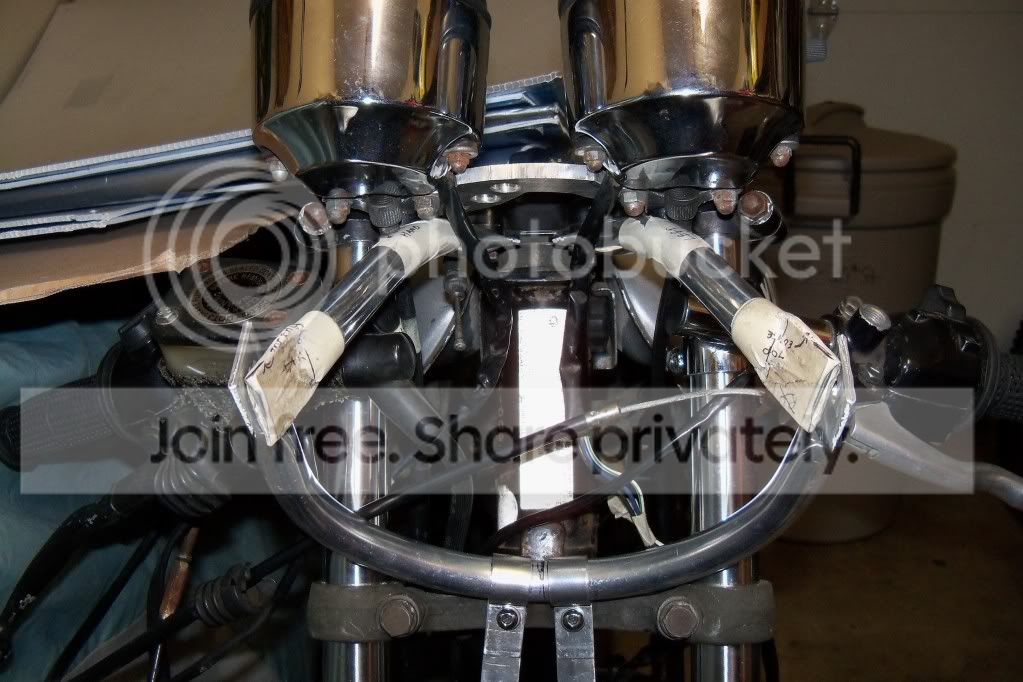

The top headlamp brakets or spars were a bit more difficult to make. I took what was left of my tubing and cut it in half so I had two equal spars. Then after filling with sand and taping the ends I put a random bend in each spar. What I should have done was put a bend in the center of the tubing before cutting it in half as it was difficult to bend the two small spars seaparatly. Empty the sand from the spars as I hope you did on the main "U" bracket.
Put masking tape on the ends of the spars to protect them from damage while squishing them (same goes for the main bracket) as well as giving you a place to mark where to squish and drill holes. I did not squish a long enough area on my upper brackets and had a problem whith them contacting the headlamp shell. I also learned that it was impossible to resquish them longer. The spar just pushed out of the plates I was using. If you have enough tubing you can make large squished ends to allow you to adjust the fit of the spar. The ends can be trimmed off later.
My plan was to mount the spars to the same bolt as my guage bracket but that put the spar in the same place as my speedo cable so I had to use the threaded holes that the ignition lock was attached to (I guess i'm relocating my ignition switch).
You can bend the end of the squished area to adjust the spars to fit properly. As it was I had to make spacers to drop the spars down to clear some of the bolts on my guages.
The spars were drilled and test fitted to the headlamp. This is when I realized that the right spar coverd part of the hole drilled for my idiot lights. As I had no more tubing and was to cheap to but more I wrapped the spar in masking tape and marked where the lamp would contact it.

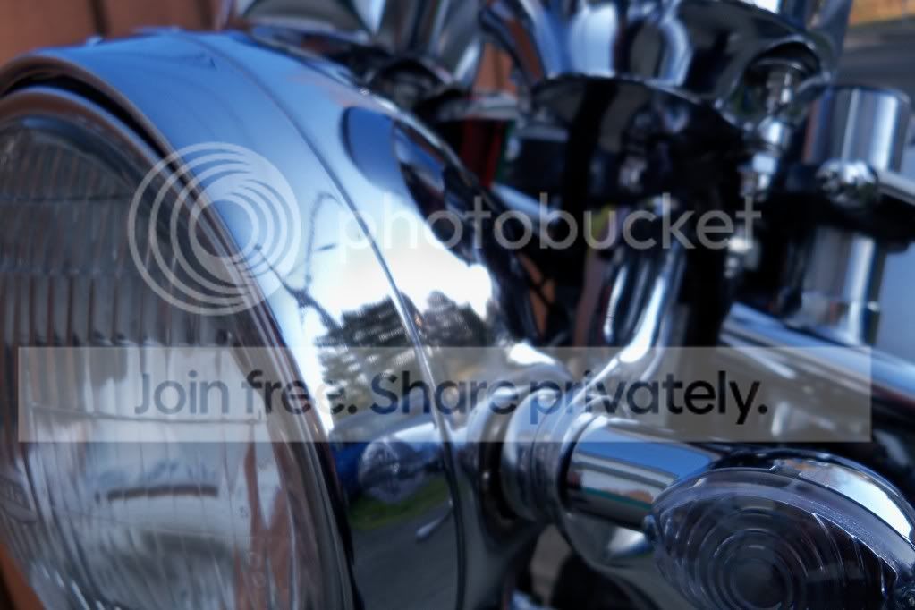

Finally I cut and rounded the ends of all the brackets. Replaced all the nuts and bolts with polished stainless steel and final polished the brackets and spacers.
And final assembly with polished stainless fasteners.
These brackets are very strong and lightweight. The bolts weigh more than the brackets do.

As for the turn signals, yeah they are plastic and I was not sure how they will hold up over time. On the upside the brackets are pretty snug against the headlamp bucket so the signals just keep the bolt from falling out.
Yeah - the plastic indicators have the stubs pushed / moulded into the body and they are pretty weak. More likely a case of "when" than "if" they're going to fall off.
Hate to see your nice headlight roll down the freeway :o
Hillsy
Yeah I think you have a good point there. I'll probably make another threaded aluminum spacer or maybe a threaded polished stainless washer to go up against the signal.
It would suck to watch your headlamp fall off. :-[
