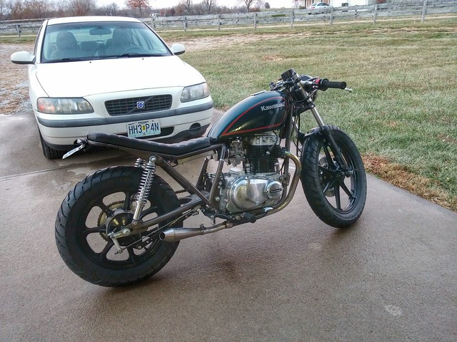

Rode around Saturday as it was in the 60's and did a good cleaning before storing her for the winter.
IMG_20141122_170247_1 by MBCo, on Flickr

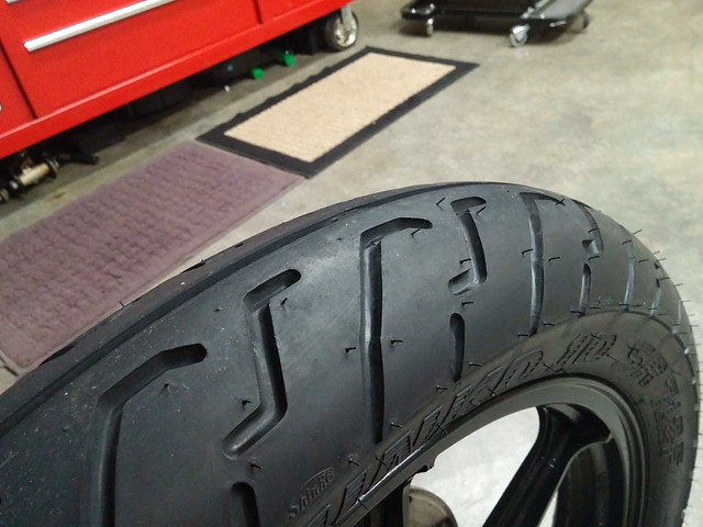

Tires got a good cleaning and scrubbin. Looking new again
IMG_20141123_070048 by MBCo, on Flickr

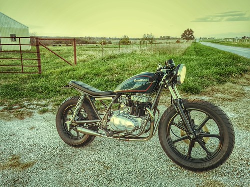

I have been following you for awhile and love what you have done. Did you cut the stock exhaust or but a 2 in 1? Also what kind how did you attach the sheet metal and seat to the bike? Thank you for your time and beautiful bike brother.
Exhaust is the stock main pipes centered under the engine, welded a 2-1 collector onto it then had a 1.5" pipe bent to the curve desired. 12" stainless muffler clamped onto it.
I didn't see any exhausts out there the style I wanted so I made my own setup. Minus the bent pipe I welded and did everything myself.
Seat pan is 14g steel bent to the frame, 3 layers of camping mat, 2 layers of soft cell foam, upholstered with pleats, glued to the pan.
Seat is easily removable by 2 studs welded to the pan that goes through the top bar of the frame. Fastened with wing nuts.
