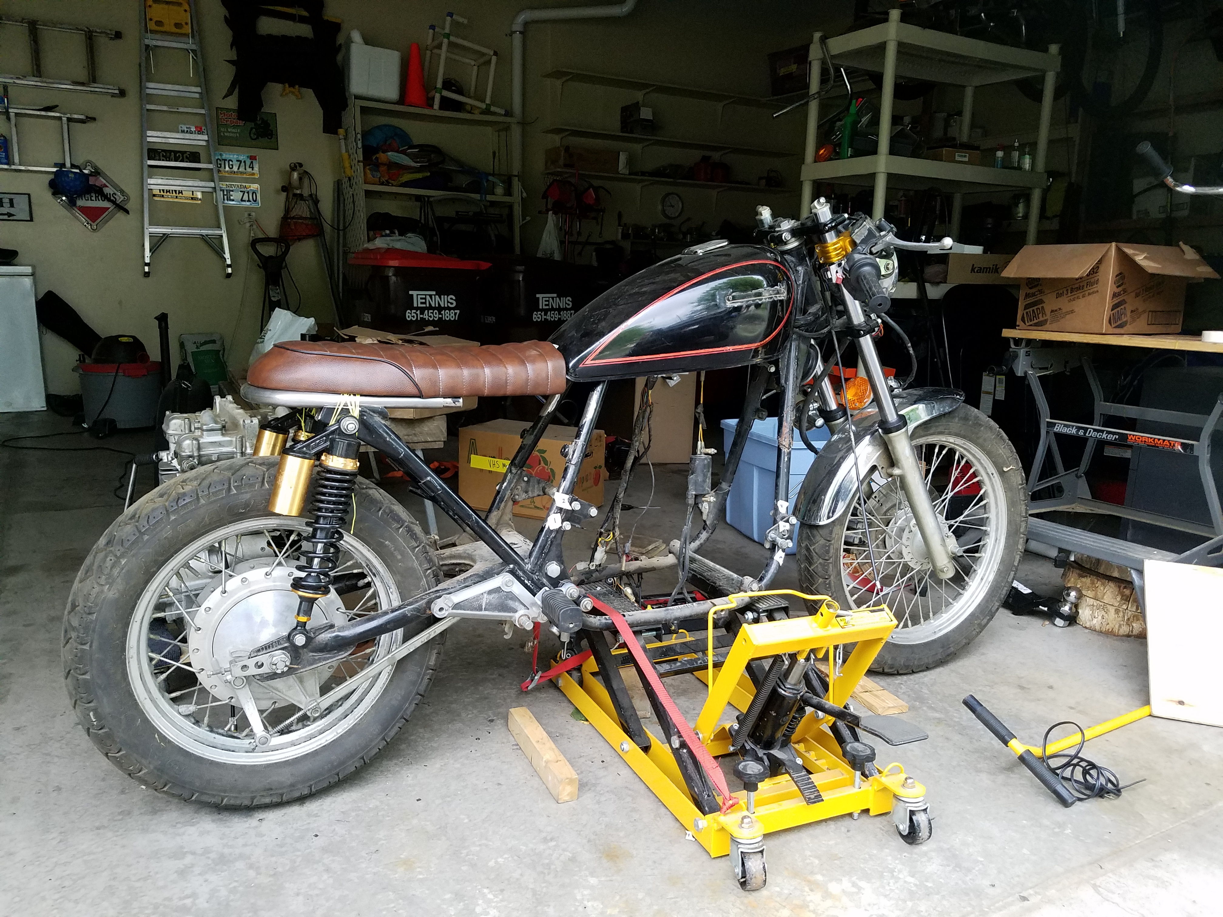

Here's the bike as it sat a few days ago. Since then I've gotten the frame welded up (pics coming).
open
My latest question - do I go with LED lighting (headlight, signals, and tail light) or stick with conventional? I've decided to keep the factory airbox in an effort to minimize the headaches of tuning the engine and so I'll be going with some sort of side covers - I'm thinking number plates at this point. So, I won't need to do a lithium cell battery and instead just do an AGM. So, what do you think? Make the LED jump and commit to the electrical system mods or just go with halogen headlight and incandescant bulbs for the marker lights?

These are great motors. It's not that big of a deal to do LED signals, mostly just a relay swap.
