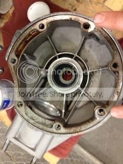

I took one of the tips from Guzziology and created a port in the rear drive to feed additional drive fluid up to the pinion gear bearings. The modification is not for the faint of hear! Drilling the port as the book describes has you auguring a pretty substantial hole through some seemingly very structural elements. Presumably David Richardson knows best, though.
Drilling hole:
Port from the inside of the bearing housing:
To complete the modification you need to re-orient the shim in the rear drive so that the wide part of the shim (which is supposed to cover the breather chamber) deflects fluid into the port. Normally, if you did this the paper gaskets would then be the only closing off the breather chamber, which seems like it would be a deficient seal, but my rear drive had two shims in it. This is odd , but it proved very helpful for this mod. I re-drilled one to serve as the fluid deflector, and the other remains in the stock position.
Shim 1 in stock location w/ gasket compound on it:
Shim 2 stacked on top of shim 1 to support the modification:
Shimming arrangement checked and checks out with the help of the blue stuff:
Rear drive complete!

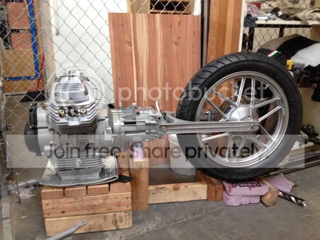

I finally got the drivetrain fully assembled.
Note the tube of moly past on the ground next to it. Apparently BMW used to make some special lube for greasing shaft splines and when I went to inquire about purchasing some of this unobtainable grease, I was told that the product had been discontinued. Honda apparently makes a comparable product for those parts that can realistically only expect to be lubed once in a bikes lifetime. It can be found here for anyone interested: http://www.amazon.com/gp/product/B0083BWUYW
