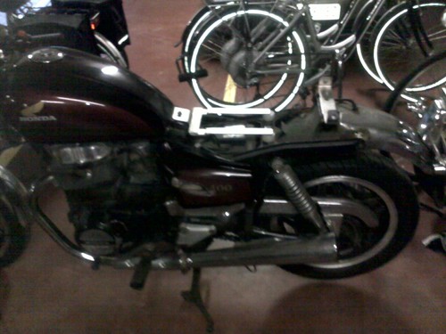

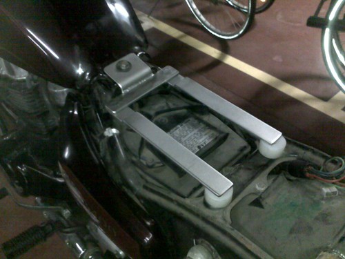

sarabando said:
This is going kind of slow. baut have to take in consideration that if I need to make something for my bike I have to measure at home and then build/weld during my lunch break at home.
Been working on the seat. Trying to get it in position.
031020121305 por sarabando, no Flickr
041020121316 por sarabando, no Flickr
041020121315 por sarabando, no Flickr
041020121312 por sarabando, no Flickr
Don't mind the dirt hehehehe

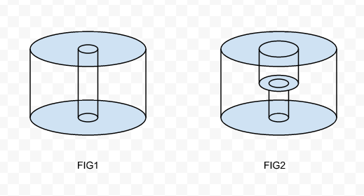

Hey man, where did you get those white grommets that you used to level out the frame you made for the seat? Im gonna have to do the same thing with my bike... Thanks!!
hi
The two grommets were made of nylon round, but can be made out of wood or aluminium. just cut two pieces of the same height, drill a 6mm hole in the center all the way thru (fig1) then with a larger drill, drill till half way (fig2), and then use a 5mm bolt with nut to fasten them on the existing holeson the frame.
Cheers
