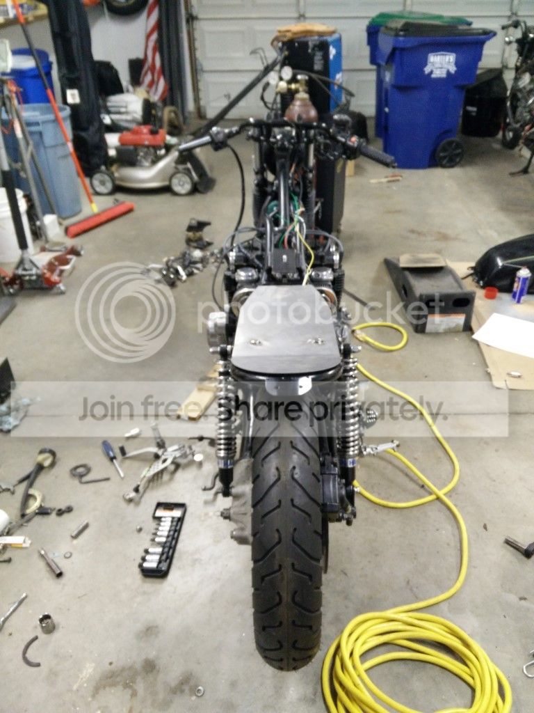

Rather concerned about the rear tire in relation to the frame though. It sits to the left, which I thought was maybe a shaft drive thing. Turns out it isn't, something is just a bit out of whack. Picked up a swingarm for cheap, and that didn't fix it. Alignment with the front wheel seems pretty good, but I haven't been able to accurately measure it yet. Just going to get it on the road and see how it handles.

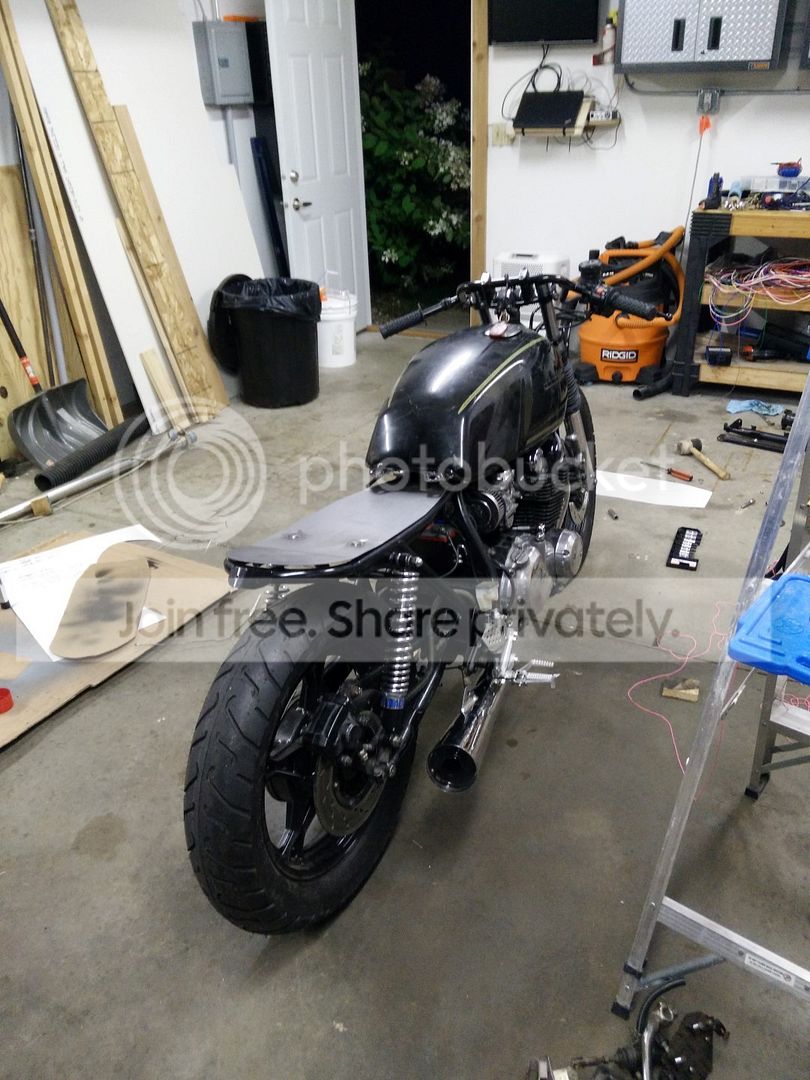

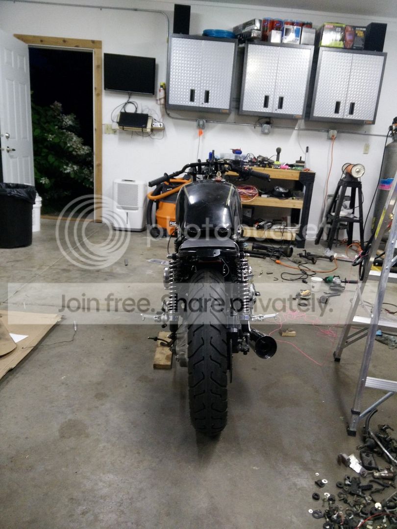

Got the carbs synced, took all of 5 minutes once I got everything hooked up. Adjusted the timing to be at the F mark. Idle mixture screws are two turns out. Tossed the tank back on and used a ziptie for the exhaust mounting bracket (waiting for the new muffler to make one out of aluminum). Took it down the block with it almost being dark out (no headlight yet) and nothing managed to fall off of it!
You can tell in the one picture either the tank is mounted a bit to one side or the subframe is a bit tweaked. Oh well.

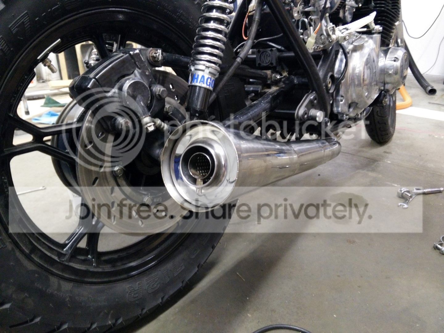

Tiny bit of progress. Picked up a Delkevic stainless muffler from their classic system for $90 shipped directly from them. I'm really impressed with the quality. Comes with a nice stainless t-bolt clamp and 3 different baffle configurations (full, center removed, entire baffle removed). Not sure why I picked up this muffler over the Mac I have, although the Mac was already rusting. I figure if I take the time to make up a mount it better be with something that will last a while.
(Ugh, clutch cover is leaking oil. Must be warped, will have to remove and use some RTV)

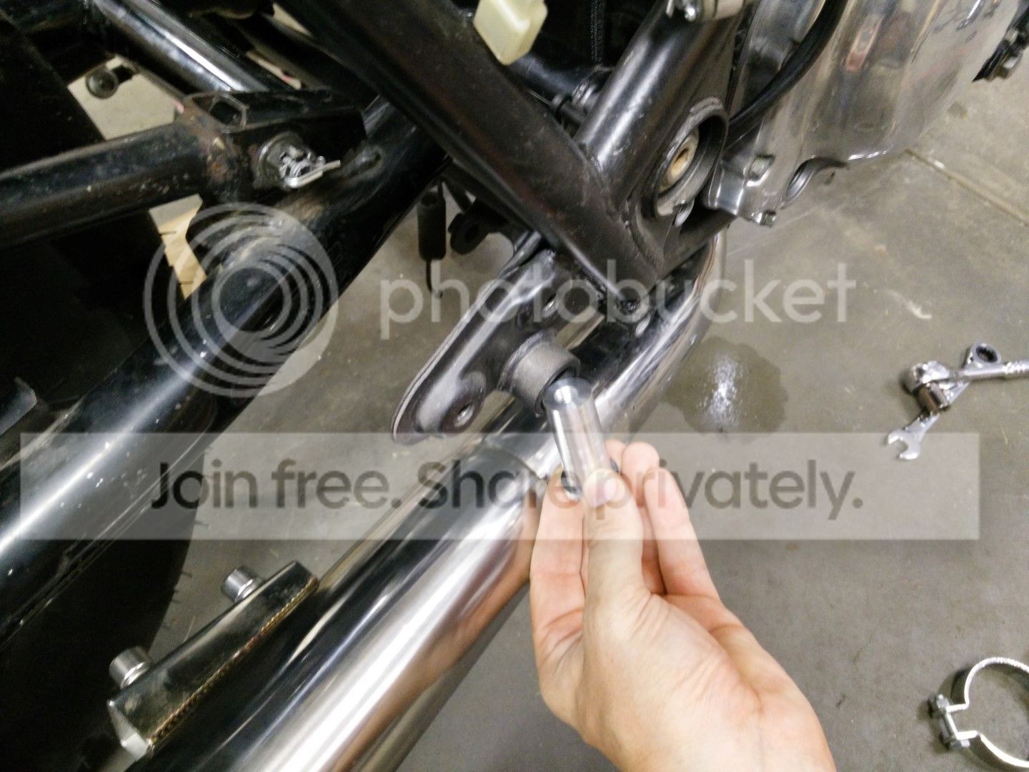

Anyways, instead of doing it the easy way and welding up a bracket or bending one up to mount to a stock frame mount, I turned an aluminum plug/bushing on my 9x20 lathe to fit in the frame so that I can mount a solid bar of aluminum right in line with the mounts on the muffler. Drilled and threaded M10.

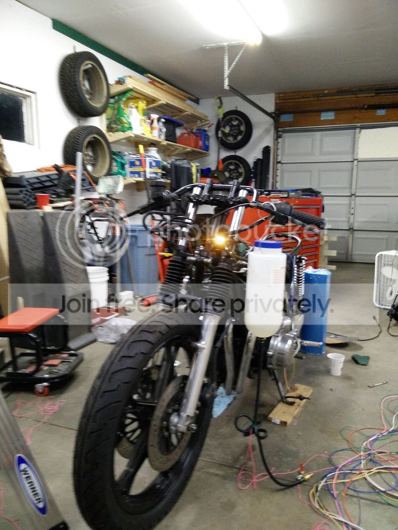

I decided to use the first ones for front turn signals. They are tiny, and really aren't that bright, but they should do the job. I should have taken a closer up picture as they are hard to see. Headlight isn't mounted yet, need to machine some spacers first. Oh, and I will definitely be making a DIY brake line to replace the one you see here.
The flasher relay seems to work great.

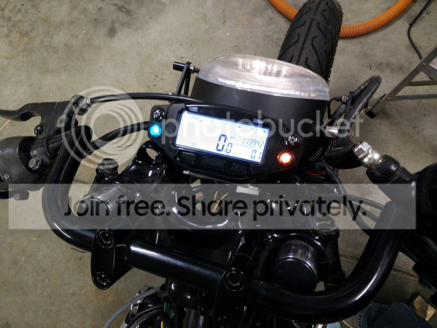

I bought a Trail Tech Vapor dash unit along with the shroud for indicator lights. I need to make a mount for that and wire it up which shouldn't be too bad. Maybe I'll actually get to ride this damn thing before Winter comes...

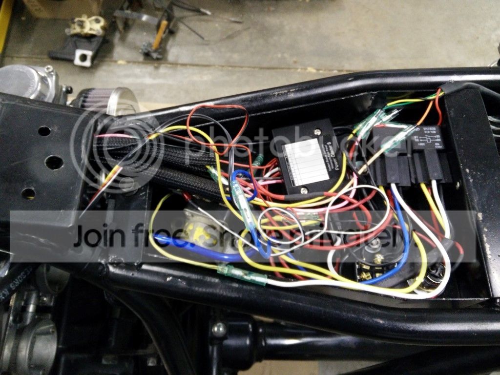

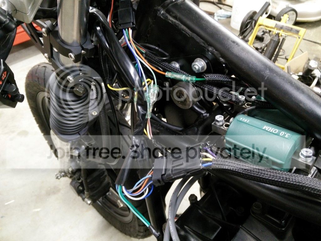

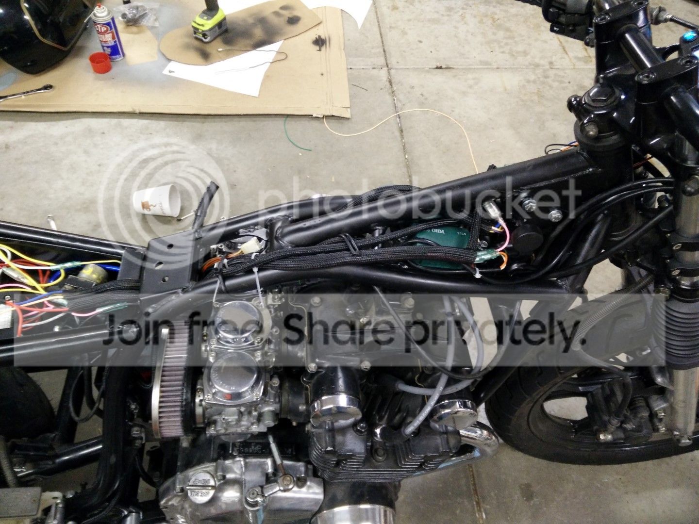

Got all of the wiring done tonight. Not the cleanest, but it works. A little cleaning up yet to do, then adding the RFID module and making a mount for the Vapor dash. I wish the wiring was cleaner around the battery, but this

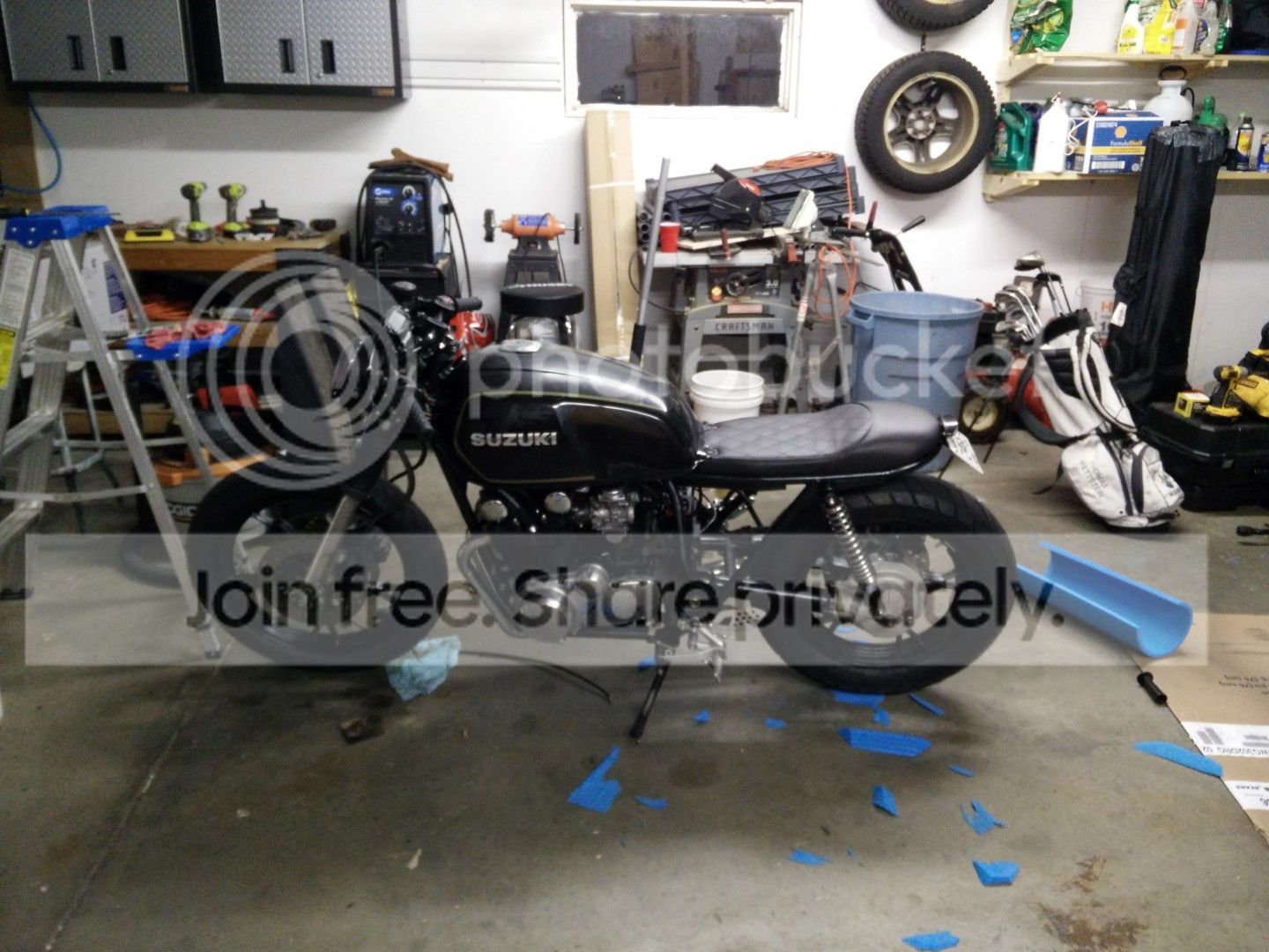

Started shaping the seat using the crappy foam mat from Walmart. I'm going to shave a lot down from how it sits now. It won't be a comfortable seat, but I picked up some marine vinyl and my mom is a seamstress, so with diamond stitching it might turn out alright. Wish I went a few inches shorter on the rear end, but we'll see how it turns out. I can always chop it off and put a new hoop on, and build another seat.
Got the seat done! Pretty happy with the way it turned out. I could have done a better job on the shape, but my mom did a great job with the cover despite not having a machine that was meant for upholstery. If I would do this again I would definitely invest in some better foam. The 1/2" thick stuff I got for the top is basically useless, so this seat is not the least bit comfortable.
Next up is removing the tabs from the tank and possibly taking it somewhere to get painted (I did a tank before and it was a pain), and ordering up some clipons.

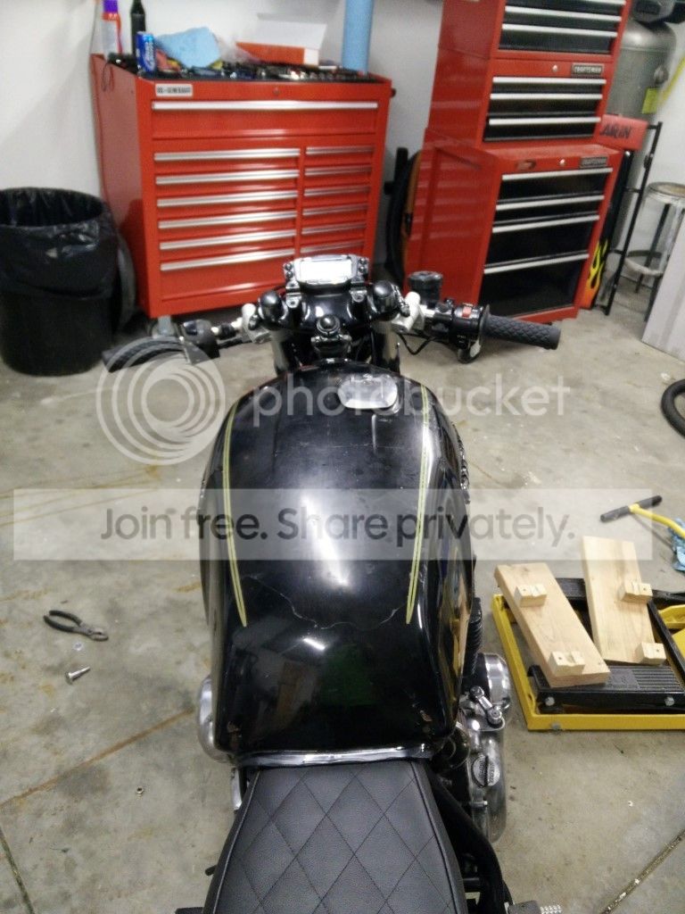

I think I'm just going to keep it simple and go with black. Here's a shot from the front with the vrod headlight. New Tarozzi clip-ons arrive today, we'll see how they fit and look.

Well I got my Tarozzi Low-rise clip-ons on. I went with these not for the rise, but for the offset moving them forward. I have limited clearance as you can see...
But the problem is that even to get that clearance, the bars are too flat. I need to be able to put them at least a 7 degree downward angle with more pullback. I'll have to modify the turn stops by drilling, threading, and adding a hex head bolt on the frame or something.
Well I cut bracket out of 1/4 steel to make a turn stop so that my handlebars don't hit my tank. Hopefully it's not too restrictive on the turn radius, but it's a much more comfortable position.
I also decided to order up a MTW .110 connector kit from Cycle Terminal. The Weather Pack are nice, but they are way too bulky. I also need to redo my wiring as it's a complete mess. I have crazy respect for people that make harnesses, because I even did a wiring diagram and everything, but just adding a few components here and there (a battery/charging system LED monitor) and my RFID setup just made it confusing. I should have scrapped the RFID because it adds a lot of wiring with the relays and stuff, but oh well. I have a Brother label maker so I'm going to print off film labels to label the wires.
