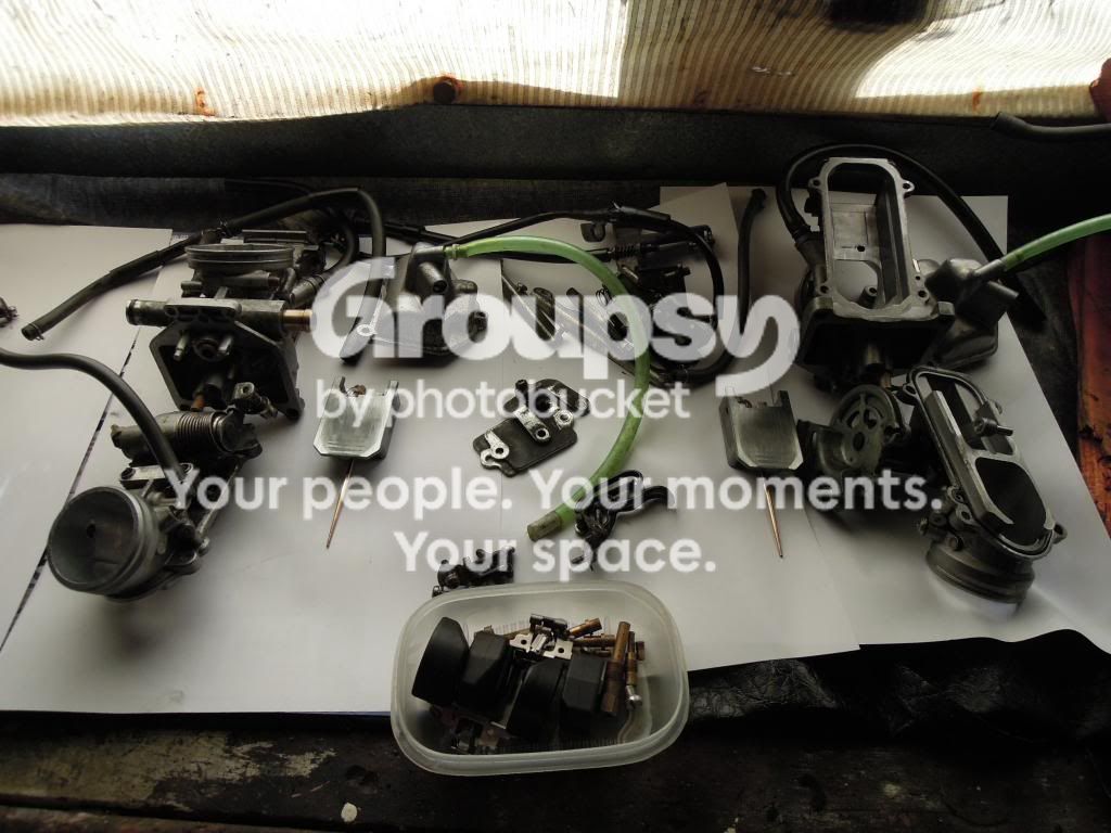

I've been riding the NSR around the neighborhood a bit. It's starting to run very rich, fouling plugs and just lacking power and crispness. Thought I'd better strip the carbs and give them a proper clean. They were pretty clean inside but I pulled all the jets out anyway and sprayed carb cleaner through all the passageways. I also gave the outside a good clean with carb cleaner and brake cleaner.
They have unusual two piece bodies.

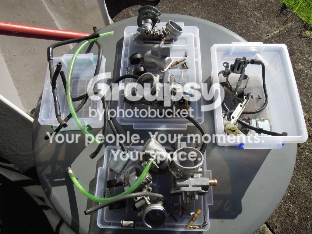

As clean as I can get them.
After all that, the engine runs exactly the same, very rich. I'll keep fiddling with things until I get the motor to crisp up. I know this isn't the place to get technical advice for this bike, but if anyone has any suggestions for solutions please let me know.
