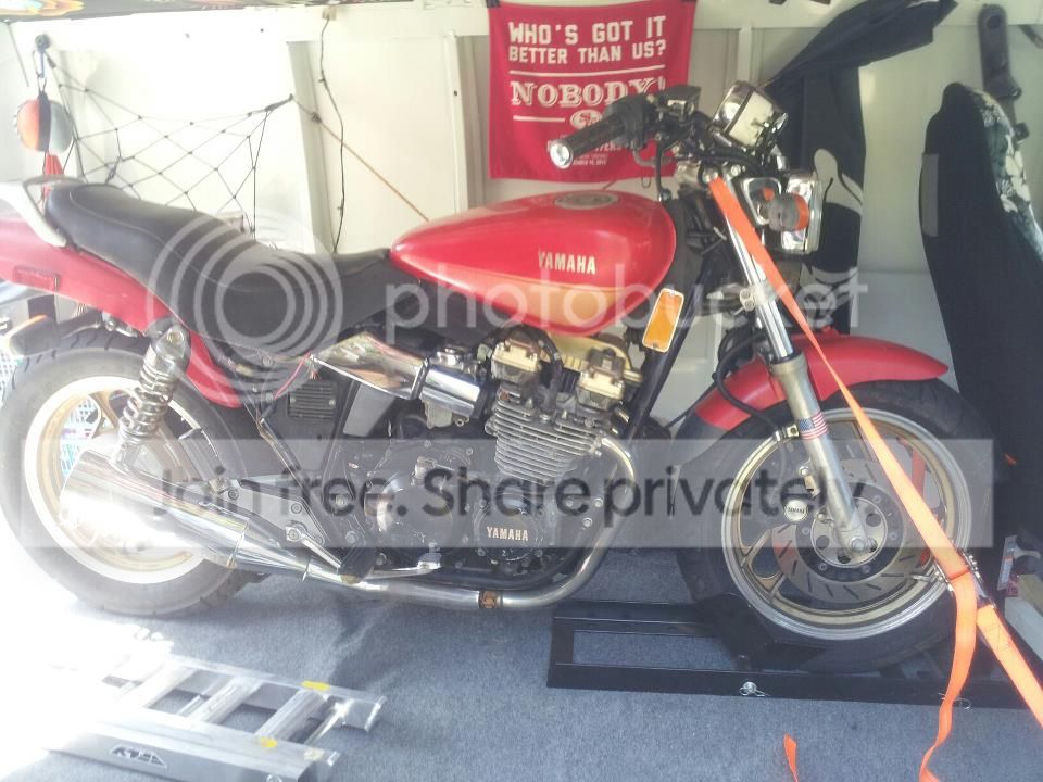

In the van...
...and her new home.

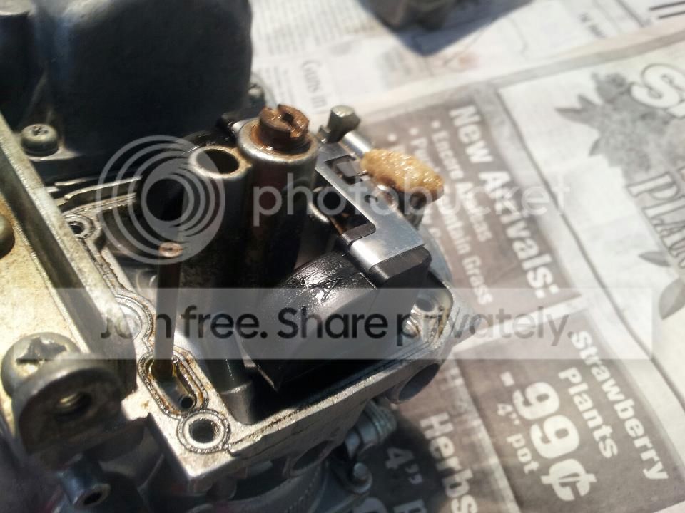

Cleaned carbs, my ass.
I knew I was in trouble when this came out of the drain screws.
Pretty nasty.
I have the slides polished and clunking, the jets and float bowls are soaking, the choke circuit has been cleaned and doesn't stick now.
Then I ran into some issues.
Two of the screws for the needle set are stuck and buggered up...
All four of the slow jets are buggered up and stuck. One of the mixture screws is stuck and they messed up the head when they drilled out the plugs. The other three came out, but the slots on the heads of them are iffy.
I will get new bowl gaskets and needle jets. There's a carb guy down the street from me, so I'll see if he can help me out with the stuck stuff and maybe have some replacement parts.

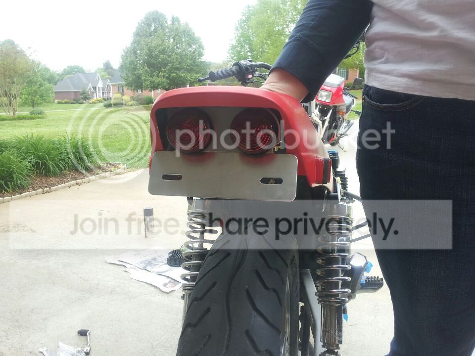

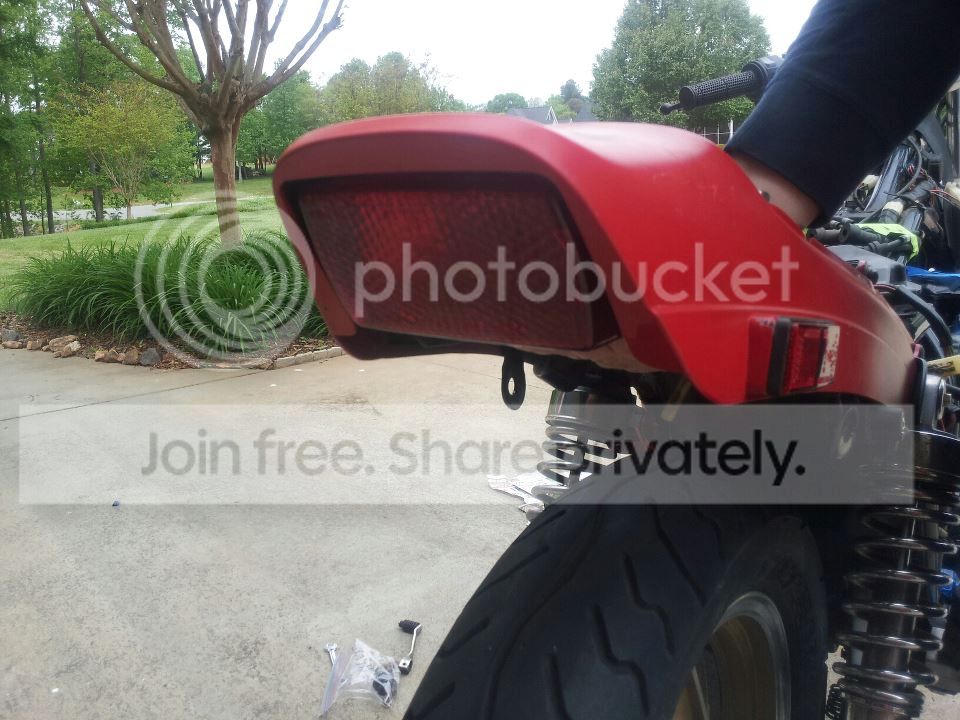

Give me your tail light opinions.
Option 1: Stock tail light (I'll fab up a license plate mount)
Option 2: Stock light but "frenched in".
Option 3: Aftermarket. Dual round lights. License plate lights and holder are already there. I'll probably black out the background.

The stock light installed flush looks the cleanest, I think. The dual lamps look like you forgot about them until the end and then stuck something in.
