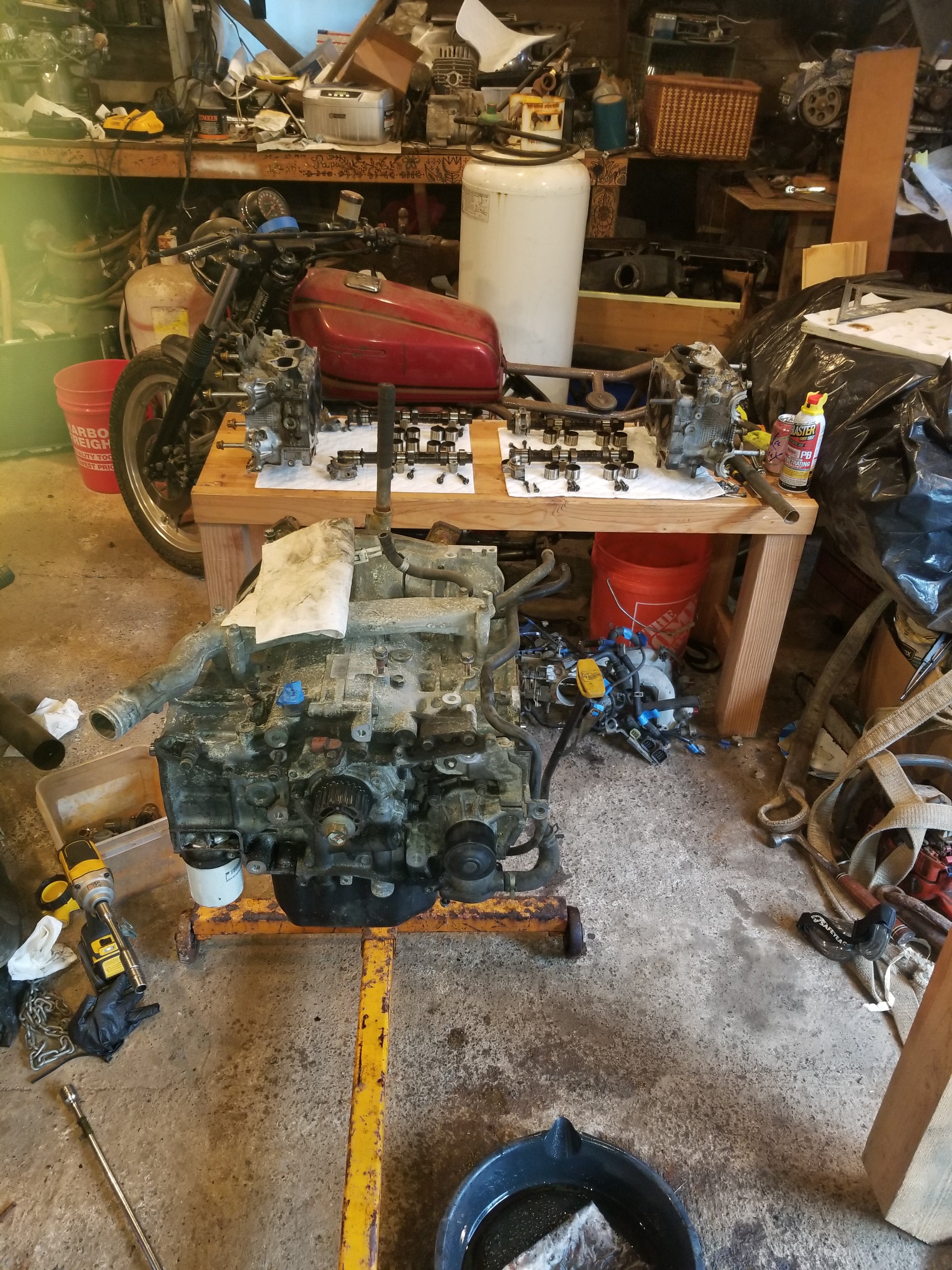

A bit more progress...Cylinders look good enough, cross hatching visible. Apparently my straight edge is M.I.A., so cant check that yet...I suspect a 5 year old has been chopping blackberries with it. One cam bolt decided to strip its edges, tapped on a 3/8 and hit it while turning popped it off thankfully.
Now it's slow time....my valve compressor got lost in the mail, waiting for confirmation.
That's good though, I Need to do some homework.
That's the 76 gl1000 motor I should do something with...a buggy/sounds fun...
Update....its been slow. Got heads back, got all the parts now...minus some vacuum hoses but hopefully Get it reassembled this weekend...am cutting and splitting firewood though, so that sucks lol.
Well...after lots of firewood, helping someone move, and several interruptions...
It lives lol.
Now to daily drive a bit. If it survives a while its gonna get some forester springs and a spacer lift.
