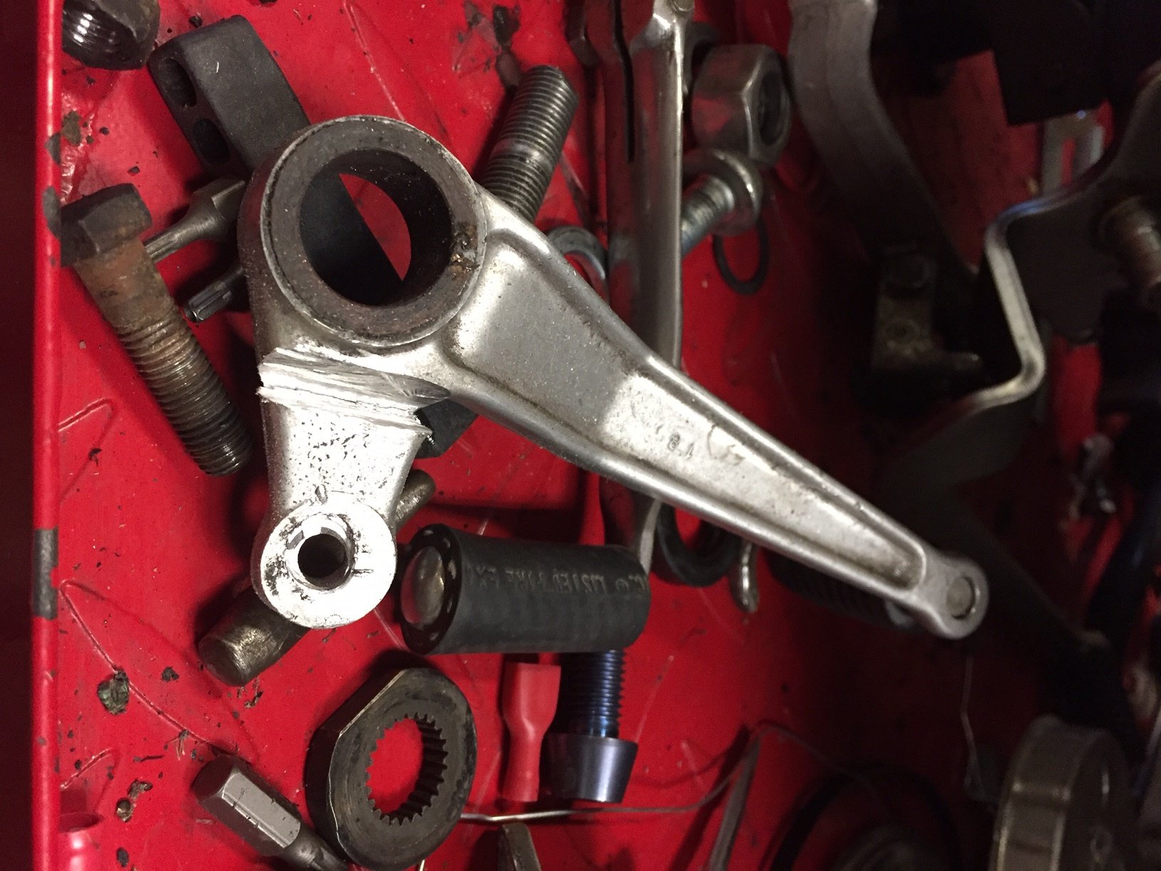

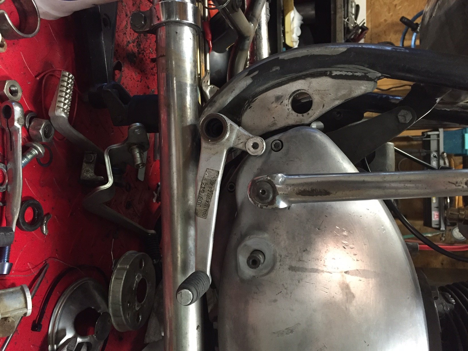

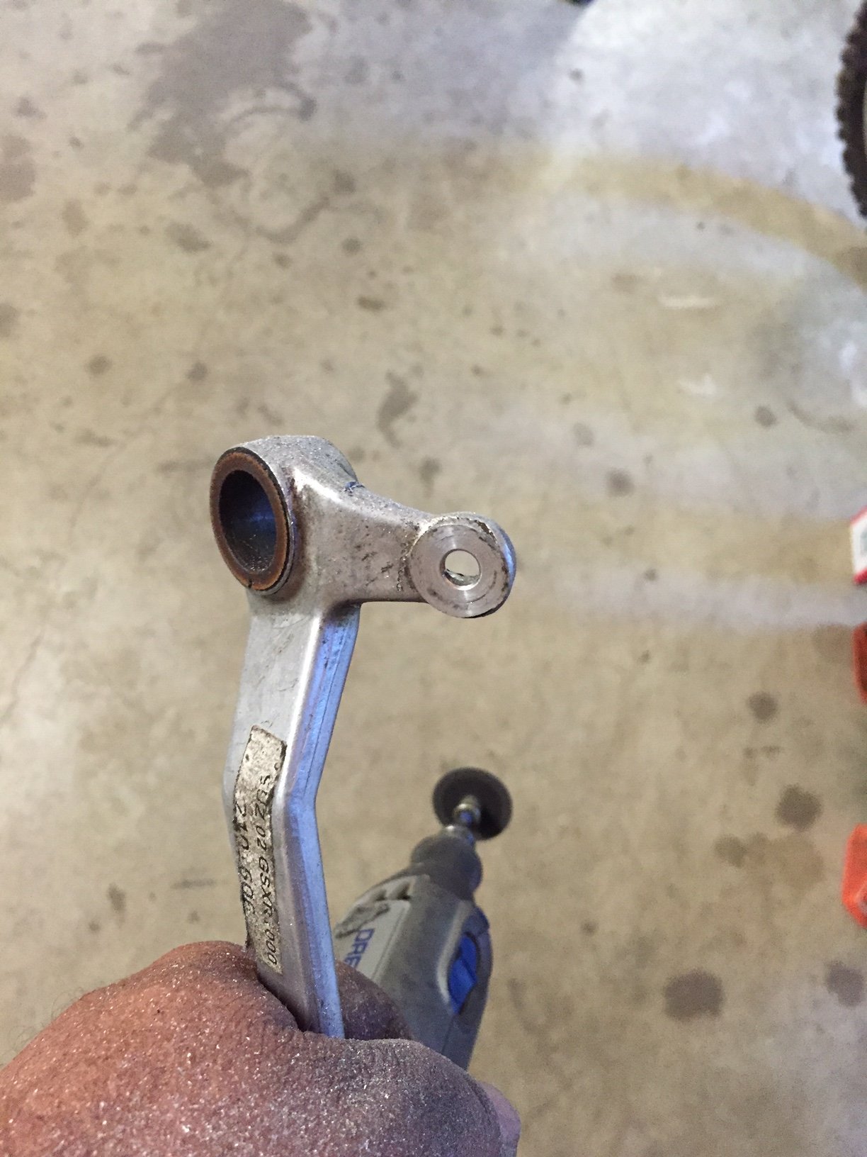

I want these pegs so I need to reach over to the the shifter this creates a linkage system so the fab begins again... already screwed me on the brake (lefty controls) switching between tigin and migin :o still workin the throw out and clearances around the wicked kicker that I need to reshape some because it sticks out from all the Lightning body and crap 8)

Tune, would moving the pegs forward a little work with the ergonomics? That might give you a little more room to work with. An other possibility is to use the old rear set style with the gear shifter looping over the kickstarter.

I could use the stock bracket as a mount and do some creative adaption to the pegs but the kicker is in the path if I go up over... I don't want forward controls and this position is very comfortable, had lots of riders test it and the target buyer is short... he loves the bike and he's a pro rider so good exposure lol
I will end up with something like this but still working on clearance at the kicker may be that I drop the shift pivot a tad more and the peg a 1/2 in or so to follow with a narrower bolt on heim joint then shave the nut/bolts and tack weld to look like a factory pressed in pin.

I completely forgot that Brit bikes tend to use the cotter pin like and old bicycle pedal crank. I was going to suggest adapting a folding kickstart lever and heat and bend it for more clearance. You could probably weld and machine the lower part of that lever to take a folding kicker off another bike but that's going to be a 5 minute job.
OK so another off the wall idea. Take the linkage up and across the frame for left foot shifting and just have a brake lever on that side. That would be even more work and maybe a brake lever would take up the same space as the shifter.
OK. last idea. How about moving the pegs back just a couple of inches and revers the shifter (and shorten it). No linkage but the kicker will probably still hit. Damn. Now you know why my latest project has a cover over the kickstarter shaft ;-) Not an option on that bike though.
