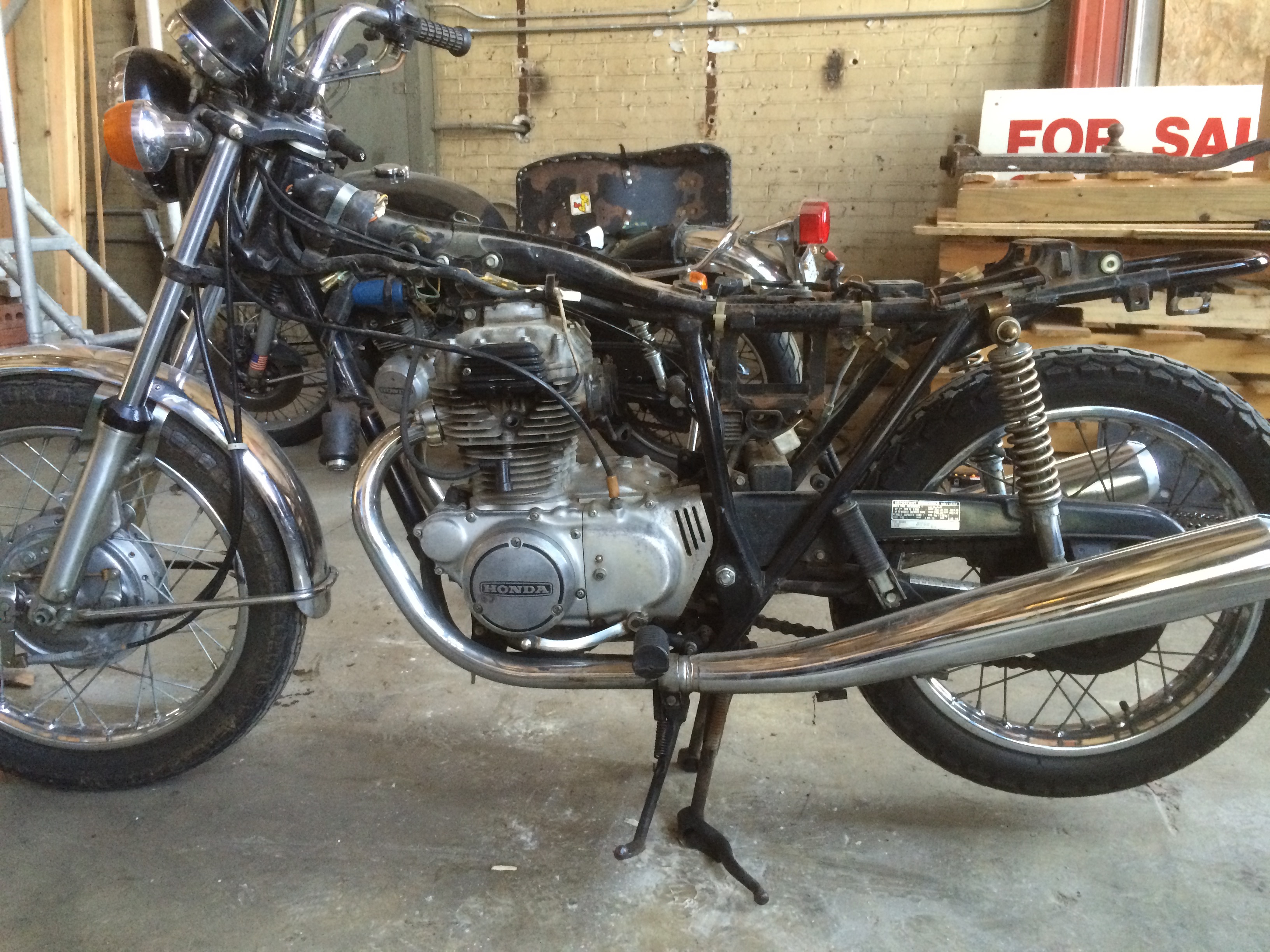

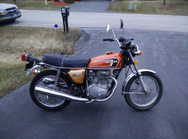

Recently picked up a running - I use the term loosely - 1974 CB360 with just under 14k miles for a fair price. Photos make it look better than it does in person.
Has a number of issues, most electrical from what I gather. Spark plug wire was cracked open and possibly not firing consistently, starter would make a slight attempt and halt, condenser ended up showing no life at all, carb overflow was going nuts on one side, exhaust was rusted out on the bottom of one side, mismatched mirrors, etc.
So the teardown begins. Learning as I go. End goal is a restore/rebuild from frame upward that's super clean and minimal. Thanks all.

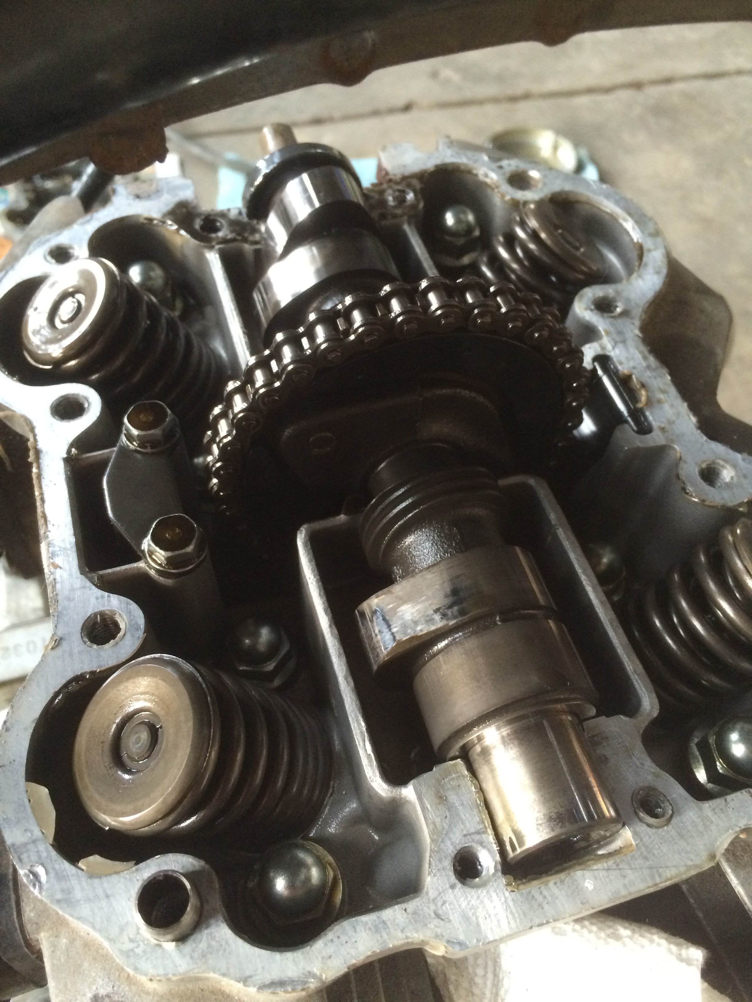

More progress on stripping the bike down. Before removing engine I removed valve cover and installed a new cam chain tensioner. Don't love the look of the cam lobes but for now I'm avoiding getting too deep into a rebuild. Suspicions of running lean on one side were confirmed with white buildup on the exhaust valve of one side. Valve adjustment, point and timing adjustment complete.
Have an accumulation of new parts stocking up at home. Look forward to getting past the tear down hump and onto the rebuild phase.

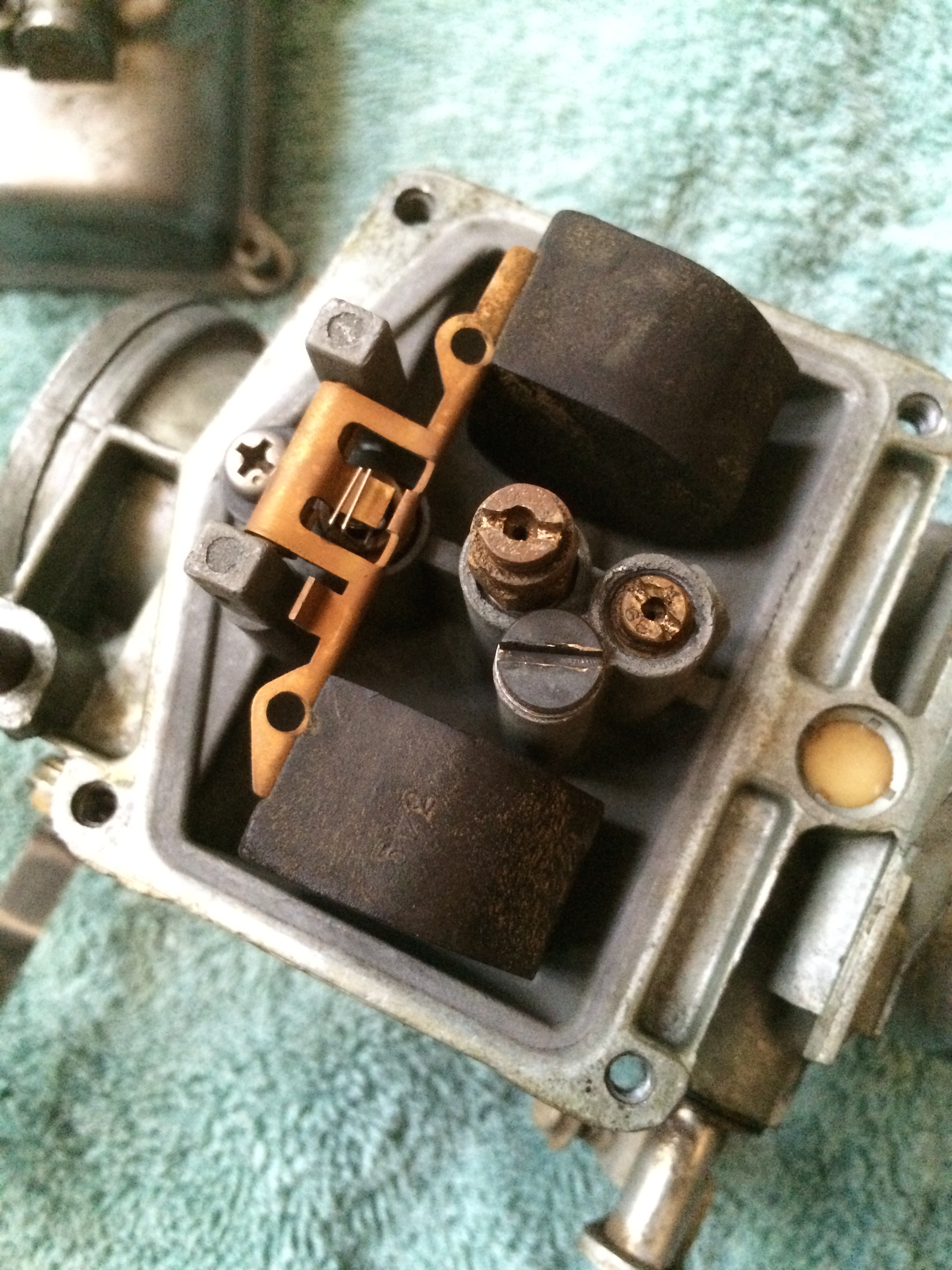

Forgot to mention, carbs are currently safe and sound with PJ for a tune.

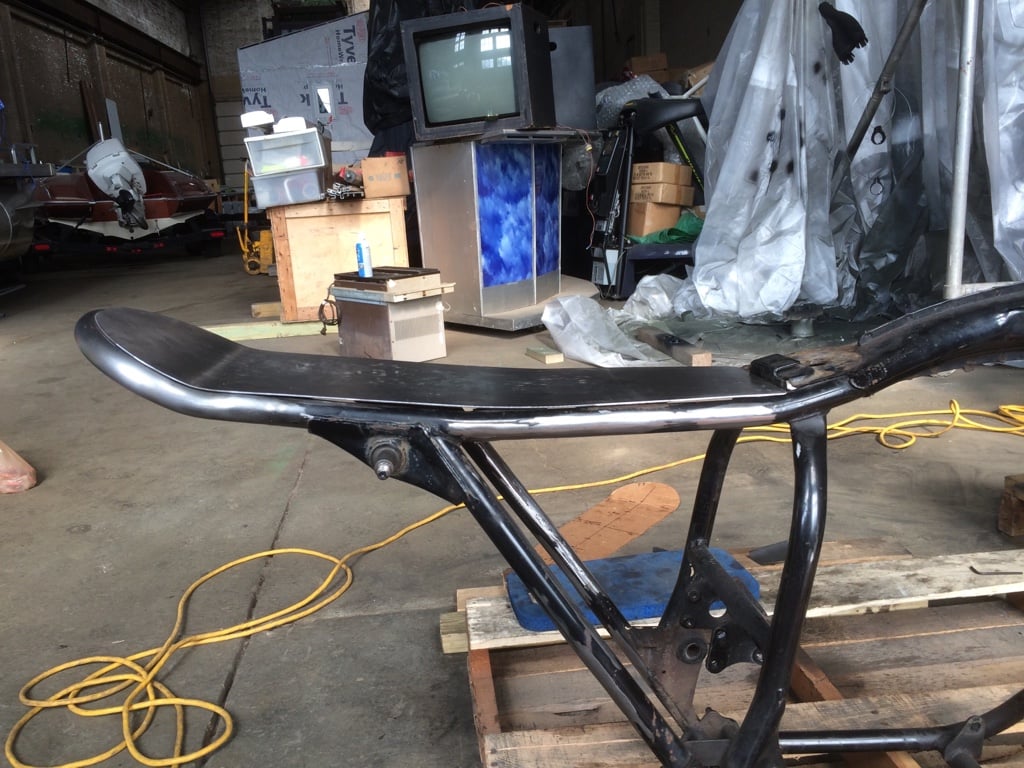

New seat hoop was successfully welded on. Just dropped off this morning at the powdercoaters.
Received carbs back from crazypj as well. Haven't even opened the box but I assume they are perfect.

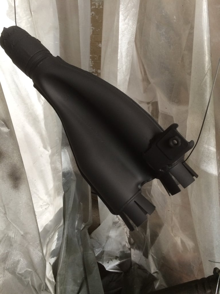

More progress on the holiday weekend. Fabricate the brackets for xs650 ignition coils this morning. I believe I'm done with painting now. Had broken off a rusted bolt disassembling one of the driver foot pegs and a friend came through with a spare. Gave the peg hardware a fresh coat.
