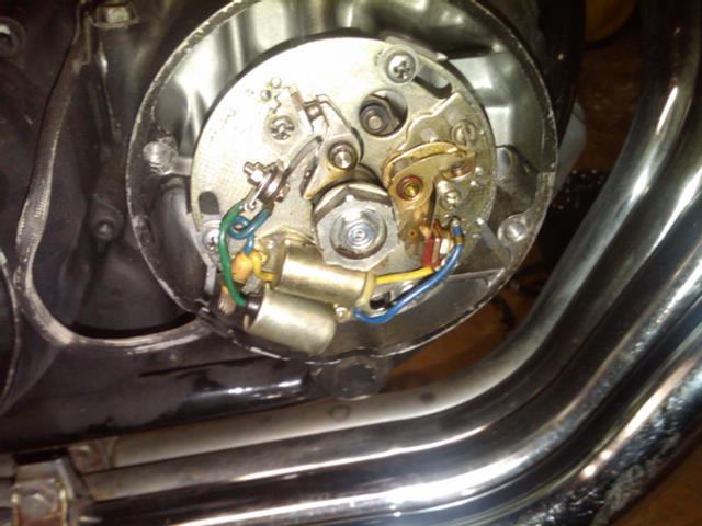

Yeah... my points dont look like stock.... Here are some pics of the current set up. You can see the red wire on top is actually the black with white trace that comes from the ignition coils, then we have another black with white trace that i dont know where it goes (diagram shows goes to "main switch" and splices with a brown wire and goes nowhere <~~~ what does that mean?), and finally we have a ground.
I am just guessing here, but i think the green should go to ground, the red should go to ignition coils, and black should go to main switch? sound right?
thanks for any input you guys can give as i have tried a few combinations with no luck.... maybe i screwed something up somewhere else?

That box is a transistor assisted ignition I think - as someone mentioned earlier. They don't do a whole lot, but they do extend points life.
Ignition wiring is usually 12V to main switch to Kill switch to coils to points and Condensors and through the points to ground.
Transistor switching is wired differently. You could try removing the box and wire as per stock and see if that works.

do my points look right then?
if i try and bypass the box and connect black with white trace to black with white trace and leave the ground i still get nothing.
