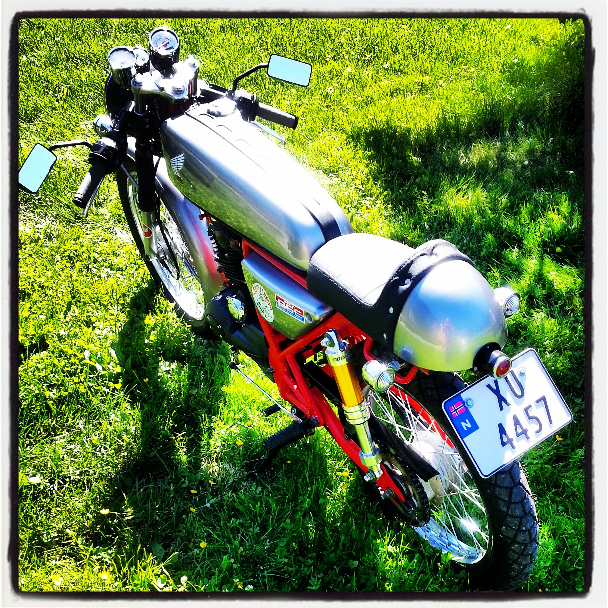

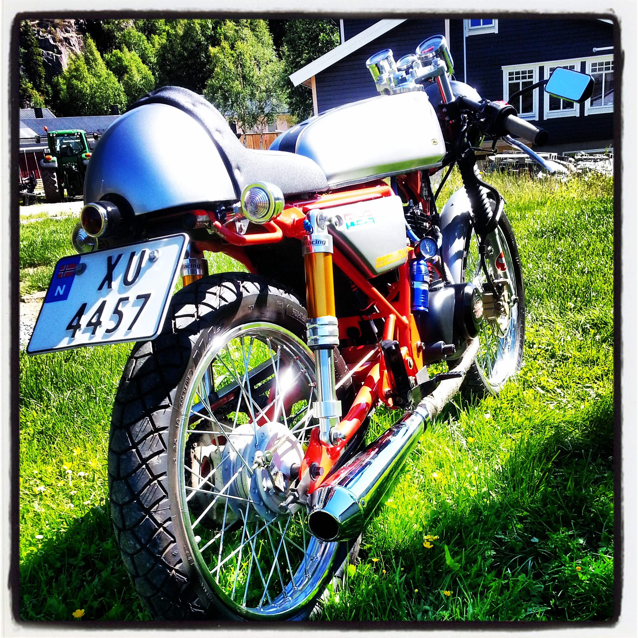

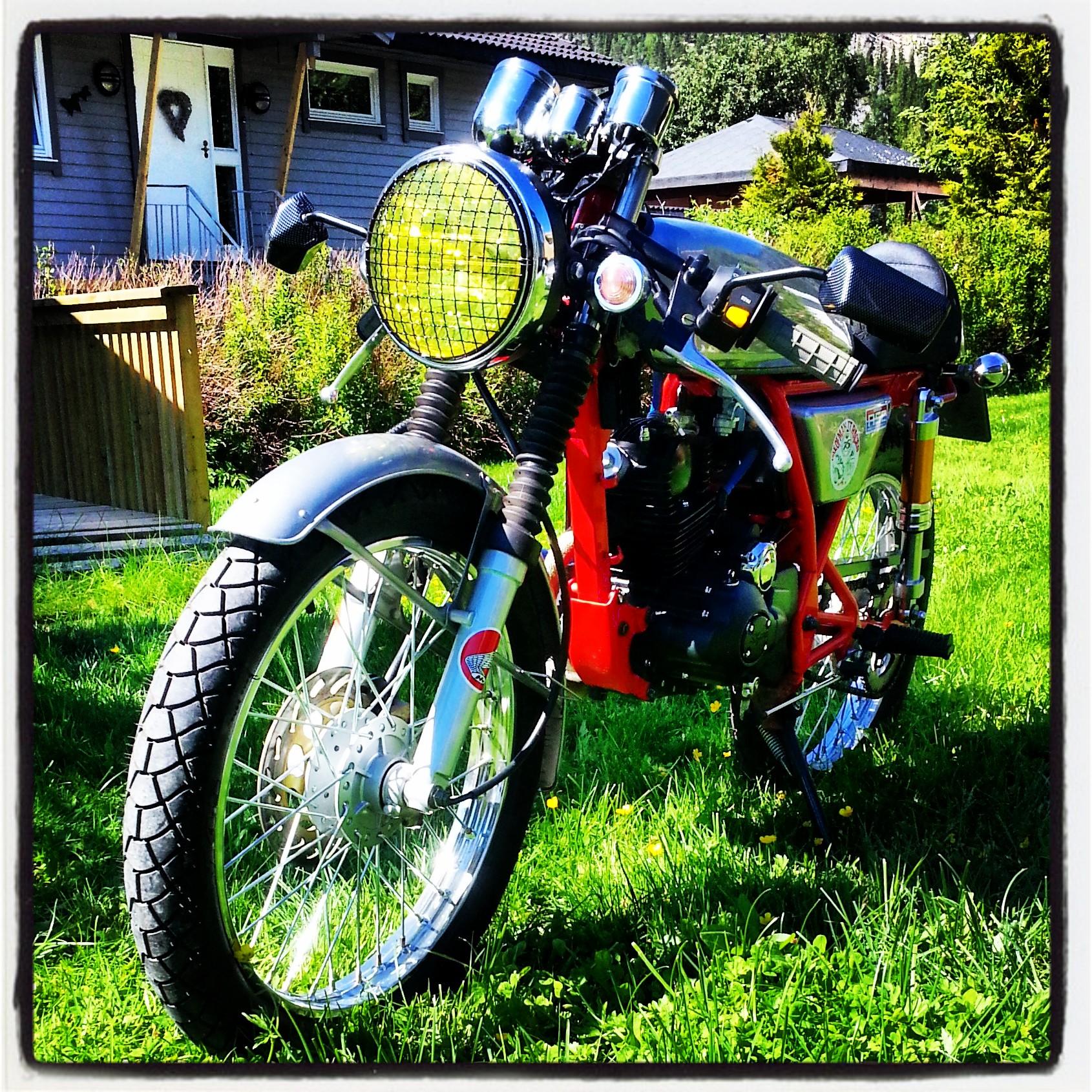

Here's a few pictures of my 50cc (72cc) with the latest mods in place...
clipons, headlight and nos-bottle...

Thanx! :) It's a fun ride now... and it gets quite a lot of attention!
Planning to fit some kind of rear hugger fender, so I can remove the mat I fitted to the frame.
I think that will give the bike a more lightweight look, as it'll expose more of the frame.
I've still got to relocate the battery under the seat hump, first tho...
Not sure about the frame colour, but I'll probably change it during next winter (maybe, that dark blue Honda racing colour).
I really love that "UN-blue" frame on yours! It really makes the bike stand out from the crowd.
The bottle is not connected at the moment.
It wouldn't be road legal here in Norway. So for now, it's just for show. ;)
The clipons made the bike a lot more nimble.
The way you connect to the road as you dive in to the bends is quite astonishing!
The bike seems like it would work well with bigger engine now...like a 250cc ;)
So...who knows what's to come... :D
