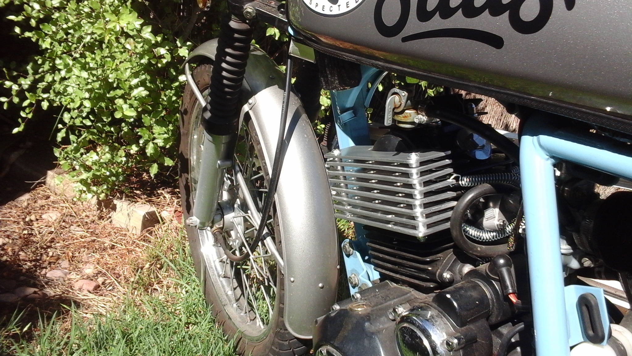

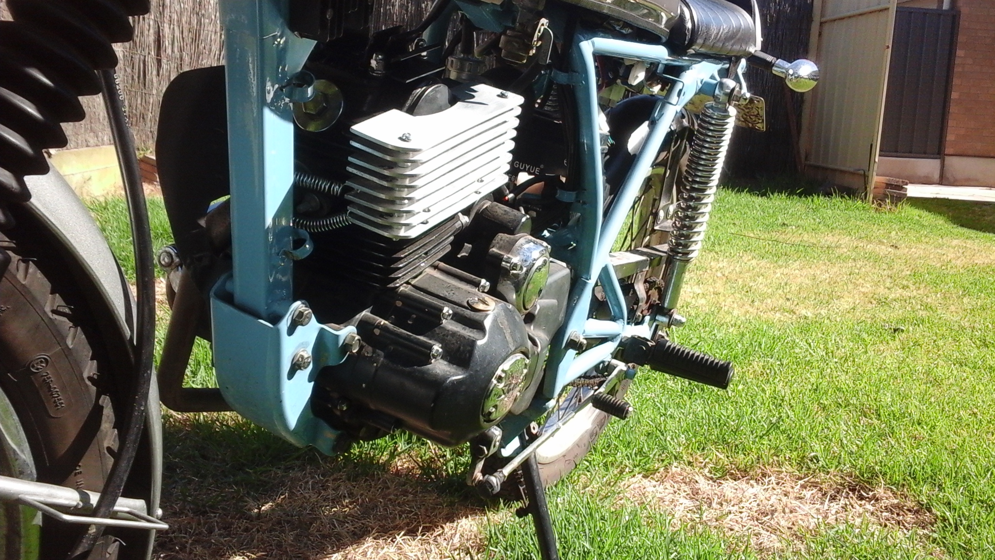

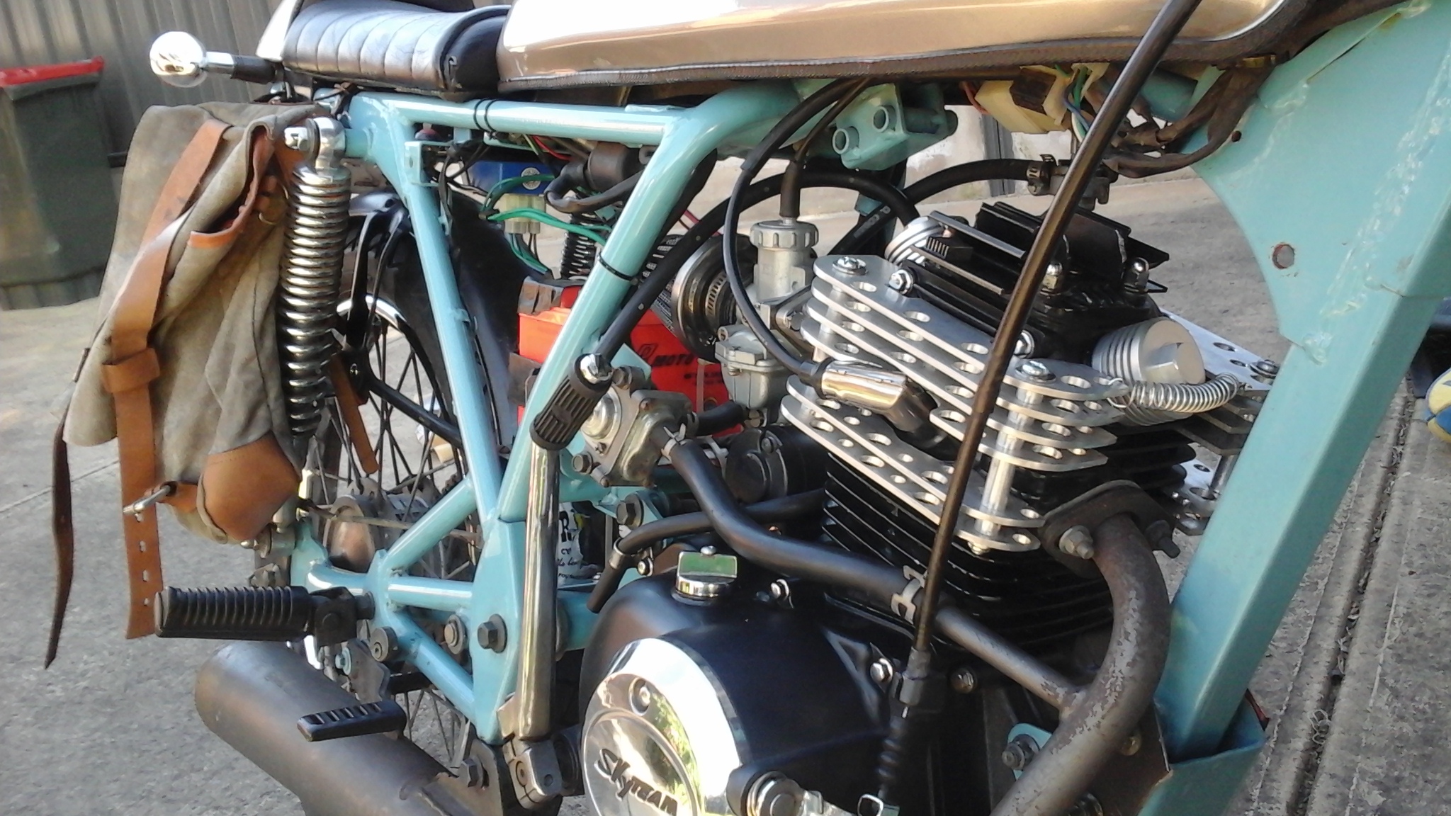

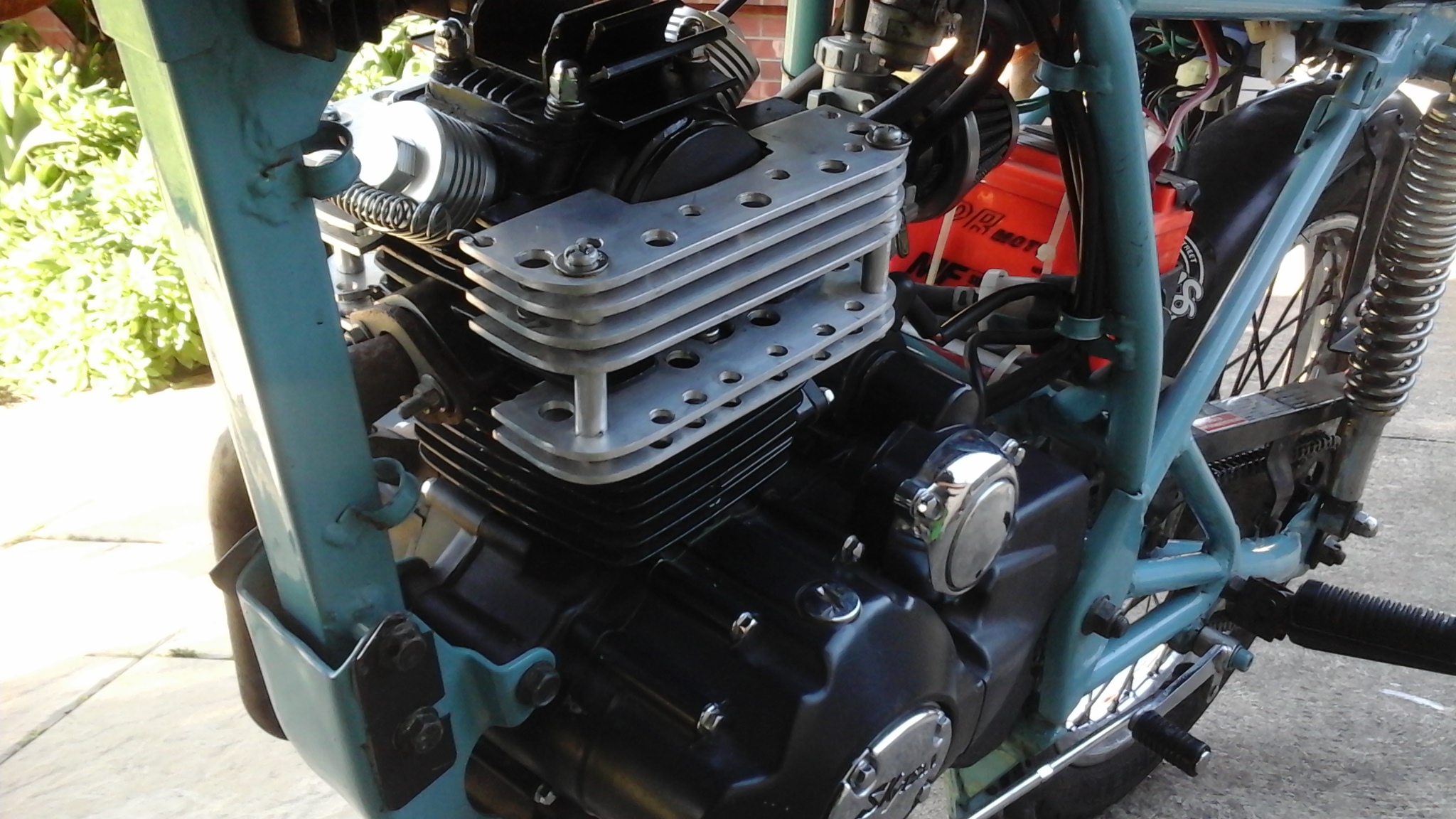

Ace 50 oil cooler
Fitted on the bike , can put my hand behind and feel heat flow whilst riding ,front of fins cool rear hot only one side made so far ,big valvehead is different to original head castings as it needs massaging to fit properly . I will leave it on and ride it until i make the other side . I will also drill the top plate now that i have it on an can plan a neat pattern of holes

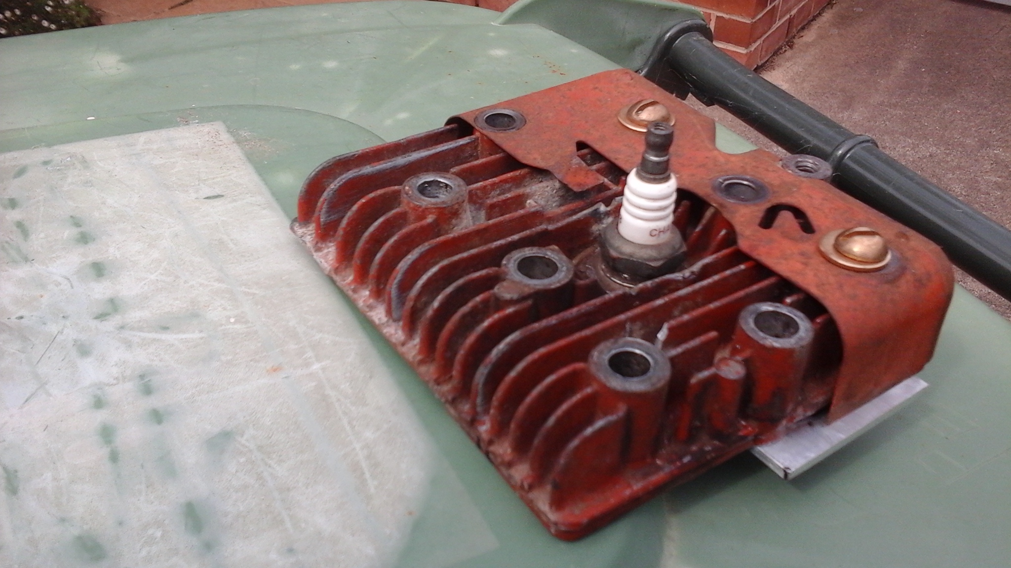

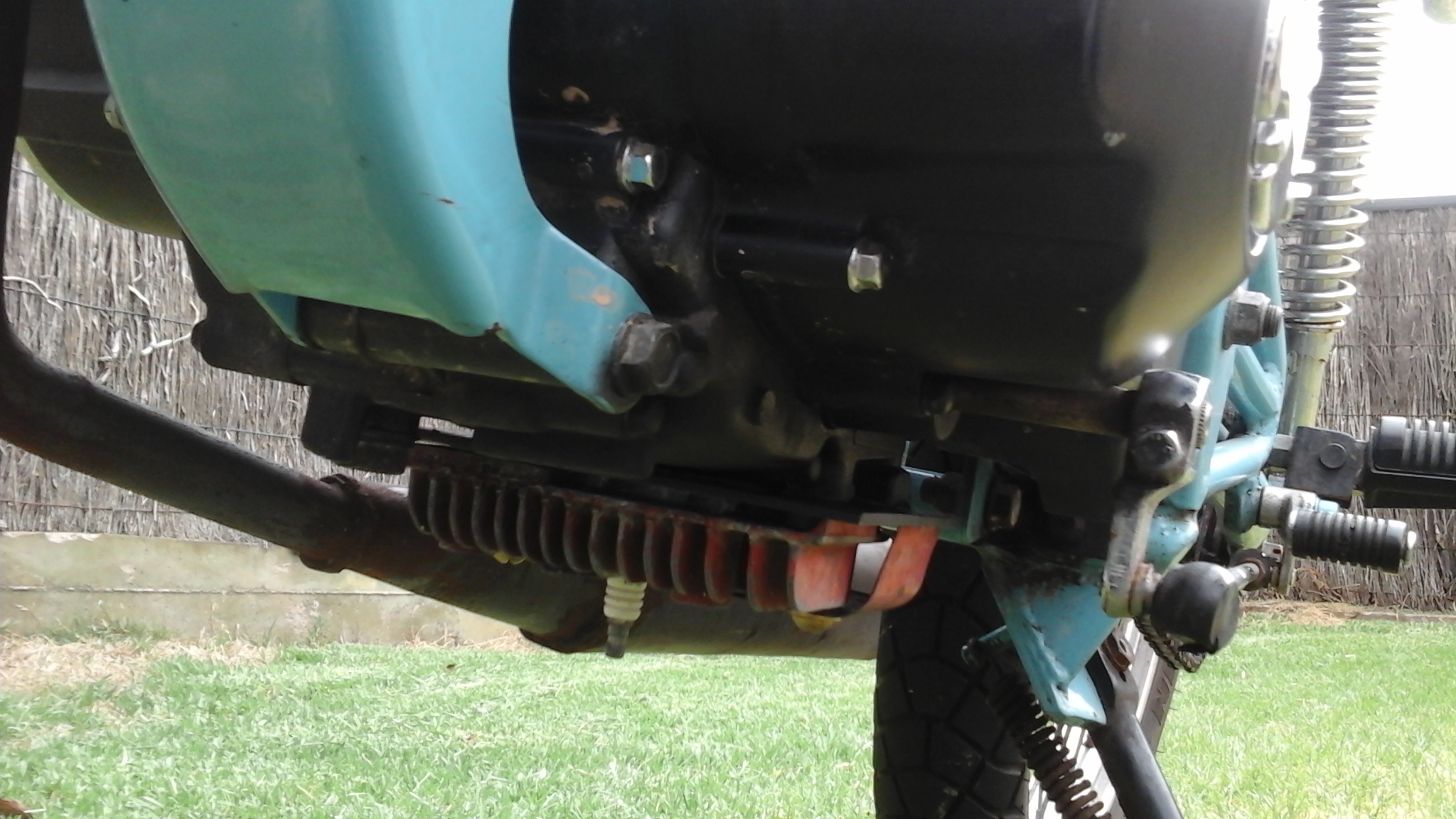

OK .This the latest , 4 × 8mm bosses under the crankcase so mounted aluminium and the bolts go 17mm into tne boss . Riding it and the aluminium gets as hot as the engine ,now the plan was to mount a generous heatsink . Looking for a heatsink and on a garage shelf is a Scott Bonner 45 lawnmower engine with an aluminium head . I didnt need the plug for anything so i left it in .
Hahahaaaaa.. the first boxer twin Ace in the world. Snap an old spark plug lead on the plug & really watch the confused expressions :D
^^^^^^^or when you go to speedweek, tell them you're there to set a new speed record for a vertical boxer twin, bet no-one's set one of those yet
