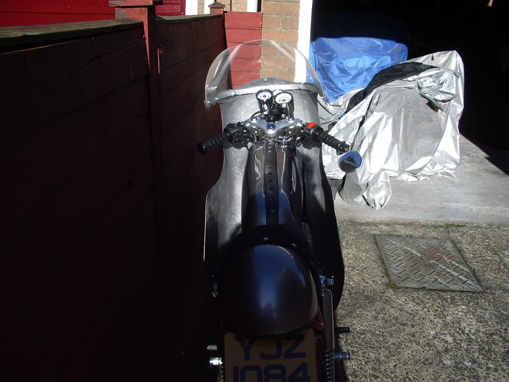

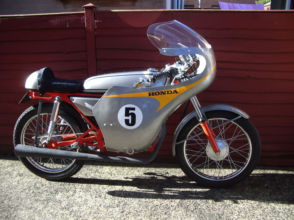

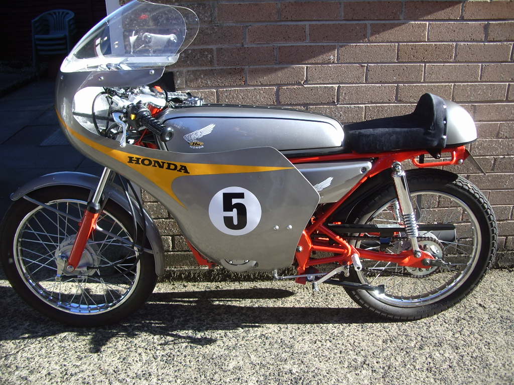

I have finally completed my replication of a 1960's Honda race bike.
I have only done a 144 kilometres on it since I bought it new in June of this year.
The biggest challenge was converting the disc brake to drum. Also getting the fairing to fit.

Hi Jimmy,
Excellent work and bike looks very good. Where did you source your fairing from? Is that a Northern Irishplate on it,or a personal one? Compared to mine, your fairing sits significantly higher, as I have my clip-ons set quite low - & Still find the seating position fine, and I'm 6"3 " !
Did you forego the headlight as I can't see it! With mine, I take the fairing off for the MOT as it is a faff to secure the headlight.

Hi Herbert.
Many thanks.
I bought the fairing from BB Plastics in England. It was advertised to fit a 125 Honda. But it was too small and I had to fettle it to ft. I have my clip ons as high as I can get them. Where did you get your fairing from? Your bike looks class.
Yes that is a Nr. Ireland number plate. I don't have any lights or indicators on it at all, not even a brake light or reflector. I have it on a day light only MOT. For a daylight running MOT we are not allowed lights of any description on the bike.

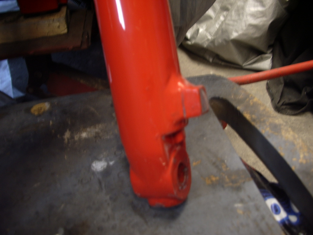

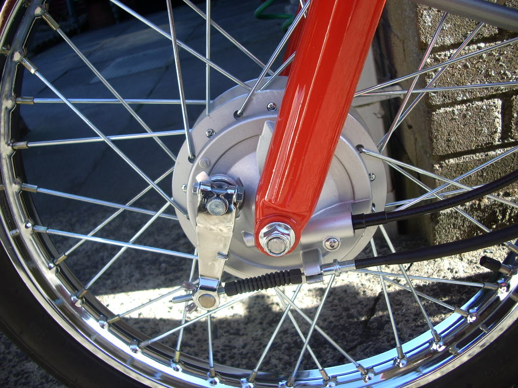

Chopping the caliper brackets off and Painting the forks was the easy bit. I bought the wheel brand new from EBay complete built with drum, shoes and spindle. I then had to find the right brake and speedo cables to fit it. I had to weld an alloy block onto the right fork leg to act as a brake anchor.
Jimmy.

Hi Herbert.
I can't tell if the drum is better than the disc as i have just completed the change over and I haven't had time to get out on it. The wheel is for a Honda CG 125 I bought it off EBay. The guy has still one for sale EBay number 221914835545
