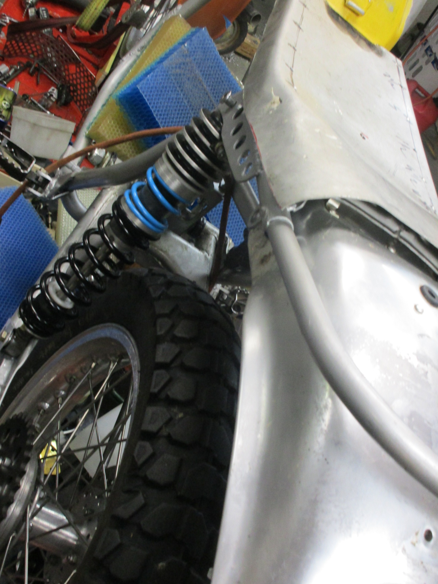

i am going to use the aluminum fr rear sl fenders thu=is fronty one mounted low needs recurving tighter but i like it
the headlight and grill just hanging by wires it would faired in a bit or left open and busy

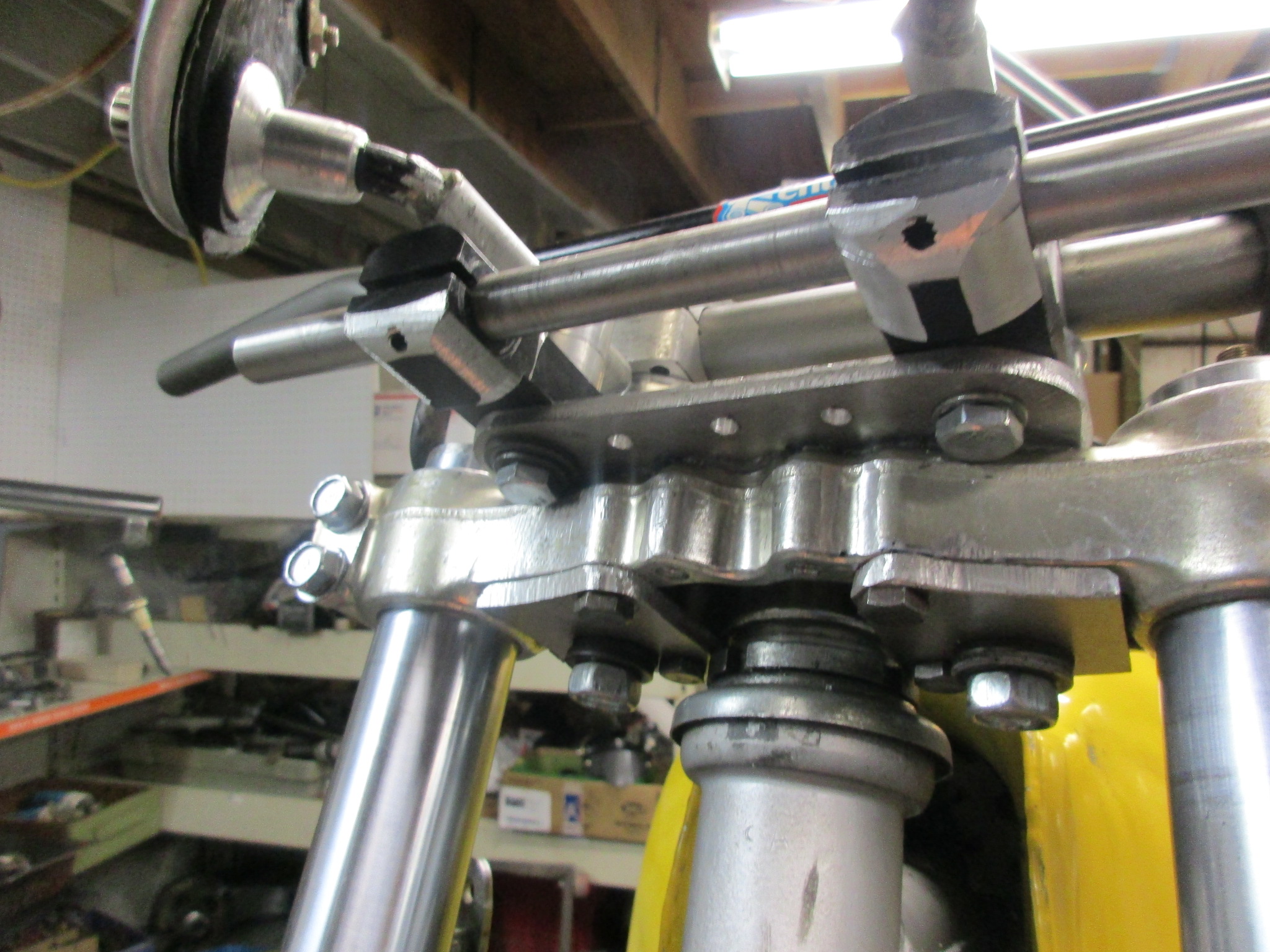

the sl fender keeps growing on me,i love it , i am going to tweek it slightly give it a bit tighter radii and do a mild bit of simple forming on top try to get a 2x3 area perfectly flat ,so it can bolt up sweetly to finalized gap section of the brace
the brace as it is with a 1/4'' top plate added to it just about wants to collide with the lower triple i havent got any room to spare ,see i almost cut too much off the top of the stanchions
but i still need to get the rear tire mounted ,doing that now, so i can set the bike back up level and see if i hit my mark on rake then ill measure trail see where that is

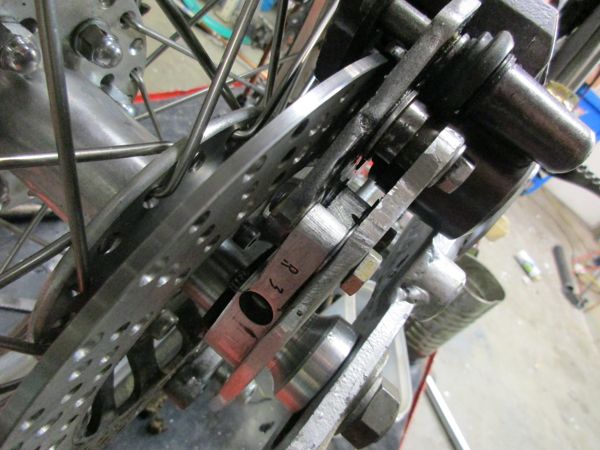

i missed on the rotor doh caliper hits spokes anybody need a pitbike rotor ?

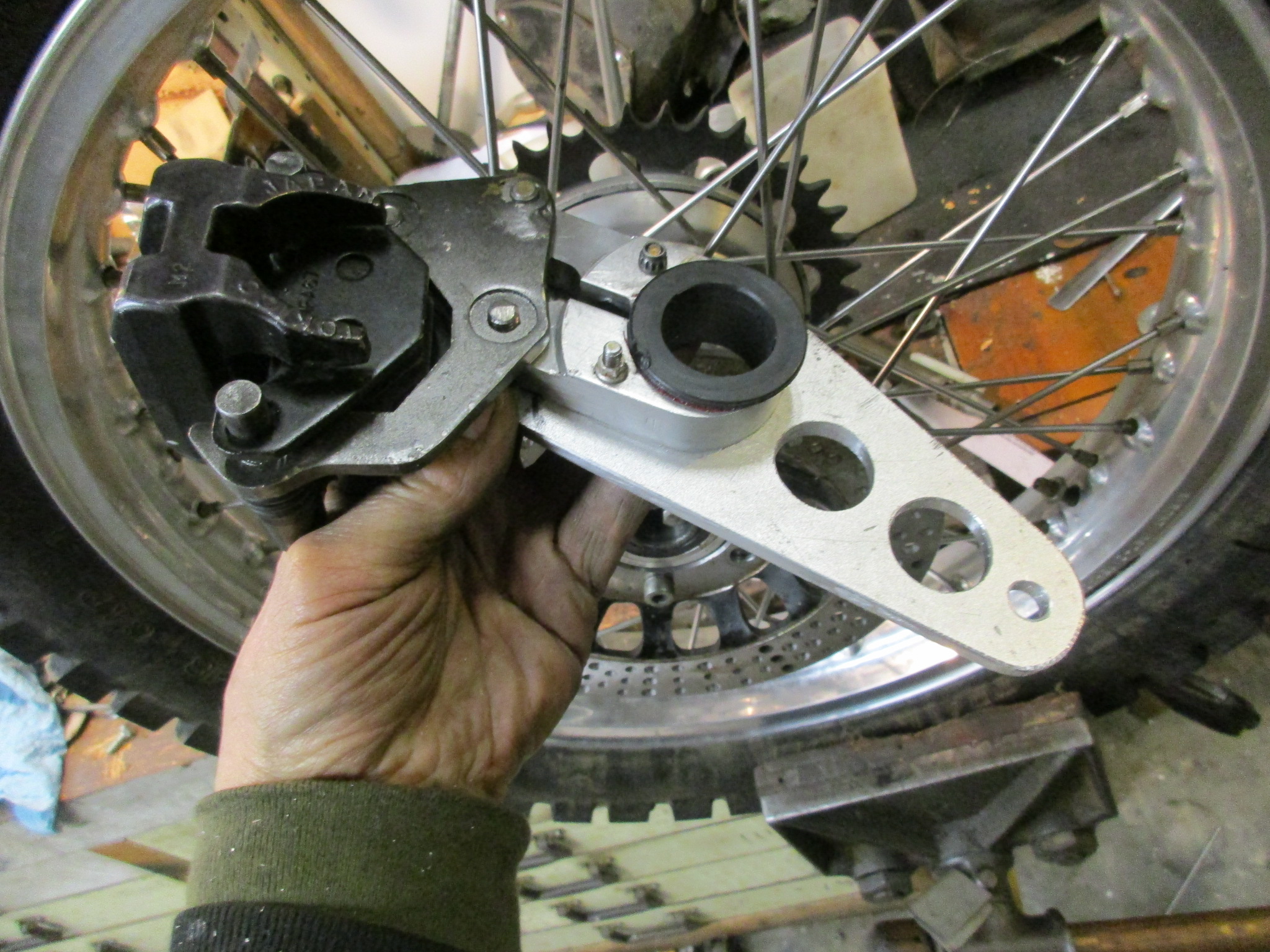

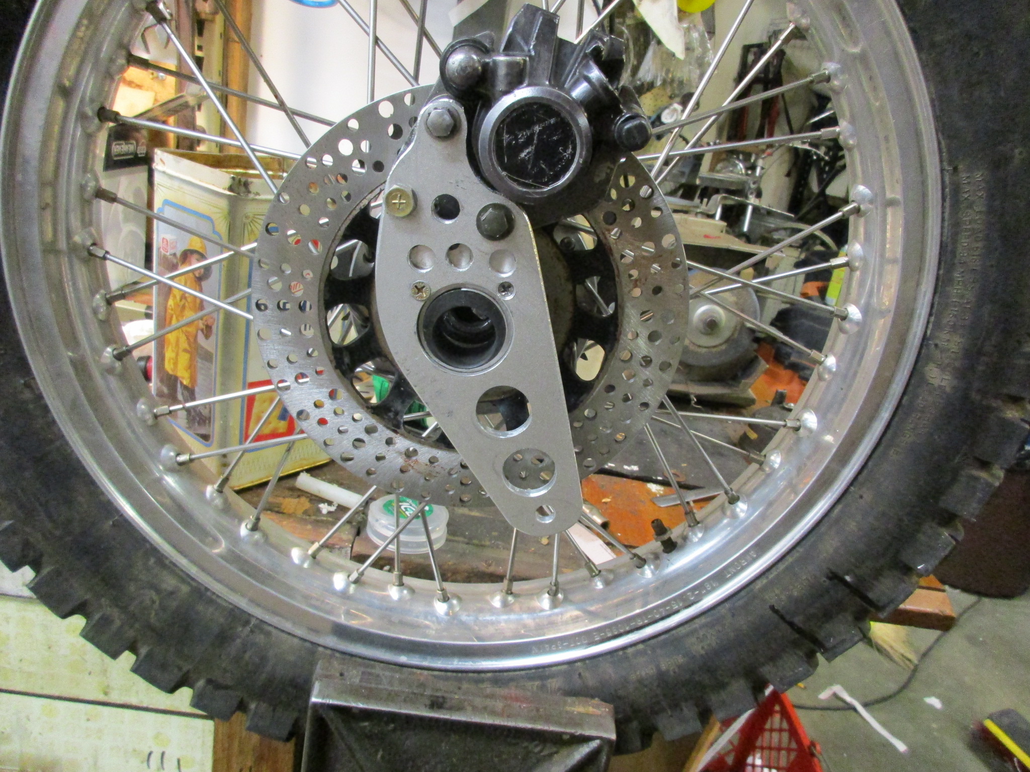

i was not happy with the rear caliper being so vulnurable and not happy that i did not see that i would need to space the china pitbike rotor so clapper and spokes dont make harpo like music
see i had already set it up way back when with the tecate 3 willer rotor it has a nice deep dish to it
i had tried lashing it up with a ktm late dirt model rear clapper and its mounting piece
but good god the diecast clapper carrier plate was gonna put the ugly on :-X it just looks so out of place and i was going to have to design a stout lug to weld to the swinger to stay the clapper
just couldnt do that and still come out ugly so then mounted a kawi clapper that brembo copied they are virtually identical
then i go and mount it pointing down and somebody says " thats vunerable "and they are exactly right so fuck that do it right the 4th time
and i seezed the moment for some speed holes as well
it is a "fixed clapper" so i will need some collars on each side of its delrin bushing that fits almost press tight on the axle spool
