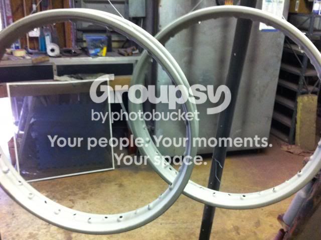

When the chrome is not peeling or rusting through and seems to be in good shape I have my blaster just "dust/frost" the chrome by giving it an acceptable profile without going through the chrome requiring it to be completely removed.
I checked Buchanan's and didn't realize rims were so expensive, I didn't see anything on their site for less than $150. Refurbing your rims by powder coating them would be a bunch cheaper than starting from scratch and building new wheels.
These were "frosted" and coated for $40 each.
Beautiful. Will you be lacing them yourself?
At $150 per rim, $100 for spokes, and $50 for nipples your at $300 a wheel before lacing. I can coat the rims, spokes, and nipples for $240 for the pair of wheels. The prices for new were not for coated parts so plan on even more money to the $300 per wheel price. Buchanan's gets $90 to polish a rim.

No I am not lacing them. These belong to forum member 1sttimer. I did the nipples for him last week.
