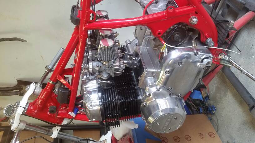

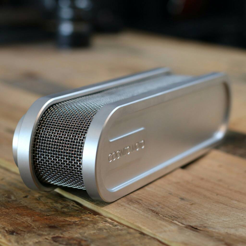

Going to be interesting for me, running pods in a cb750 that's now an 811 and a 4into1 motogpwerks pipe. I know cognito has a really nice filter that goes over all 4 carbs. I don't know much about airflow buy maybe it will give a more even air flow because of its design? Pricey at $230 but it's re-buildable

That Cognito box looks nice, very similar to the Steel Dragon breadboxes. I had the SD box on for a couple rides on my CB750 before I pulled the motor, seemed to be a little flat through the middle of the powerband (though I didn't take the time to really tune it before pulling the motor out)
