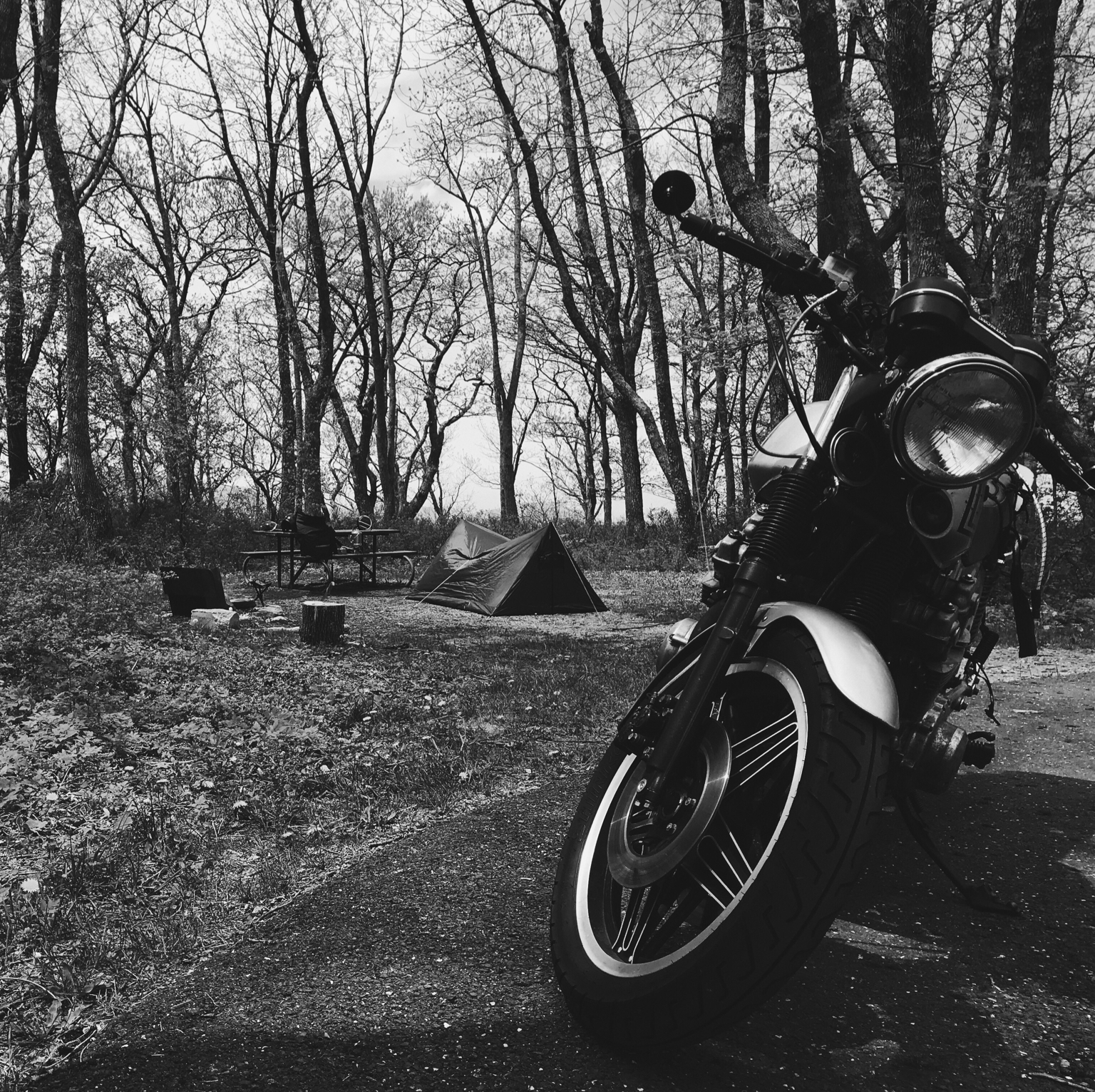

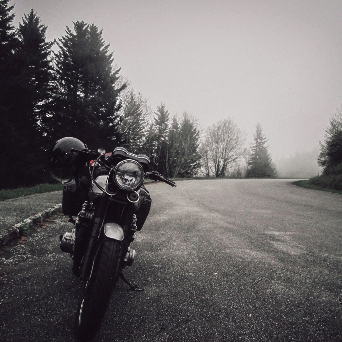

Here’s a few more photos. The last one is where it sets now, at the shop. Btw, if anyone ever goes through Richmond be sure and check out Engine and Frame. They have a community garage with anything you need.
