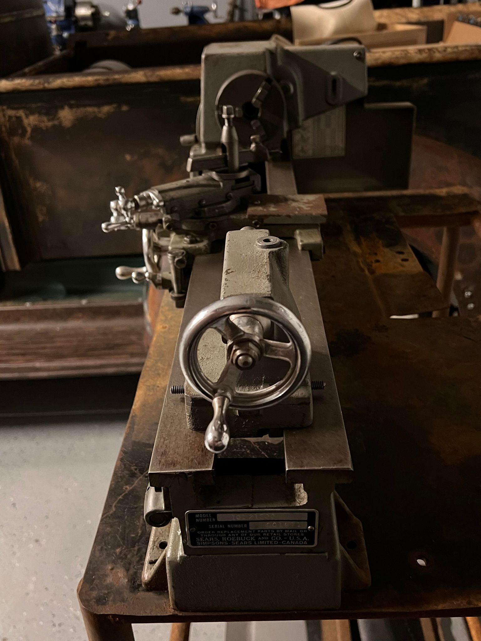

An Atlas Craftsman 6" Lathe Non Restoration

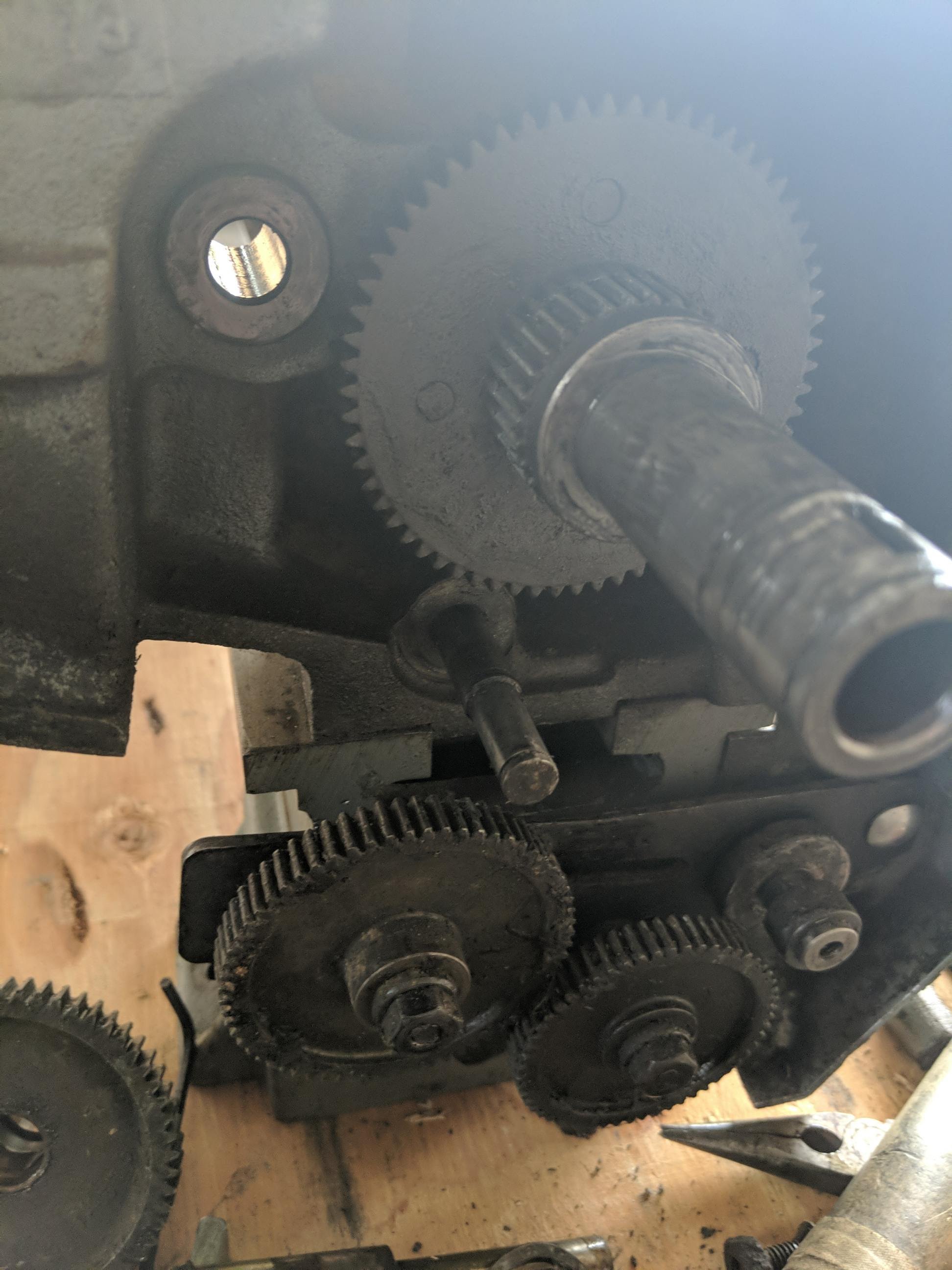

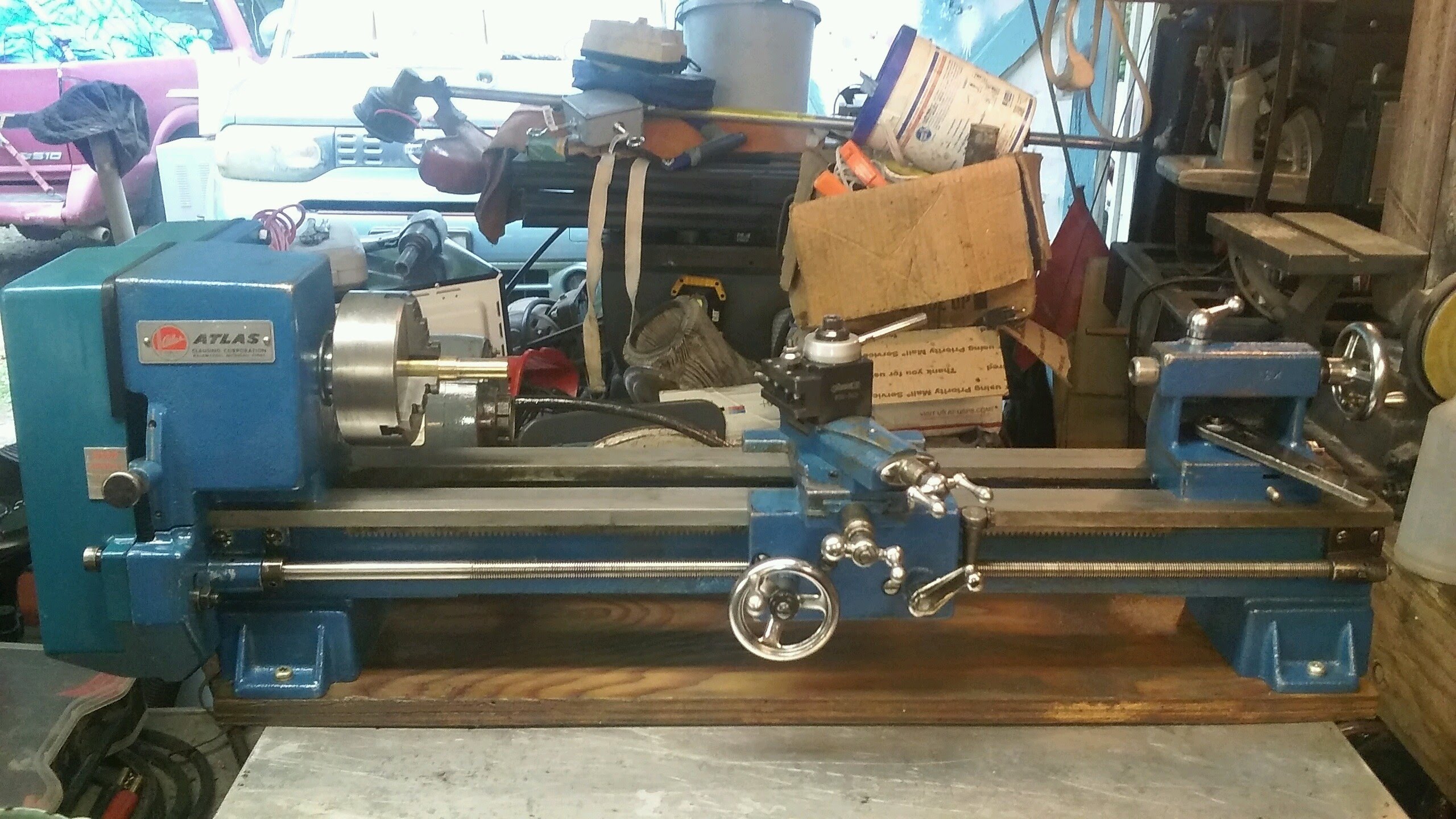

Okay , it runs. but wait there's more.
@gggGary , thanks for part of the solution.
The belt is crap or has a couple of flat spots on it. Back off the tension so far you can't put a tool into aluminum and it runs fine. give it any tension at all and it's a bucking bronco.

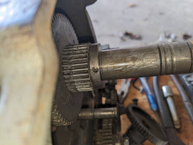

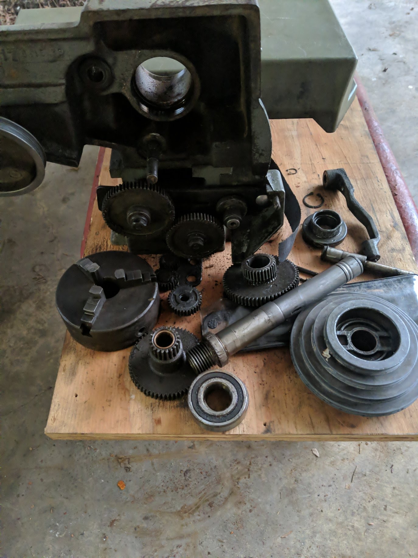

Interlude for some good news. The time I spent on the gears paid off. There was so much crud in the root that there was no way to get close to a mesh. Razor blade, caustic chemicals, miniature files, multiple teeth breech, wash, rinse, repeat.
The gear train is nearly silent.
More good news. No detectable axial or radial slop, none, and very little heating.

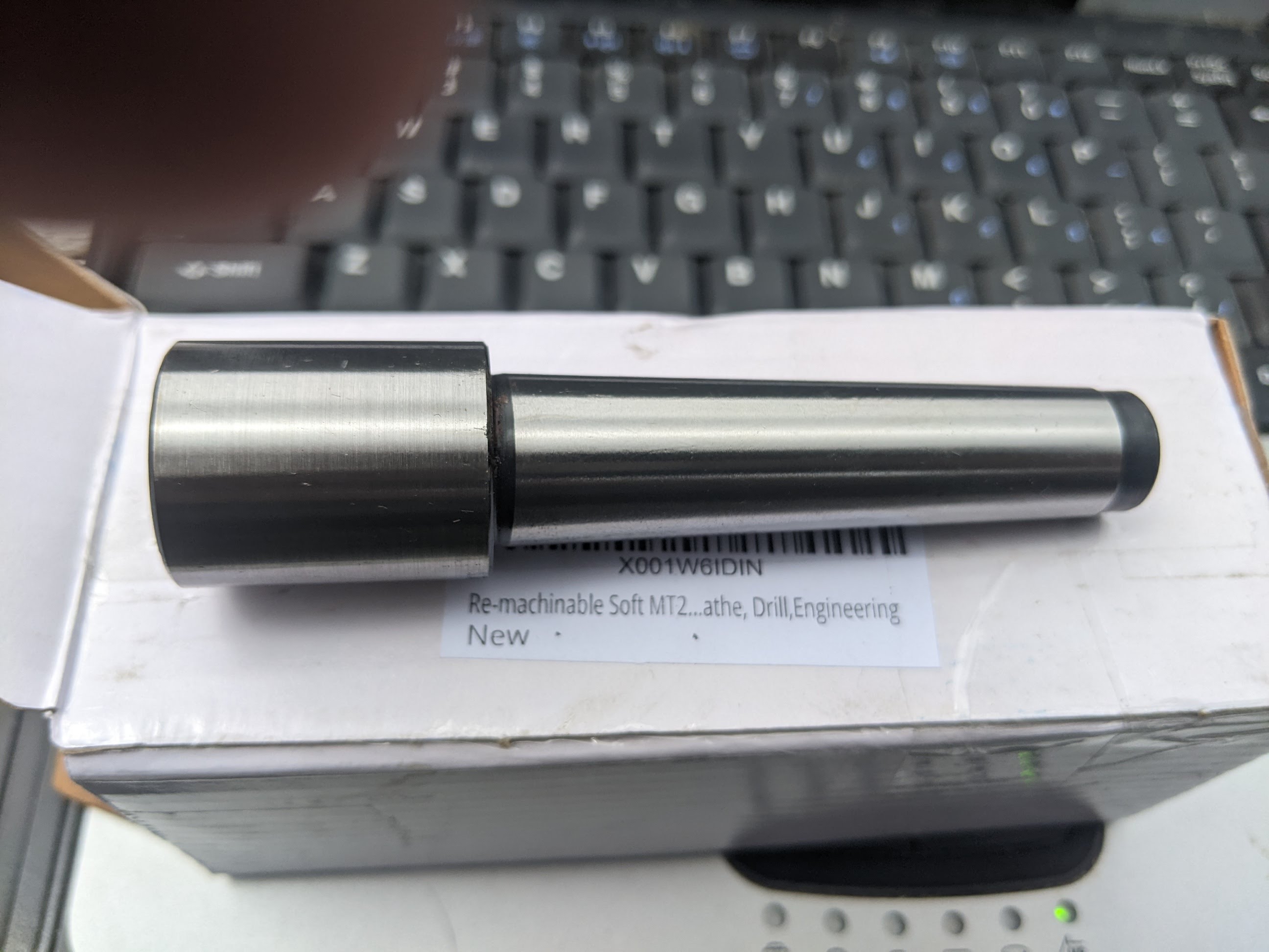

The reamer set I received from the AmaZombies. looks good.
I tied the roughing an finish back to back with each other and , parallel.
I did the same with a known good 2MT taper and, parallel.
So far so good.

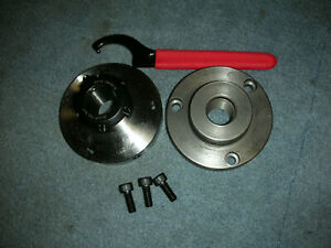

Once I counter bored a register in the chuck
The rest was easy, The damage was beyond abrasives and a careful dial in of the register allowed for a .002" skim cut on the diameter and face.
