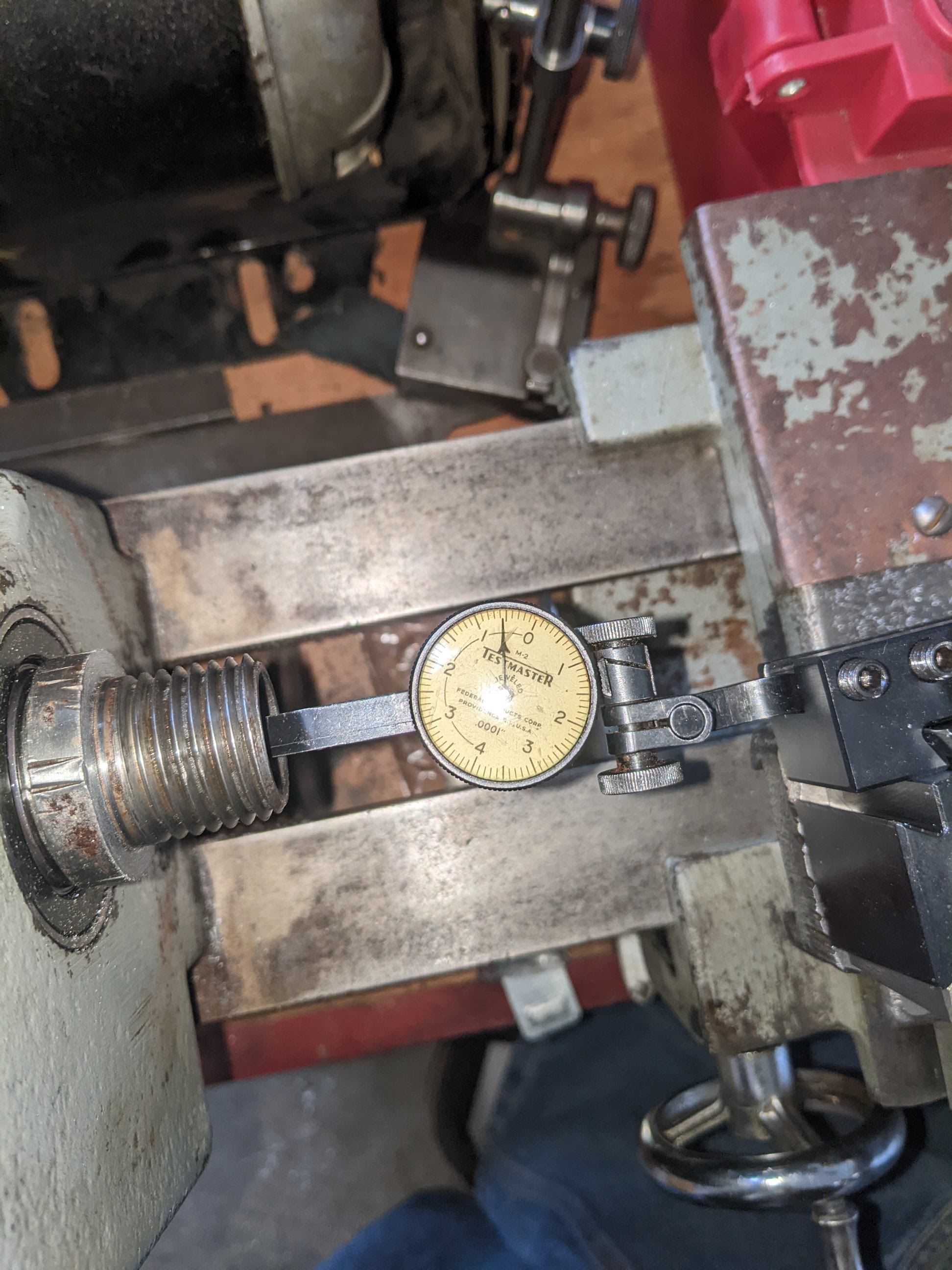

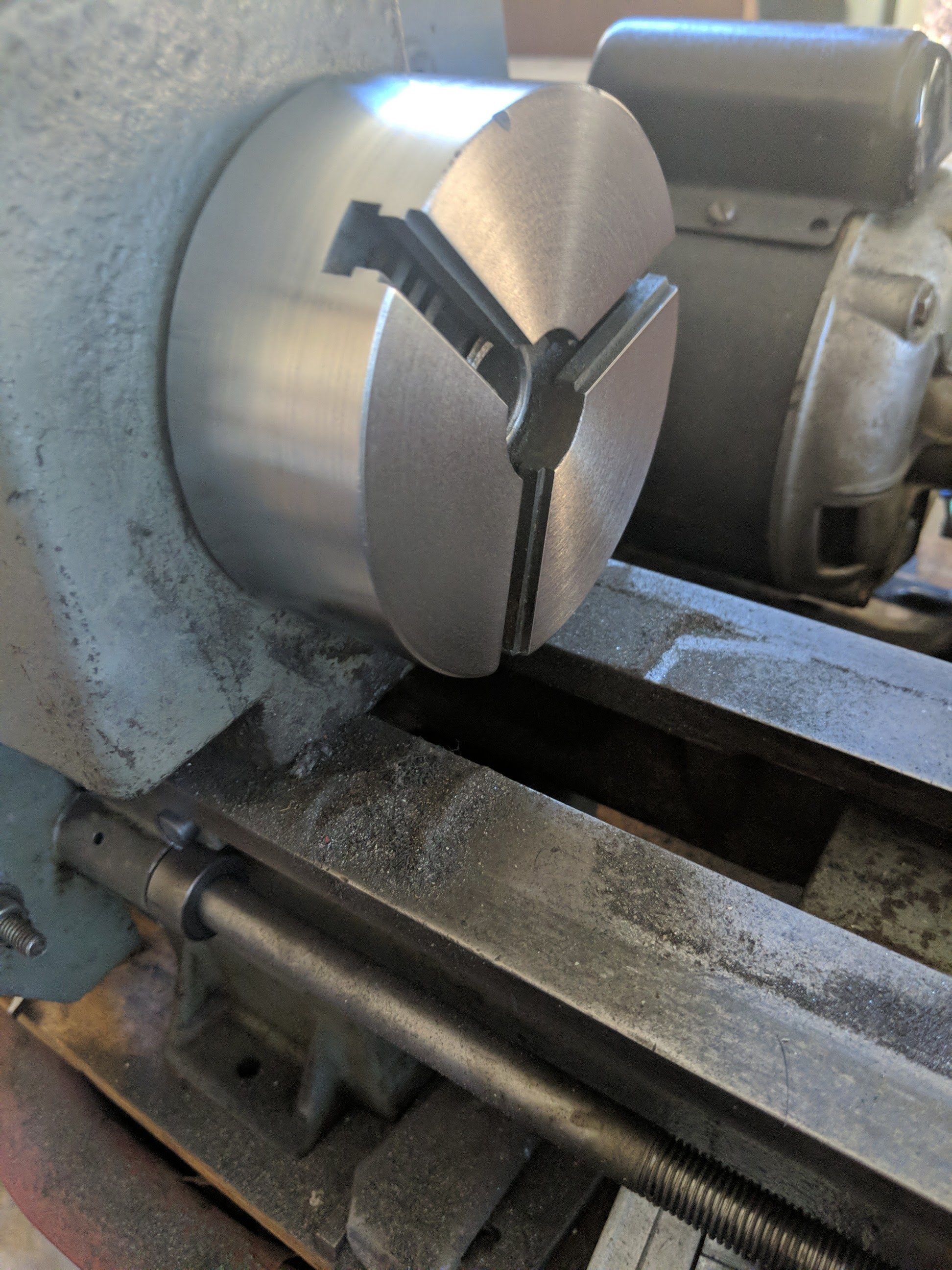

The spindle may have near zero detectable run out between the bearing surfaces but the register for the chuck is messed up. Not only that the 2MT taper in the spindle is corroded.
A super sharp piece of 5% cobalt HSS reestablished the face but there is little that can be done for the 1.375 outer diameter. Neither of the chucks I have make use of the specified 1.000" dia register so I have to make do with the face . I'll include the pdf.
It appears I have a ways to go before I have a tool I can use. For those of you that might suggest...
No, I could turn between centers right now if I took the taper out but that gets old real fast.
I'll suss out the damaged 2MT in the spindle bore this weekend. The reamers are on the way.
Then I have to decide which center to go with, the register (and which chuck, 4 jaw , duh) or the spindle ID .
it's 11:45 pip emma out here on the left coast. I've done enough damage for one day.

The reamer set I received from the AmaZombies. looks good.
I tied the roughing an finish back to back with each other and , parallel.
I did the same with a known good 2MT taper and, parallel.
So far so good.

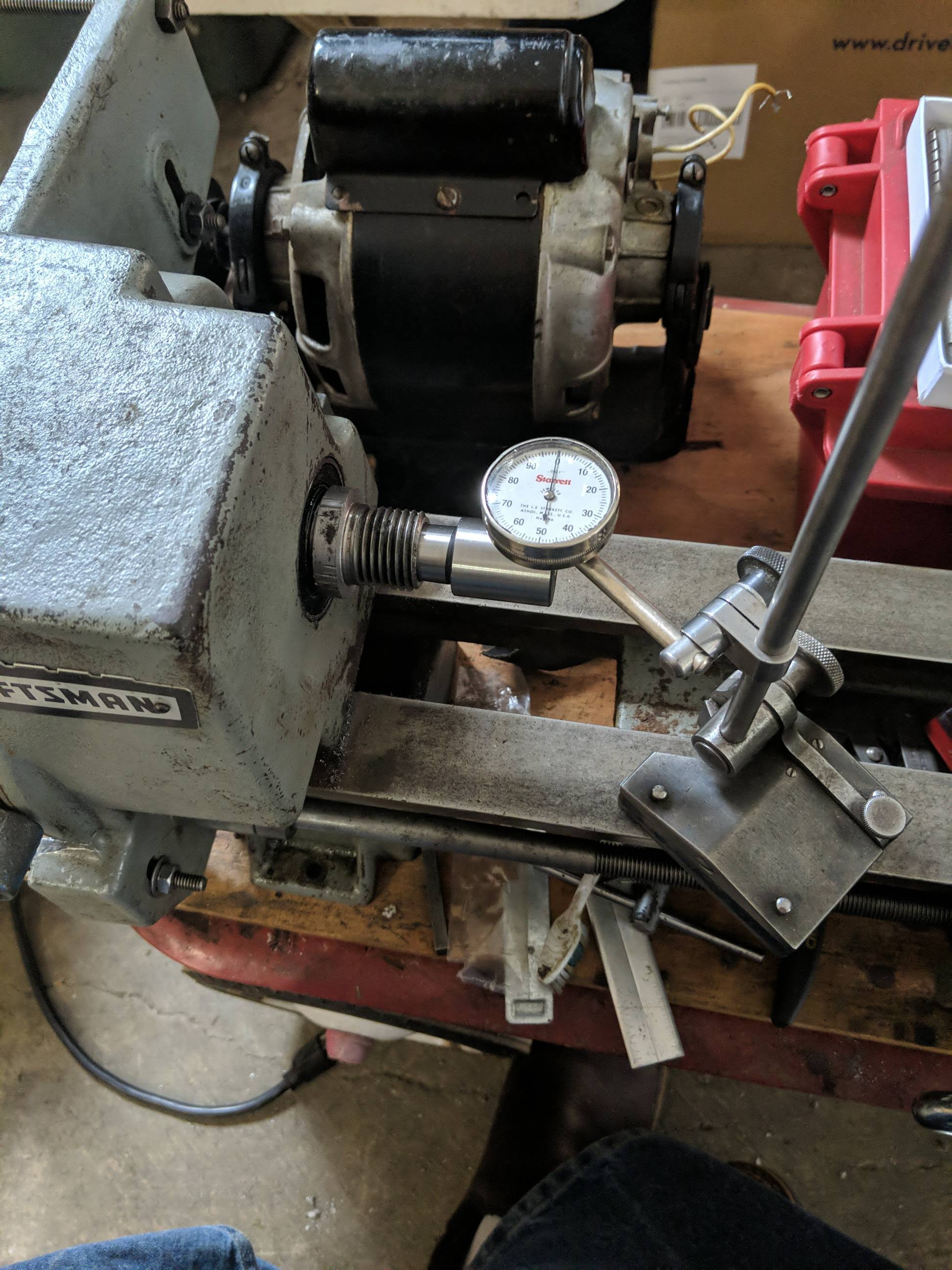

Now to dial the face register and the 2MT taper and record the run out. The face should be zero after a skim of the face. The 2MT taper will have to be cleaned up prior to indicating.
Then the options.
Move the 2MT taper. This is actually the easiest as the reamers both have a rear center.
Simply offset a center held in the tool holder or offset the tail stock the amount of radial run out , lock the spindle and advance the reamer.
Move the face. This sucks as anything done to the face other than perfectly perpendicular to the axis is just brain dead and would work only with that specific accessory.
Face to face chucks. Where you install a chuck on the spindle and true a shaft to it no mater what else is going on.
Place the other chuck on the shaft with its jaws facing the installed chuck.
Reproduce its angular misalignment on the shaft and verify by indicating on it's register.
if the misalignment between the OD of the chuck, the registration face and to a lesser degree, the "natural" center in the case of the scroll chuck agree, The spindle is bent.
If the register does not agree with the OD or the "natural" center in a scroll chuck but the "natural" center do agree then straighten the register. (what a bunch of words)
The four jaw is easier once the three jaw is close. Get the run out and angular distortion out of the shaft. resort to the cigarette paper trick for out of round, tap to center for the live end.
Install the 4 jaw on the shaft exposing the register. True up the OD for run out. indicate the register. True up the register if necessary.
Wash , rinse , repeat, until this becomes a repeatable operation. If it doesn't , run around in circles (isn't that what we've been doing?) screaming "Murphy!!! WHHHHHHY Me !!!!"
Then it's back to the internal taper and making it agree to the total indicated run out ( hopefully near nil at this point)
If not then it's easy enough to move the taper a "few" thousands.
and so it goes
Once I counter bored a register in the chuck
The rest was easy, The damage was beyond abrasives and a careful dial in of the register allowed for a .002" skim cut on the diameter and face.
Avery brief vid of the machine reveals the work on the gear train was well worth it. Just imagine inspection of every tooth and root of every gear in inventory. Imagine "blueprinting" of every spacer, bushing and keyed spacer. Imagine spending hours sorting out a banjo bracket that had been attacked by the flying monkeys with hammers. Then it was the lead screw alignment including centering on new half nuts to the point where there was full engagement without deflecting the lead screw and full disengagement.
It was worth the effort.

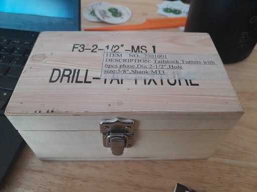

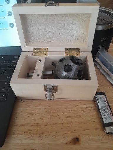

new tool.
Good to hear from you Peter.
Is the cell phone working?

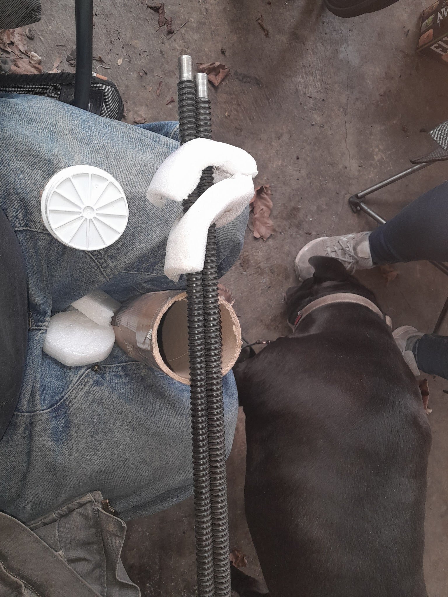

UPS tried to kill the ball screws. Good packaging saved them.
Waiting on the ball nutz.
