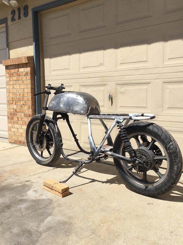

Been working on mine some when I have time. The original tank I had was rusting some on the inside..I didn't realize how bad until I started stripping the paint and I realized there were rot pin holes developing. Seemed like it was going to be more hassle than it was worth. The oem tank also didn't have the clearance on the bars and forks I was wanting. Oh wells! I ended up going down to Ty's motorcycle salvage, which is conveniently 5 blocks from my home. I gave him the Benelli/Harley 250 parts I had acquired for free in exchange for some credit. I ended up getting a Honda cx500 tank that was completely straight and rust free. It had a shape I could appreciate so I relocated the front tank mounting points and it seems like it will work out. Still need to sort out a rear mounting point. I also welded in a filler plate to smooth up the back of the tank. I'm sure I'll get a talkin to from someone about not having "the right tank" on it. ::)
I also didn't quite get the right length on the rear loop the first time I did it. So I shortened it up a little bit and welded it on. Think I finally got the right shape to the frame now. Going to build a seat pan and figure out some mounting points for it. After that I'll be moving on to primering/painting the frame, tank, and a few misc items.
Re: An odd one. 82 kz750r1. Brat cafe.
So.. how much space between that loop and your tire ? Is it just the angle? The one you referenced has a kick up in rear.
The first picture it was not welded in place. It was on the frame lugs and taped in place. :P
There is about 2.5 inches between the tire and bottom of loop.

ouch, not a good idea.
You'll be rubbing your tire against the hoop.
Remember that 2.5 inches will already be down to 1.5 inches onces you sit on it. Then that 1.5 inch has to withstand speed bumps and pot holes and acceleration. :-X

The shocks aren't original to the bike, and the spring rates are way stiff. With my wife sitting on it, and me jumping up and down trying to compress it I can't get the rear end all that close to the hoop. They're also 12.5 inch shocks. From what I've read the stock 82 KZ750R1 / GPz750 length is 13 5/8" and unsprung length is 14 3/4.
Couldn't I just run the factory length for a little more clearance?

Altering the original frame geometry by changing shock or fork lengths will change the handling. Sometimes for the better, more often for the worse, even dangerously so on some setups. Getting proper rear loop to tire clearance by changing shocks is not the way to do it, especially if the shocks are sprung wrong in the first place. One way to check clearance is use a ratchet strap, remove one of the shocks and then compress the tail with the strap until the shock bottoms out. If you still have any clearance after that, you are golden, if not, you'll end up hitting the loop at some point.
If it was me, I'd get some proper rear shocks at the right length and spring rate, then deal with fixing that rear loop with a kick up as it really looks like it would help on your bike.

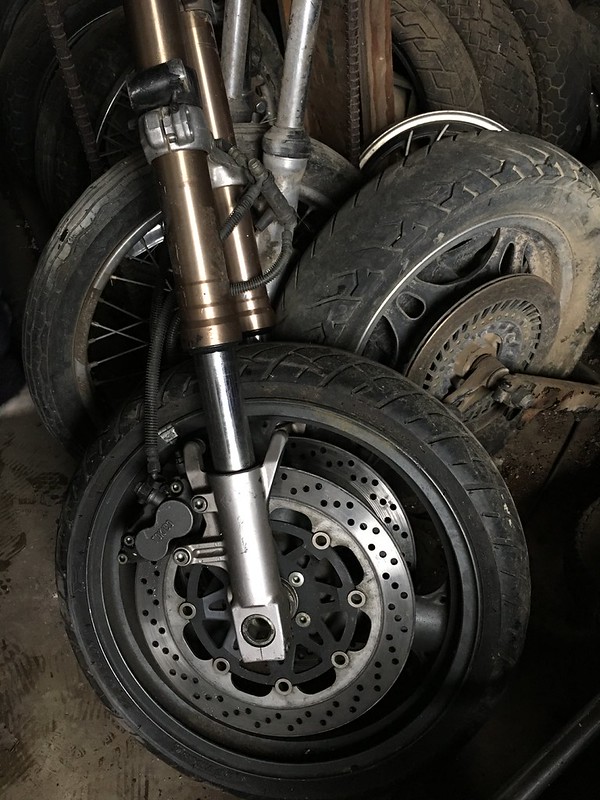

Couldn't turn down a good deal on a zx9-r front end. Going to change out the front tire for something that's not a 60 series.

I helped a friend "un-fuck" a kz750R1 a few years ago, I can confirm that even with the stock shocks a straight hoop will rub the wheel, as the previous owner found out when he ripped his whole fender off. We welded in a new hoop that was about 2 inches taller to clear the wheel. The rear wheel moves more than the shocks travel. The only way to reliably determine if it will hit is to remove one shock and then use a ratchet strap to compress the suspension till the remaining shock bottoms.

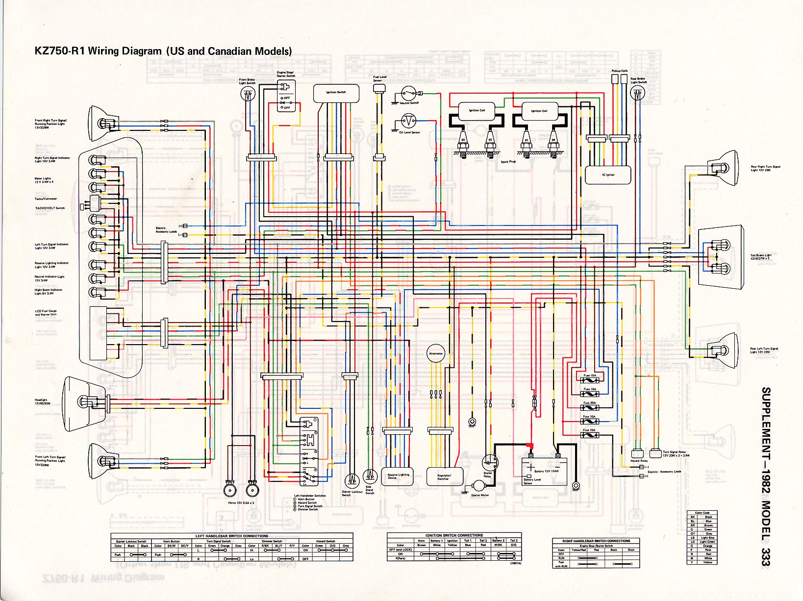

In the process of electrical work. The alternator-->rectifier wiring was previously hacked up pretty bad for some reason. I know I need diodes in the system, and I quickly glanced around for them and didn’t see anything. Where do they live? Sort of integrated near the windings inside the alternator case?

the wiring is real simple, just 3 yellow from the alternator to the r/r, those triangle/square symbols show bullet connectors, not the diode symbol.

That's the exact same diagram I've been using. Makes sense that those are bullet connectors, makes the alternator replaceable without cutting/splicing things. And if that's the case, what is the symbol for diode? I'm looking over the diagram and not seeing any. :P

there are no diodes in the stock system. the diode symbol triangle points to a line, where as these point to a box.

Great! Thanks so much for the info there, saved me quite a bit of head scratching. ::)
