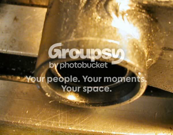

I'd originally meant to cut to the scribe (again, cutting corners) but luckily reason got the better part of me and I ground a piece of tube to fit inside nice and snug, tapped it in, set the depth with a micrometer and locked it in place with a grub screw.
Kill Kill KILL!! Yeah so here's where it gets hairy for me. Hacking off the pivot is no big deal...it just needed to be gone.
However, eff up here and the rework gets troublesome. It's easy to take off metal...not so much to put it back on. But..in the end it went really well and fits the bike nicely. I have a buddy who's business is precision grinding. That's all his does and they do it really well. They are handling my swing arm pivot which will be ground 4130 tube, heat treated to suit and threaded on both ends for castle nuts. I can't claim this brilliant idea...one of ours here had some axles made in the same way for his XS650 and I just ran with the idea..
