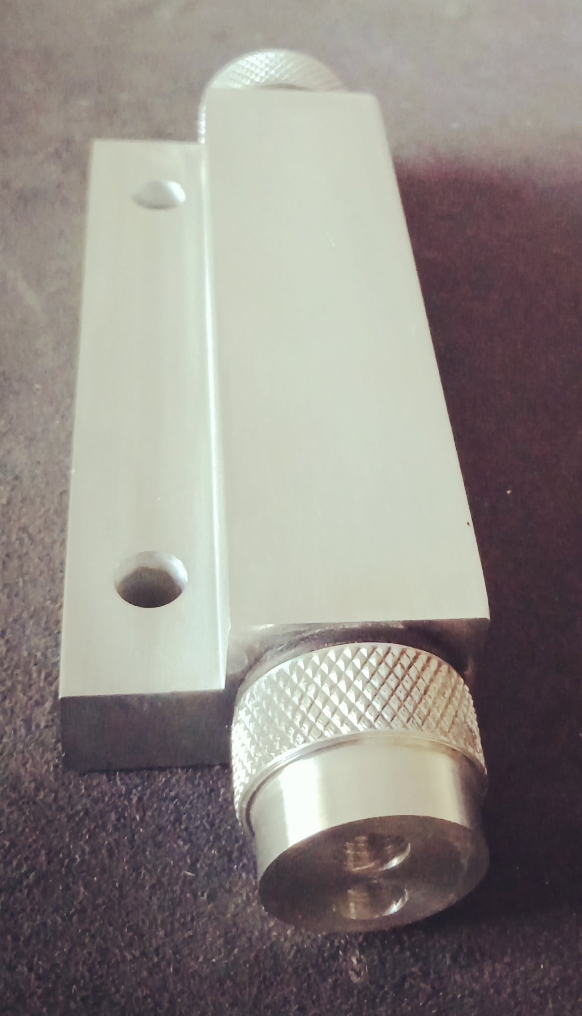

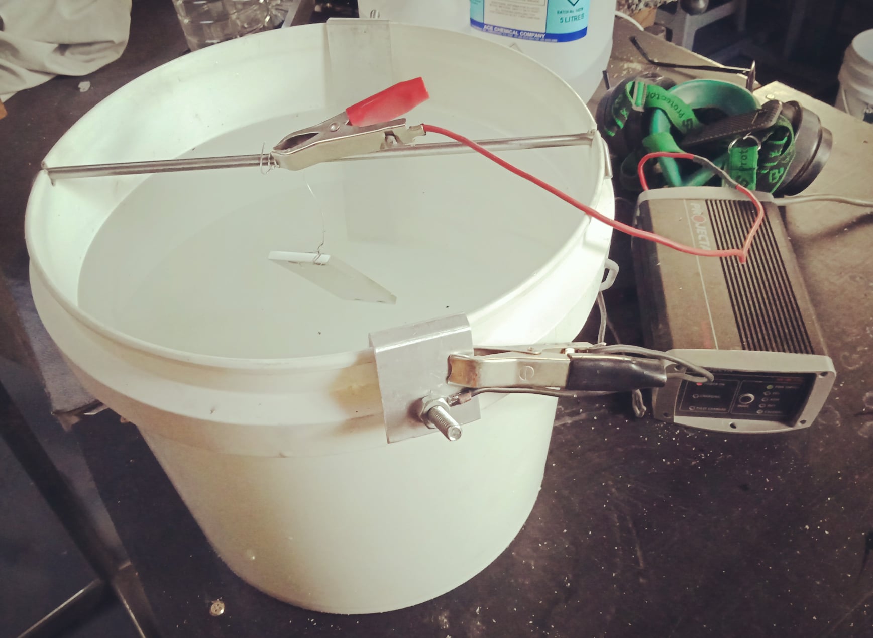

I recently made a cable splitter,, but because it's mounted under the tank it's difficult to get to to polish. So, Ii decided to anodise it. Anodising is not difficult, there are a plethora of websites explaining the process, so you can either buy a kit or do as I did and set up your own. I already had some parts, a heavy duty plastic bucket, a battery charger/power supply unit and some aluminium for the cathode. All I had to buy was some acid, some demineralised water and some acetone.
Once I'd put it all together, I assembled the splitter and blocked the cable holes because I didn't want the bore anodised. I thoroughly cleaned the part with soap and water and acetone, diluted the acid, connected the power supply, immersed the part in the bath and switched on. This is the result.

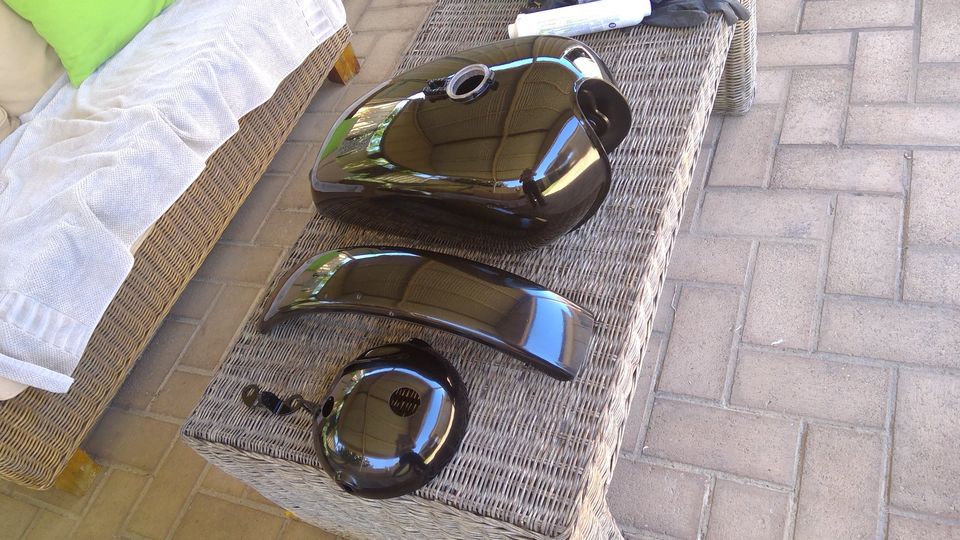

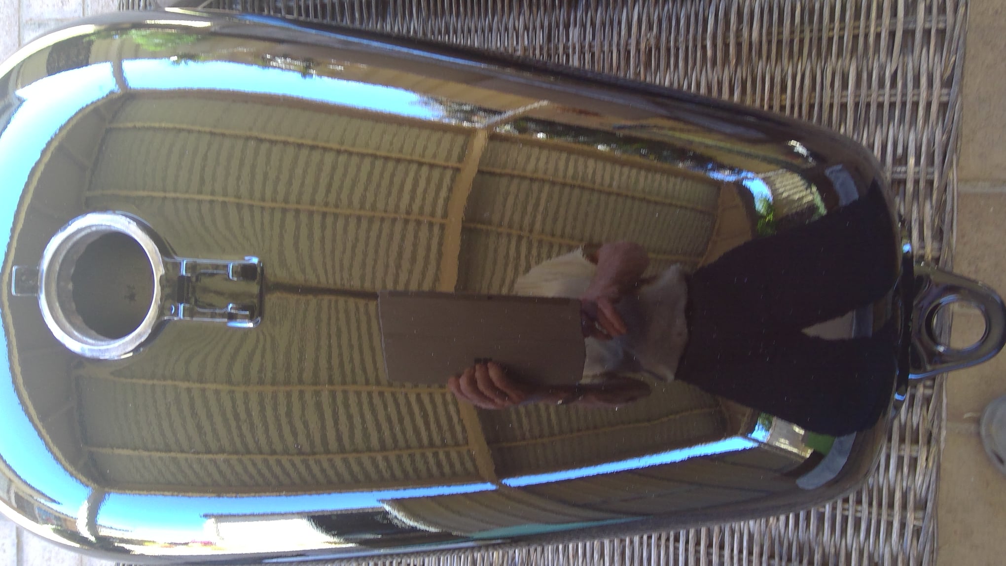

Tank and a few other bits done in acrylic lacquer. Haven't bothered to polish year as no doubt I will get chipped and scratched before it's finished and I'll have to paint it again.
