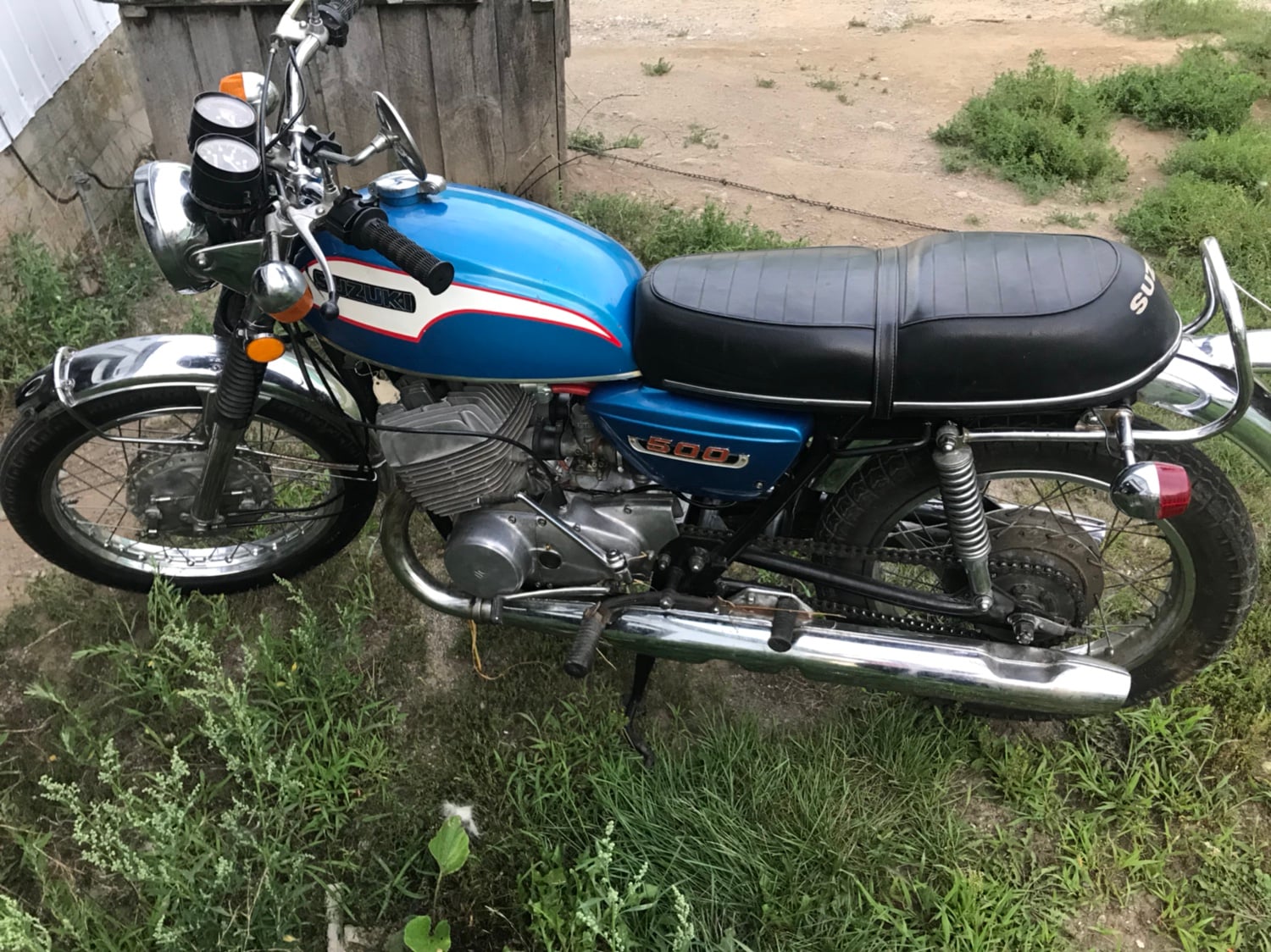

Thanks Quebec...farmer92 said:So now that i’ve got the electrical bs sorted, i need to track down which oil line is leaking 2t oil onto the top of the cases.
It looks to be coming from the pump side of things. Does anyone have a good source for plastic washers and m6 banjo bolts?
Hurco550 said:I ran stat-o-seals when I restored my gt250. a little pricey, but they work a treat. I ordered mine from mc master carr, but there may be a better/cheaper source for them up in canadia..
https://www.mcmaster.com/stat-o-seal-washers
farmer92 said:Do you know somewhere that would sell the bolts and/or banjos?
farmer92 said:How would one wire a kill switch to the points ignition? Ground out both of the points i guess?
Sonreir said:That will work, but the preferred (and I think easier) method would be to place a switch in between the orange wire that feeds power to the ignition coils.
So cut the orange wire and put a switch in between the two cuts. You'll probably want to run some extra wire up to the handlebars or something similar.
