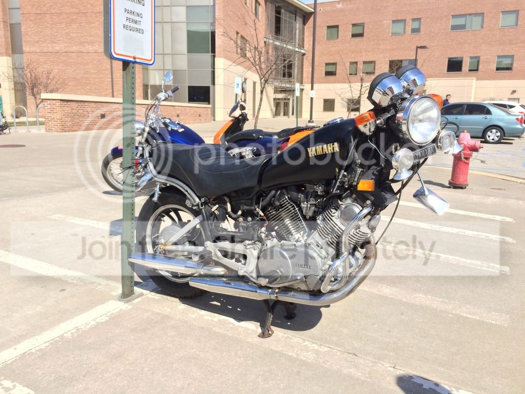

Here are some pictures of the bike the day I got it...picked it up off of eBay for a decent price for a running bike.

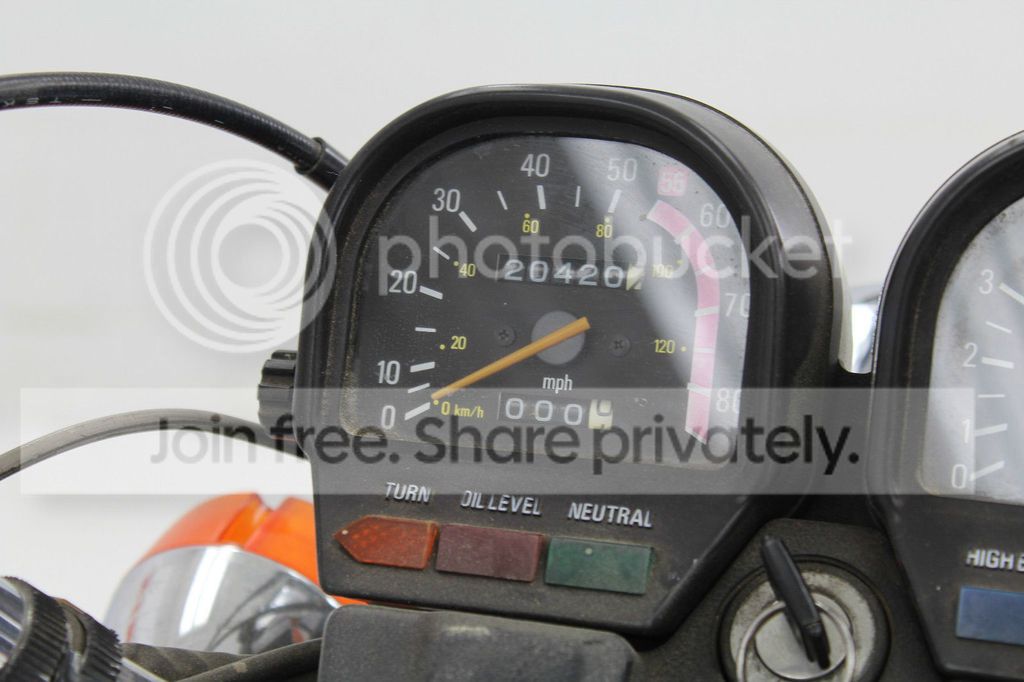

It's "only" got around 20,000 miles on it, and came with aftermarket head pipes, and stock Harley Davidson slip-ons.

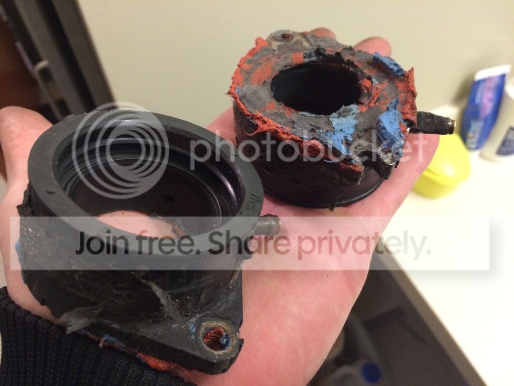

First thing to do was order new carb boots - these have definitely seen better days, and were very boogered up with RTV.
