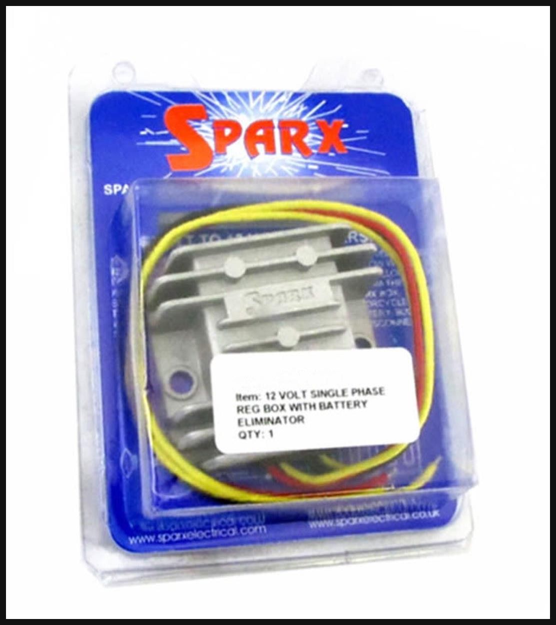

Thanks for the all the info! Has anyone tried the Sparx Battery Eliminator W/Capacitor? Though I'm keeping the SR-250's electric start, and thus will still need a battery, this Sparx unit looks like it may be a better choice than the original 32-year-old regulator and rectifier. Any opinions appreciated!
