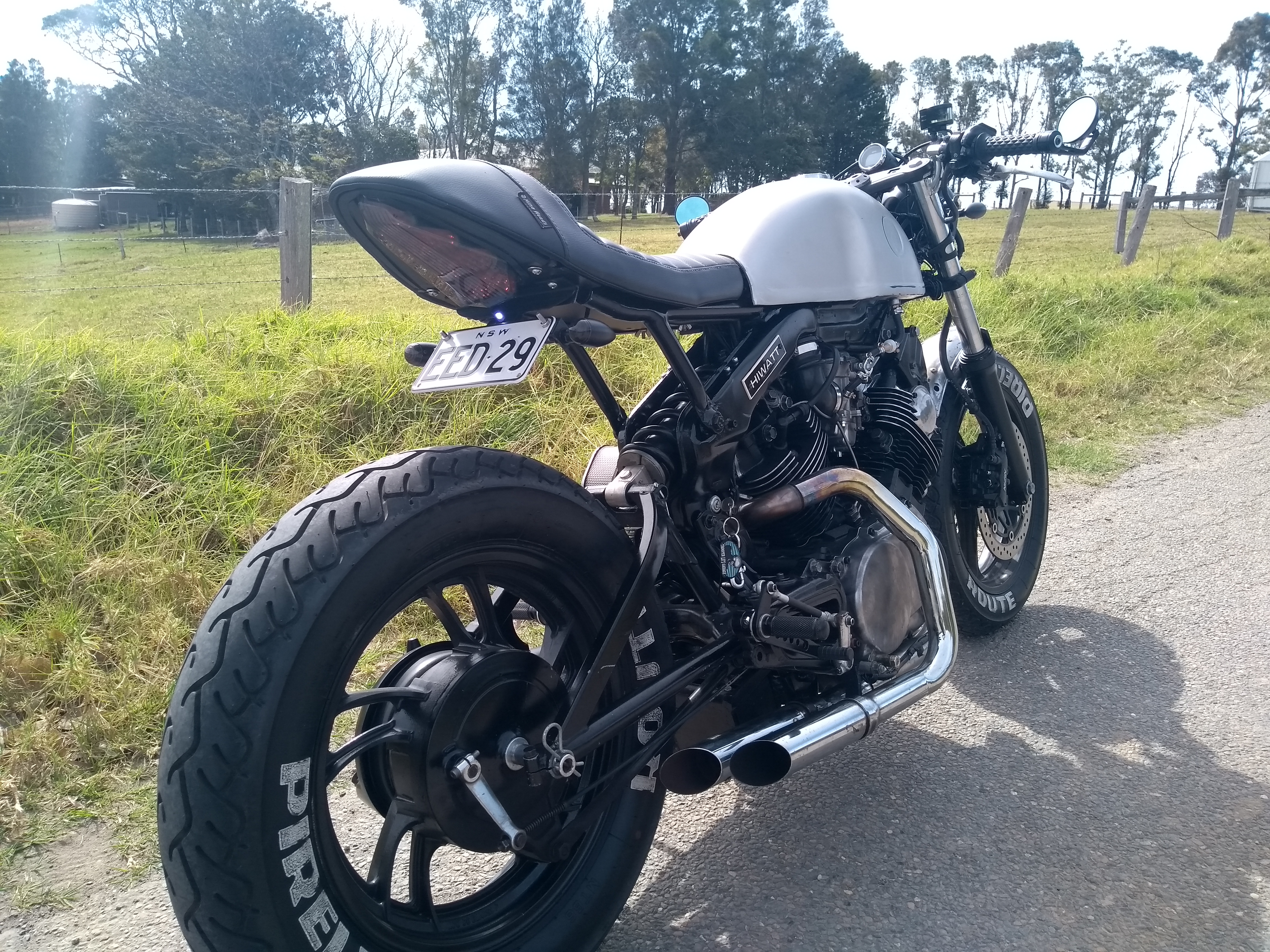

Still here and in 'open the borders up' Sydney. Elbow deep in my 1981 XV750 for a few months during Covid lockdown until kids sport started up which took up most of my weekends. Now winter sport is finishing up for the year I'm looking forward to getting stuck back into the Virago rebuild.
Thanks Brodie, she's come up alright! List of stuff.........
1983 Yamaha XV750, .50mm Yamaha OEM O\S Pistons
2003 Honda CBR1100xx 43mm Showa Front Forks/Wheel, Callipers, Discs, Clutch Lever, Rear Shock
2001 VTR1000 Master Cylinder, Switch Blocks, brake lines
Russell Tingate Clip ons
1982 XV1000 Custom Exhaust
1967 Benelli Mojave replica petrol tank
Nitro Heads seat
Hand made custom rear subframe
Yamaha R6 tailight
Hand made rearset linkages
Ebay headlight, rearsets, LED indicators, GPS speedometer, bar end mirrors,
1981 SR250 Cut front mudguard
Custom made battery box
1982 XV1000 LHS cover, starter gears, starter motor
Slinky Glide Clutch Cable
Pirelli Route Tyres
Kohler Air filter
Custom lengthened steering stem
All Balls steering stem bearings (custom sizes)

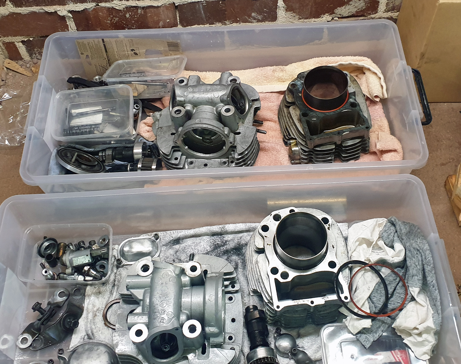

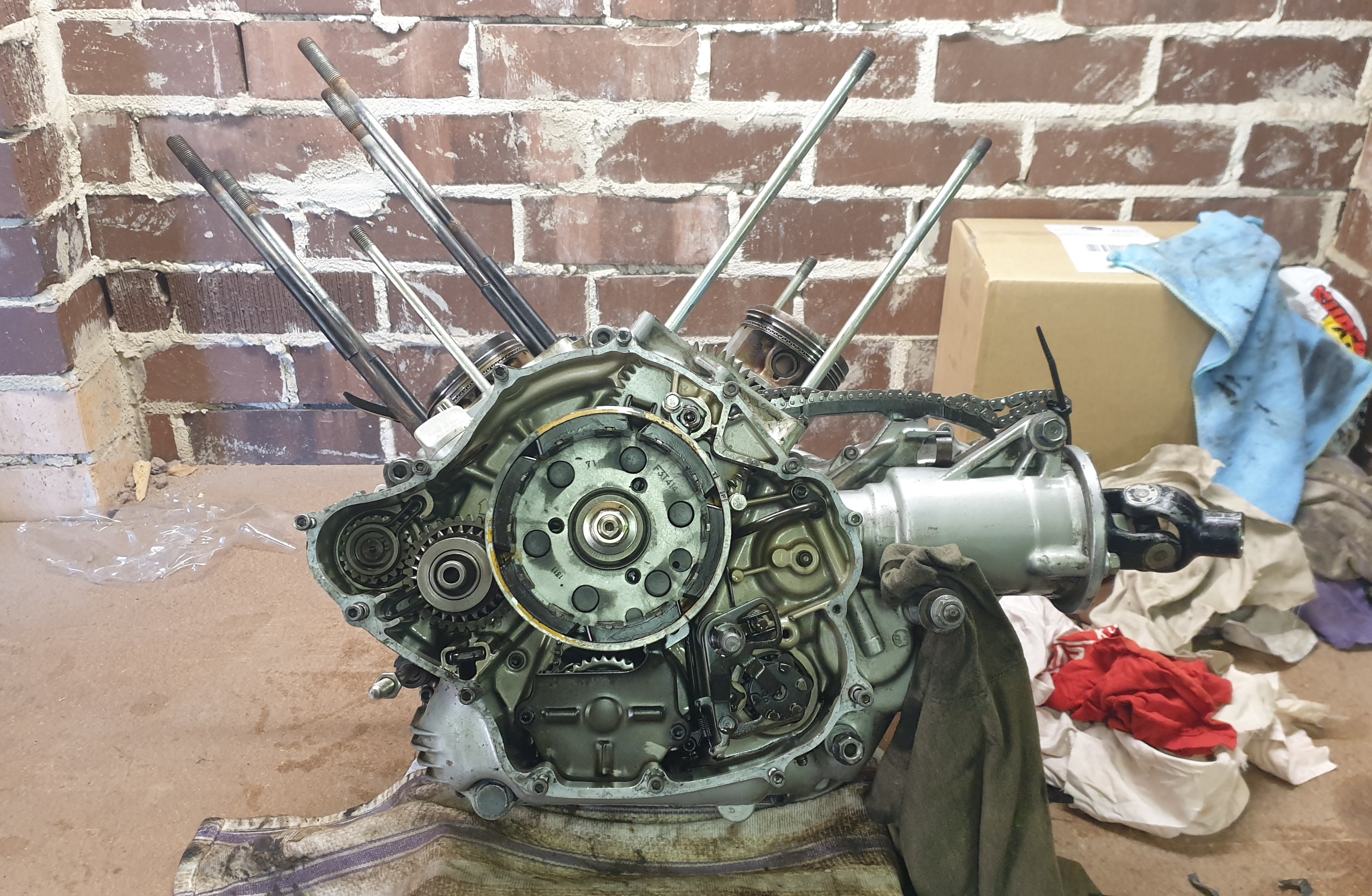

Very Nice Skogga...Can quite see what colours you've gone with on the casing and side covers. Mine is currently in pieces being cleaned up and undecieded with what to paint black and what to leave silver/polished.

Yeah thanks Shady, there's a few options with the engine paint. The tank I just went silver but sanded it matte and reliced it a little. I like the old school look, thats why I went traditional style forks, not USD. These 43mm Showa forks are perfect for the weight of the bike, but the rear is soooo hard like a hardtail! The CBR1100 had the shock a lot more vertical in the bike so its a lot stiffer. I dont mind really, its just a cruiser anyway and I really like dodging potholes. The main thing I would do is try and source an better starter system, XV1000 etc. Those "bag of bolts" starter setup on the 750 are really a PITA!
Nice Skogga, very clean look. That air filter is great. Wish my XV1100 was that simple.
ShadyOne, have you had a look at any of Der_Nanno's stuff. Guy is a genius with the XV range and has the perfect combo for an engine. Might pay to have a look while yours is so far apart.
Haha Brodie, you know what its off.......I had a 15hp Kohler ride on engine in the shed, saw the filter on it and liked the shape, bought a new one and made a bracket. Its hard to find one that looks ok!
Ha very creative. The shape of it is quite nice.
I ended up using an aftermarket filter for a Kingswood on mine.
Looks great Brodie, bet ya its a lot more comfy than my one! Those Mikuni flatslides arent stock are they?
Thanks mate,. No it stock. Still need to sort them out properly but they made a big difference from the worn out stock ones.
