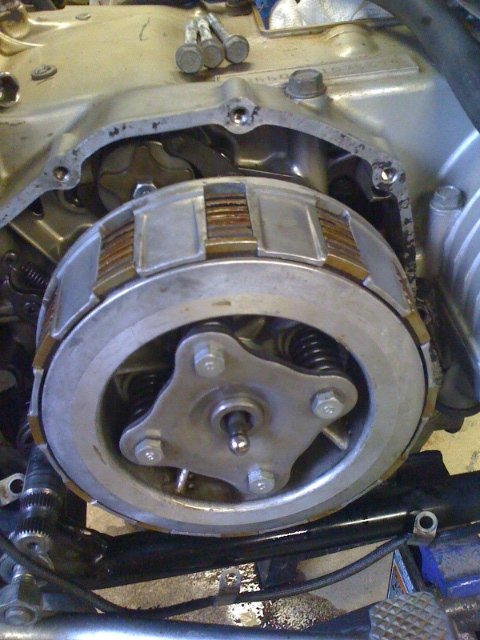

So step one is obviously to drain the oil from the engine. The clutches are in an engine oil bath and it will dump all over that clean garage floor if you dont drain it first. Personally I think its a shit design to have the clutch share engine oil, but that a debate for another time. Oil is drained? Good! Remove the kicker arm and whatever else is in your way. I made an investment long ago in magnetic bowls. I dont do any work without at least one handy. All the hardware you remove goes in the and stays in. Never lose bolts again! Clutch cover is off? GREAT! This is what you should see.
What you're seeing in that sideways picture is whats under the cover... You can see the clutch lift rod, the lift plate in the center, the basket, the clutch center, and you can just see the springs. I cleaned this up and reassembled it to make it easier to see so dont be surprised if yours is a mess. You can put a piece of paper on the floor and put the parts in the order they came out, so they go back in reverse if it helps you. Pull out that clutch lift rod. Remove the bolts on the lift plate. The lift plate holds the springs in, so I try to go evenly around to all of them. Do whatever you want, its just how I do it. Once thats off.. you will be looking at this. See the snapring in there??

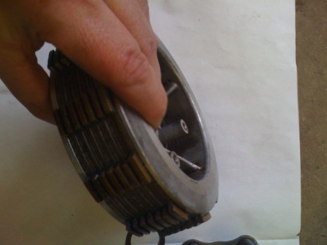

Put your free hand on the open end of the basket... the end that had the springs, and gently flip the whole thing over so that the clutch center, discs, and pressure plate slide out of the basket as one piece. The collar has a shoulder on it, so it cant slip out the back of the basket, but it can pop out of the front so be carefull as you put down the basket that you dont lose it. Now your holding the pressure plate, friction discs, clutch plates, and clutch center.

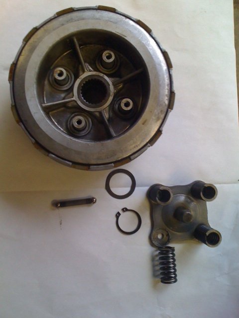

Keeping your hand on the spring end of this assembly, you can separate it by simply pulling up the pressure plate. It has four parts that go thru the center to hold springs and bolts for the lifter plate.
I got this kit for my bike because I wanted the added friction disc in the plus one kit, along with stronger springs. This is what the old friction discs looked like. Not terrible, but not great.
Ok! now clean everything!!! Parts cleaner is good, but dont leave any solvents on the parts if you can help it. Things like solvent, or grease, can make your friction discs slippery and make everything you're doing pointless. So clean clean clean!
