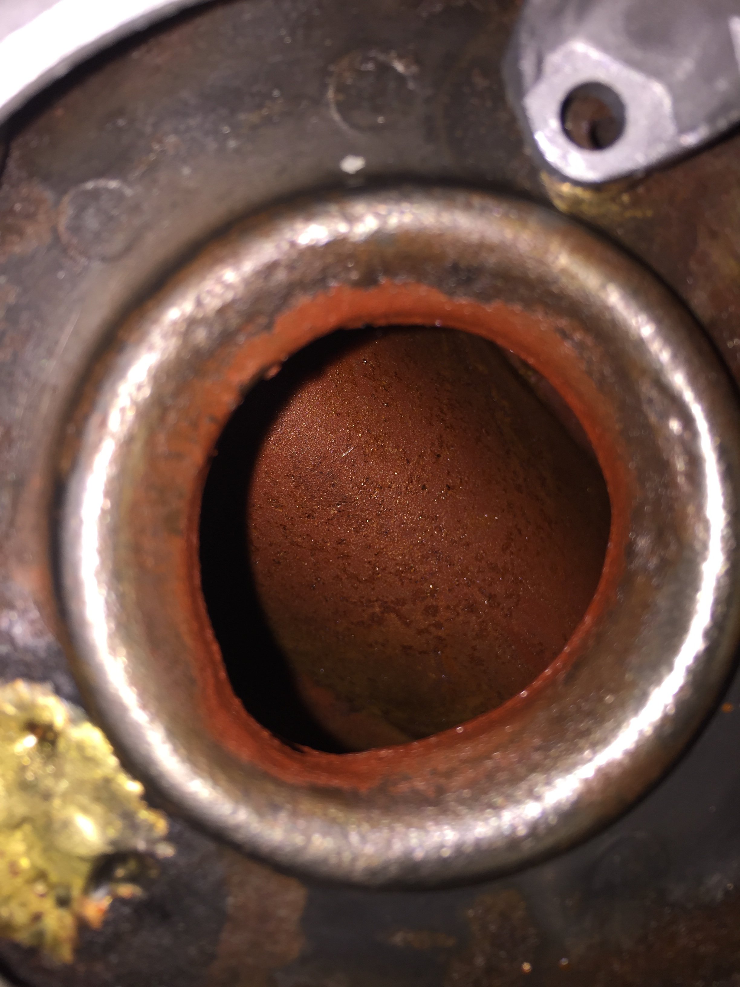

Did you pressure or leak test it before painting? Any internal coatings?

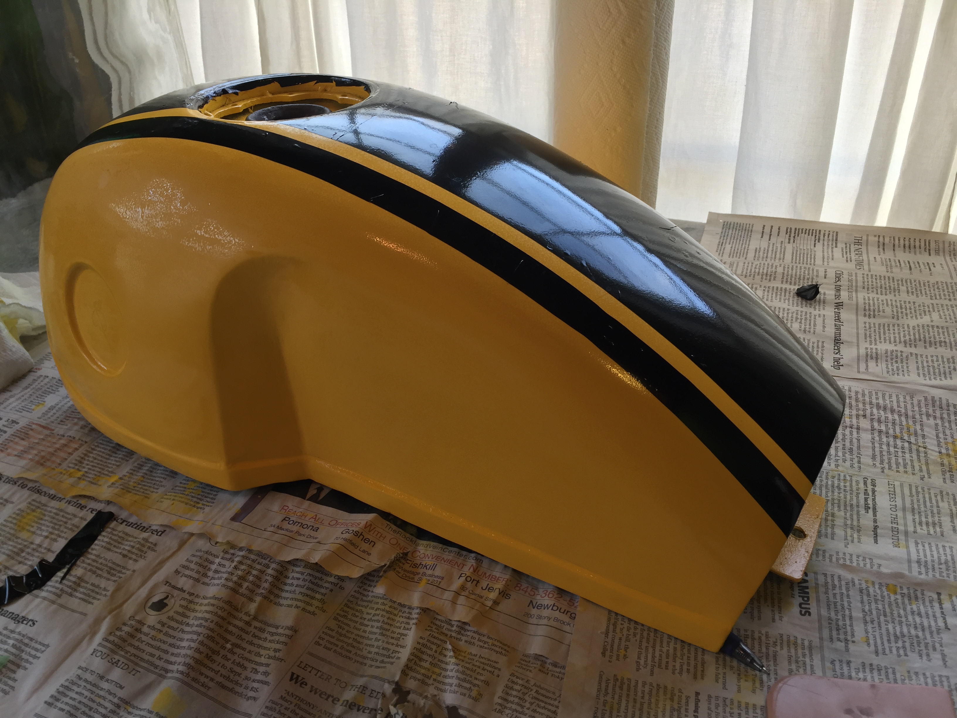

The tank needed a bit of bondo prior to priming. Didn't pressure test it but did treat the inside for what might have been flash rust. Not sure what it was. The outside was slick with oil. The aero plane cap is kind of crappy. Will not close flat and will probably replace it. However, faults aside, it is beginning to look beautiful with yellow paint and soon to arrive vinyl stripes

Application was a disaster. Couldn't avoid a number of creases and popped bubbles . Looks good from a distance , but am hoping that many Coates of 2k clear will disguise the imperfections
