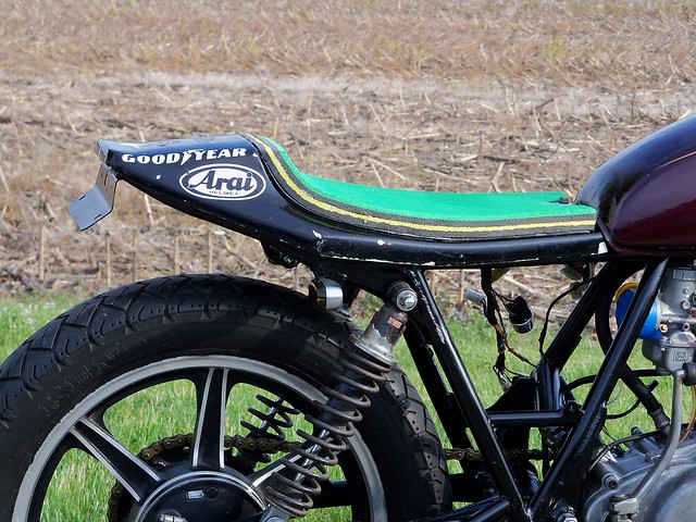

Seat assembly secured via the pan's factory carriage bolts and some tabs added to the frame of the bike.
Seat off the exercise machine was just tossed on for shits and giggles, a minute after this photo was snapped I found it it fits the mc frame like it had been tailor made for it...... I should have been taking photos as I went, but, oh well...
