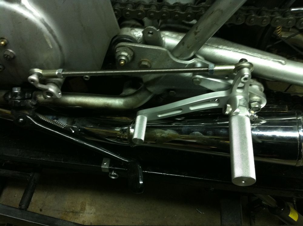

I know it's fairly common just to mount where the passenger foot pegs are located. That saves a lot of extra fabrication. For a "perfect" fit it's going to depend on the final location of your bars as well.
I'm the same height with the same frame. Passenger footpeg area was perfect for me. This is the kit made by forum member durgram_k. I love them. Nice work and perfect position.
notice I have a bolt on kick stand too. I didn't trust just the bolts so I tacked a few welds on it for piece of mind.

Thanks for the picture. That looks pretty good. I searched for that user name to contact him about the footpegs, but his name wasn't found. Was is misspelled, or something. Thanks for the info.
