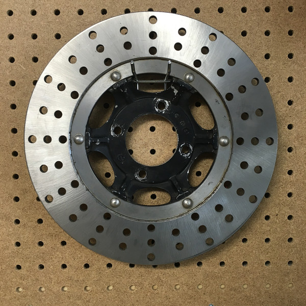

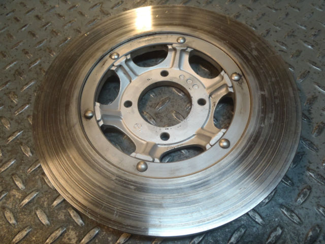

Thanks. I was looking at these but the rotor on my bike is solid. It doesn't have holes in it like the newer rotors. On these locks, they have a pin that would fit through the holes. The first pic is my rotor, and the second is a photo of rotors that could use the types of locks you linked.

Get your rotor drilled. Lighter and brakes will work better, and you'll have something to stick a lock in.

Youre psychic. Just before I read your message I found this:
http://rawhidecycles.com/products/brake-disc-rotor-for-cb400f-cb350f-cb350g-cb360

Yeah I agree. I looked on ebay and saw a spare rotor in good shape for like $25. I'll probably end up getting that and having it drilled. What should it cost to have a stock rotor drilled? No way am I going to pay $160 for a rotor. Nope.
thanks for your help. really appreciate it.
I've seen around 65-85$ or so depending, you might want to check in your local area first. It should be a super easy job for a local machine shop. If you have a drill press of your own, save the cash. Get or make a pattern first. Happy to help.
is any particular pattern more useful?
If you drill your rotor be sure to chamfer the holes. With out the chamfers it eats through pads like a cheese grater.
