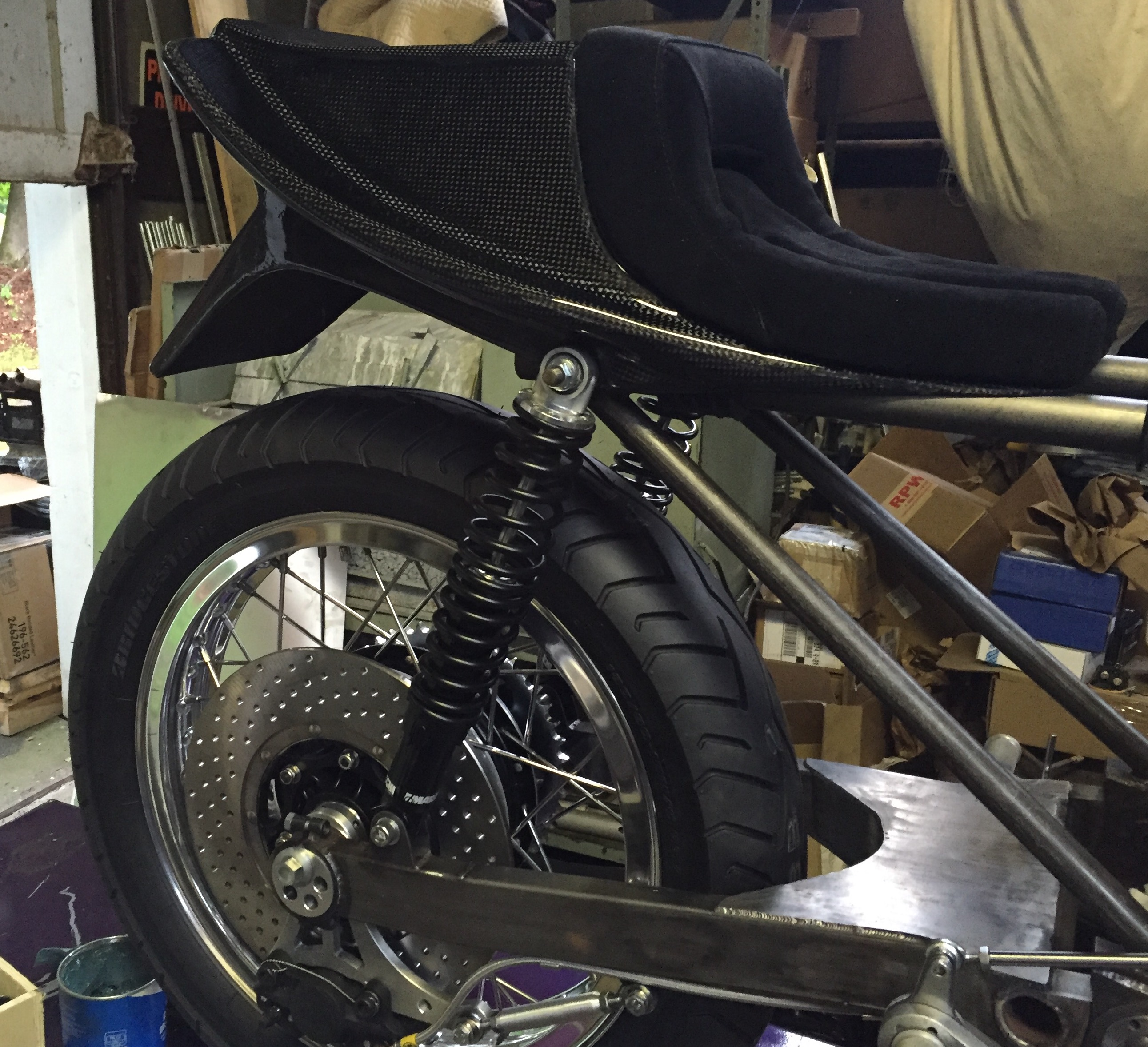

Fitting the seat

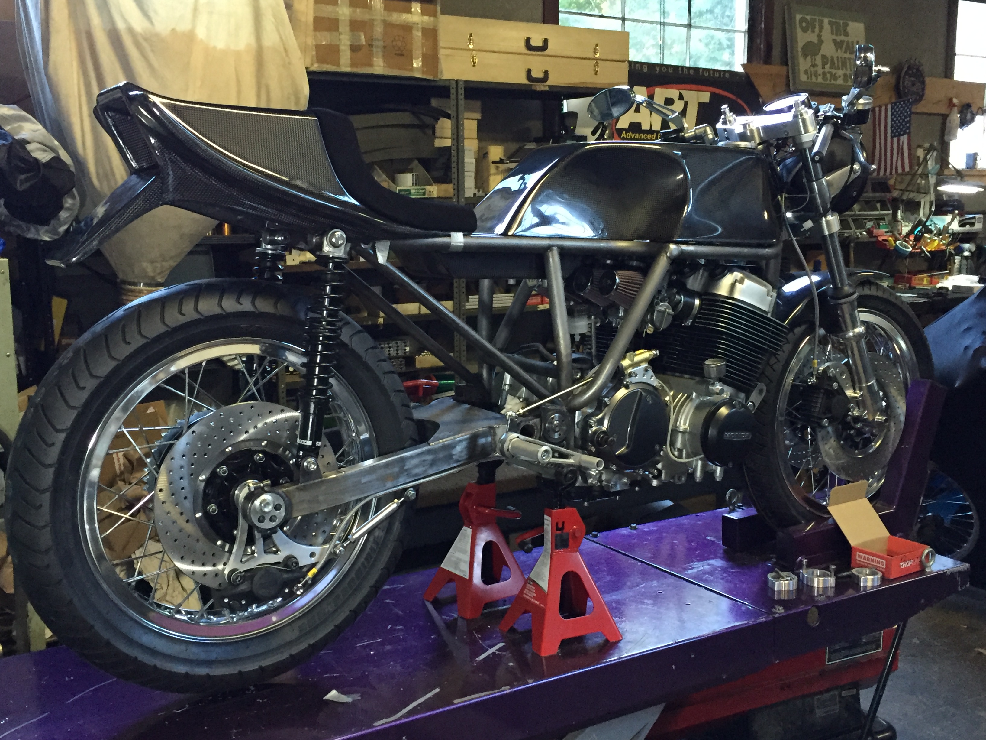

This thing is on another level! Awesome work man. Thanks for sharing it here
Really nice carbon work, the weave is consistent even along the tight bends where most people get a lot of distortion. Nice!

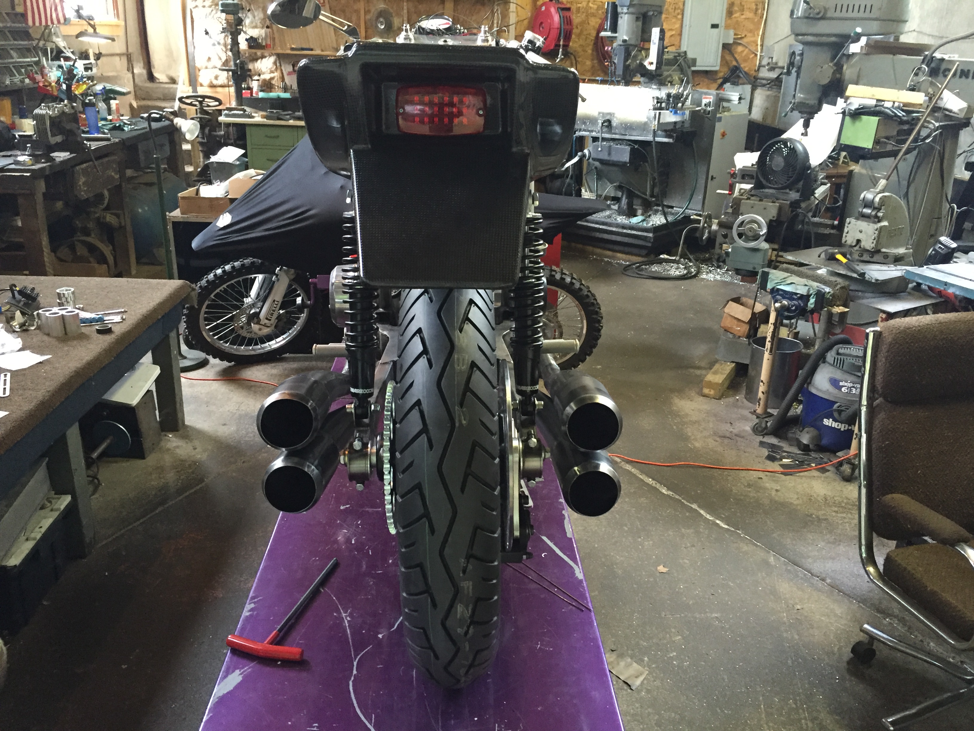

Is it possible to bring the two lower pipes in a little to give it a V look from the rear. It would also add some cornering clearance too.
They are about 1/2" to 1" away from swing arm now.
Vertical is more iconic for this bike but it can be done.
I can do it that way if you like. I just need a $5000 deposit. LOL

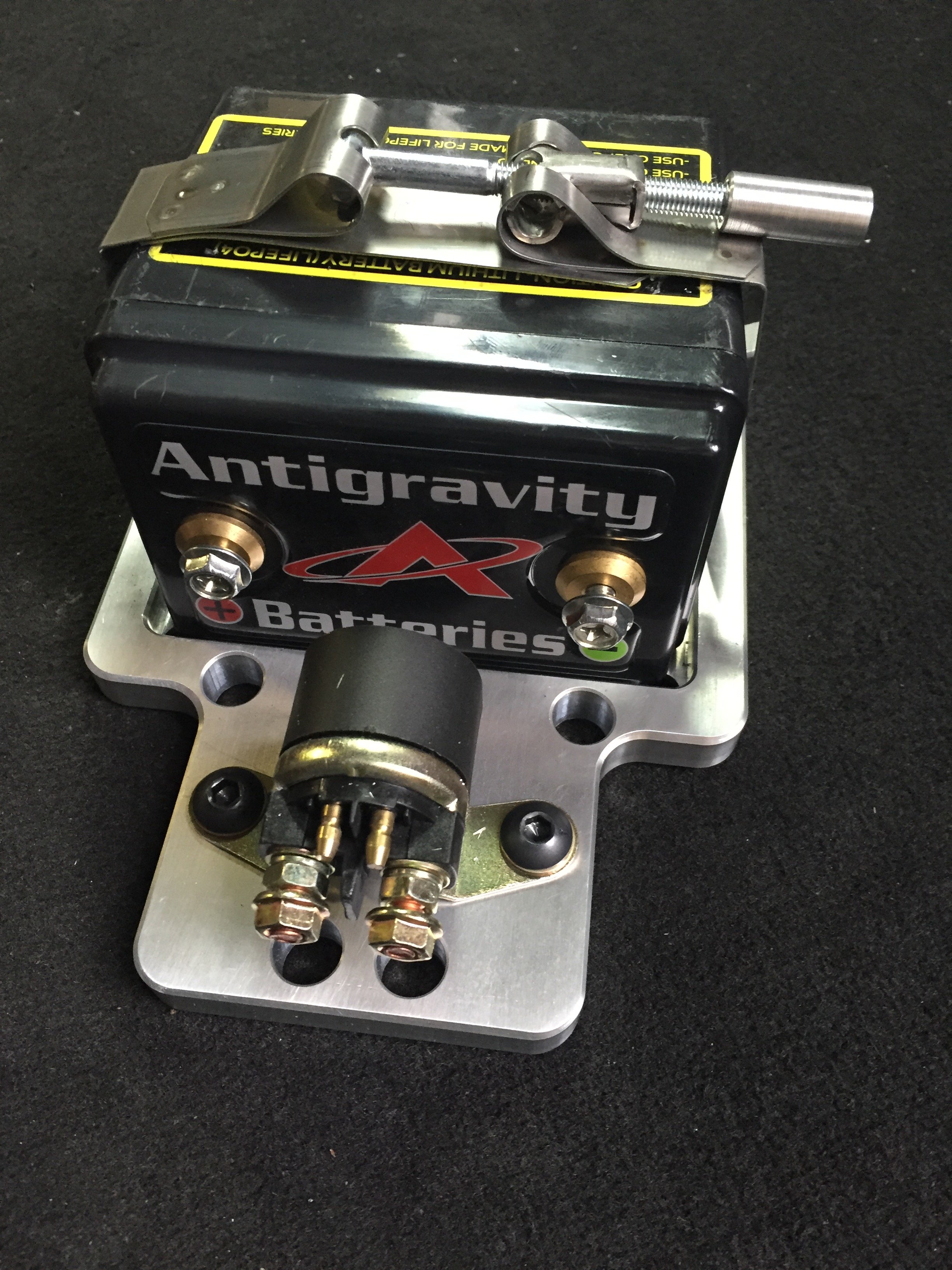

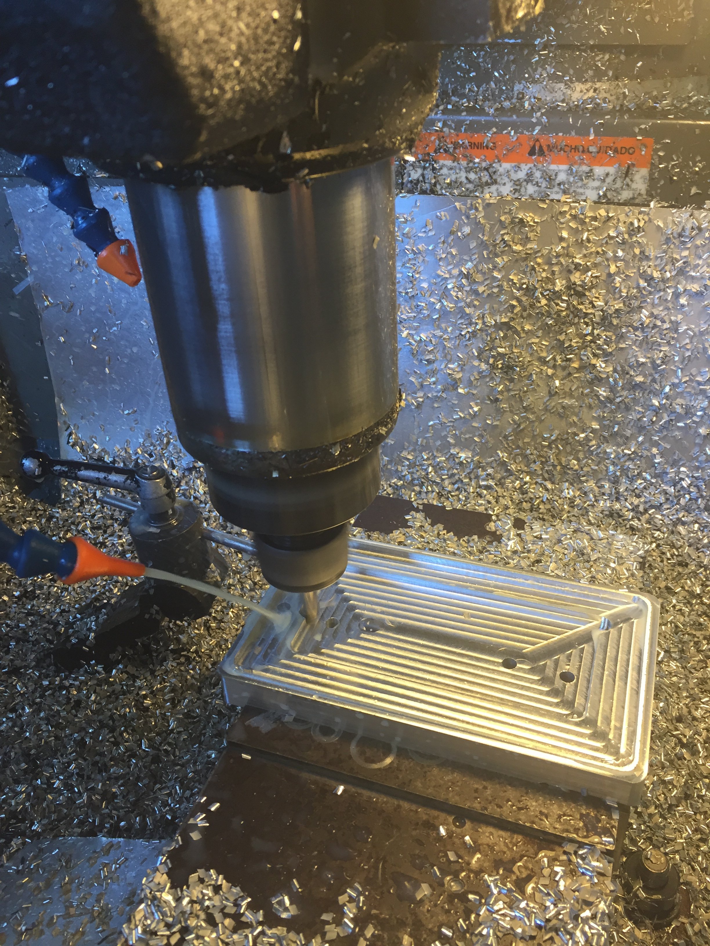

Made battery/solenoid tray and aluminum hangers for exhaust.

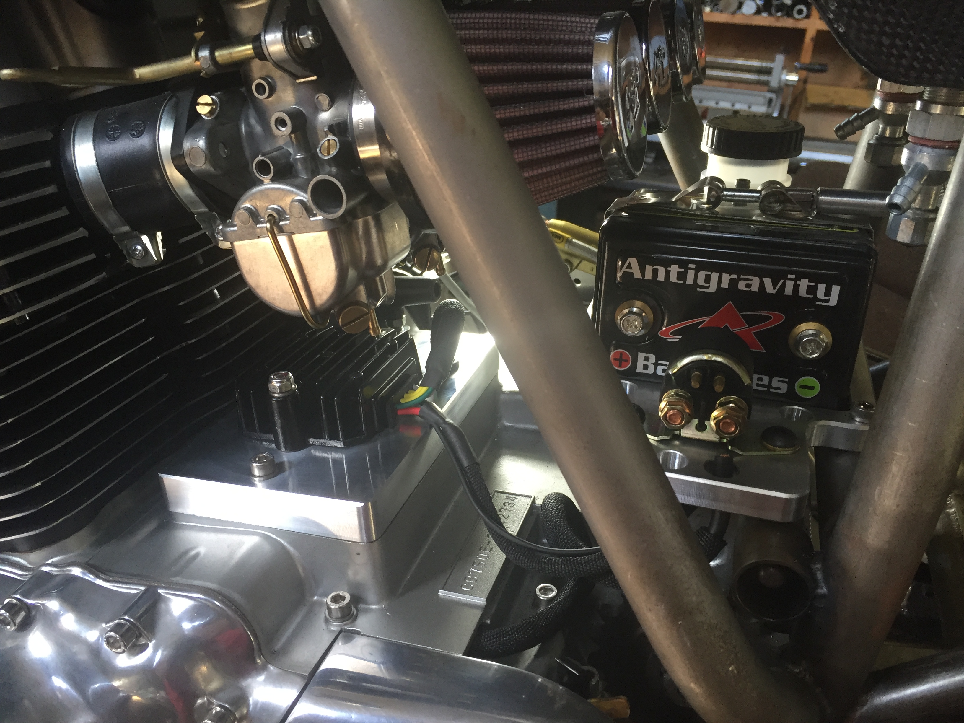

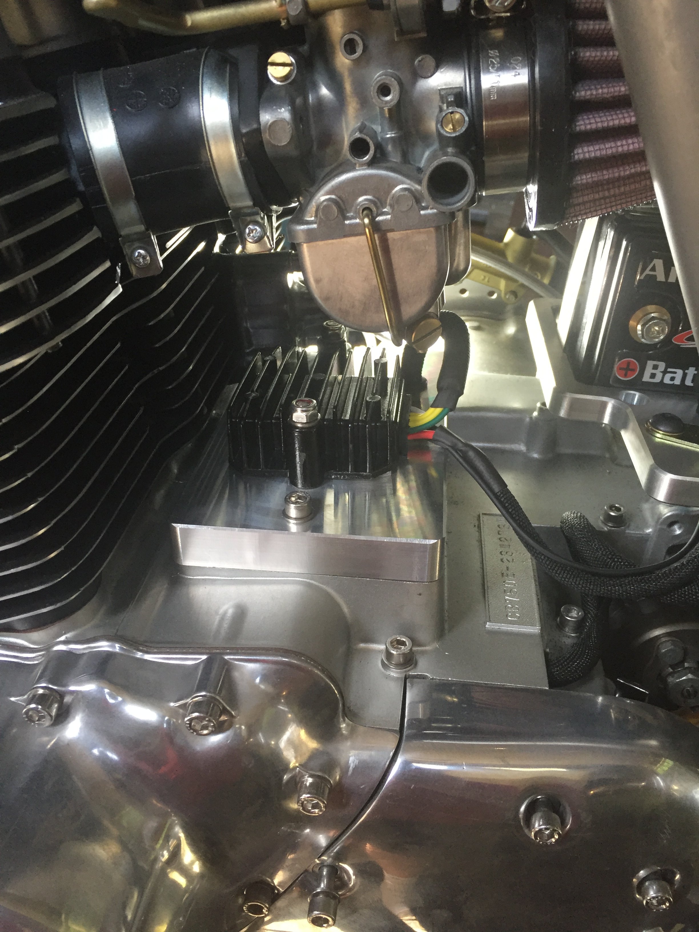

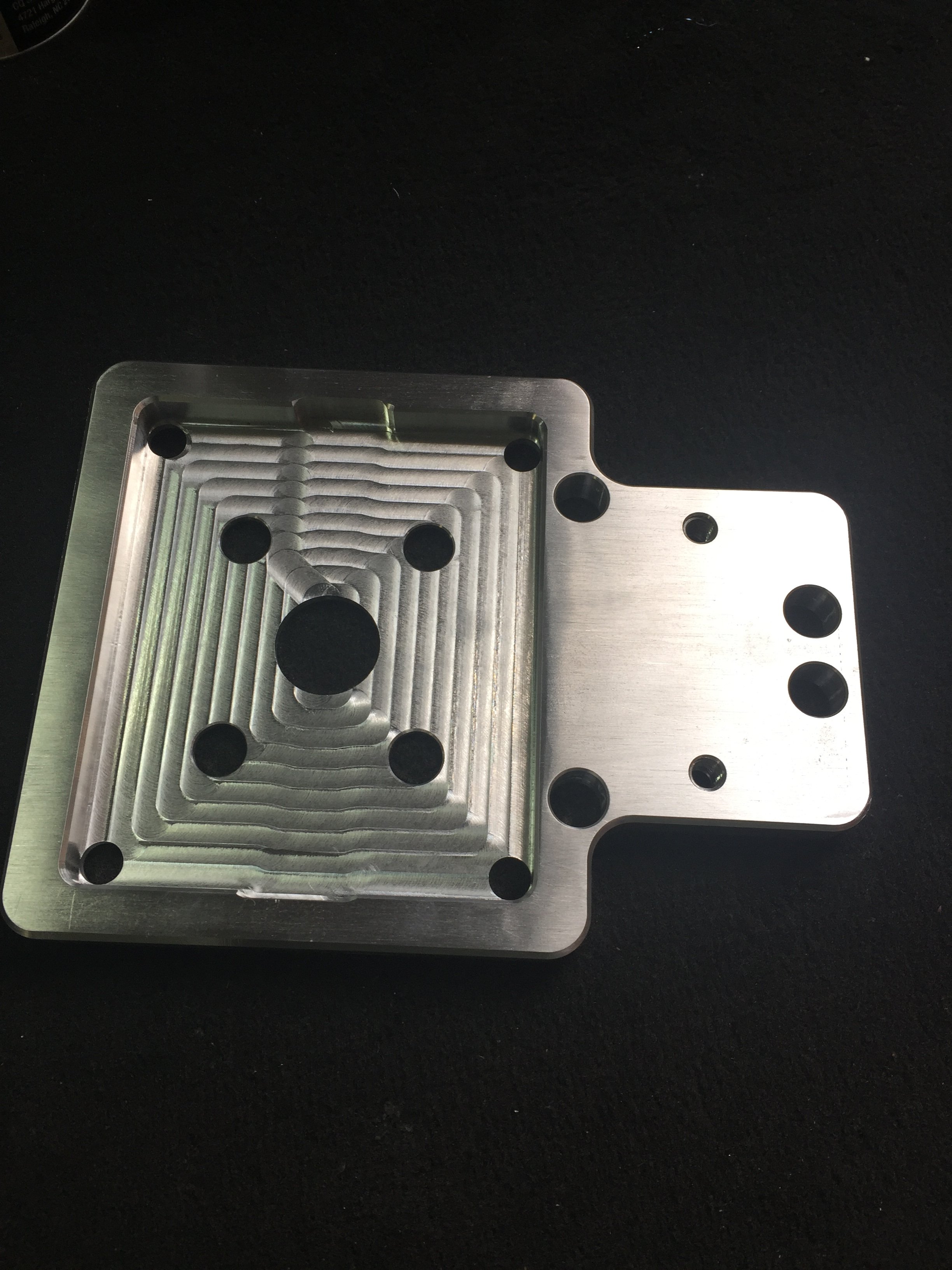

Made new starter cover to mount solid state regulator
Tearing down for paint next week after fitting new custom
oil tank.
