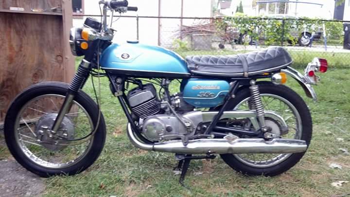

Sold this a month ago. 1970 Suzuki t350.
