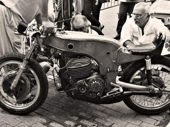

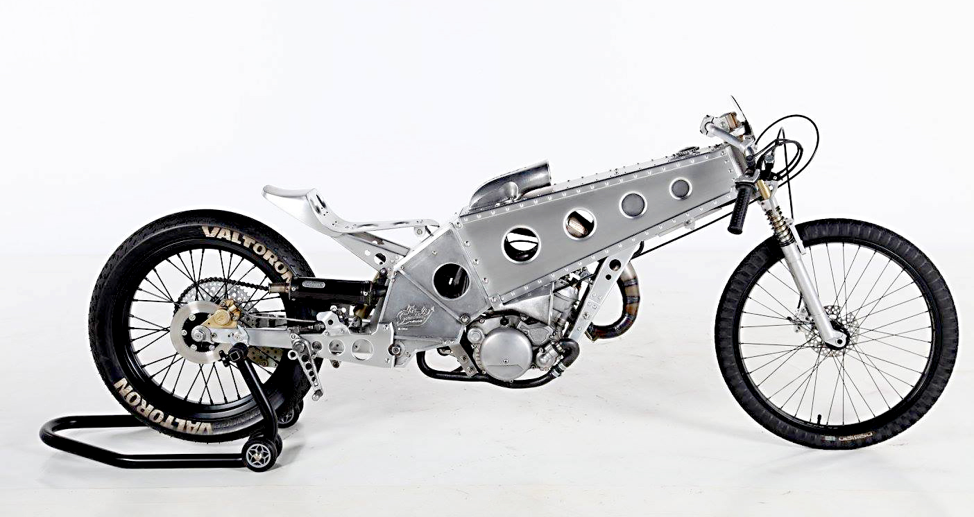

More Ossa goodness, love this frame design.
OSSA 250 Monocoque
Rotary valve side draft yummyness not a performer but cool kit.
