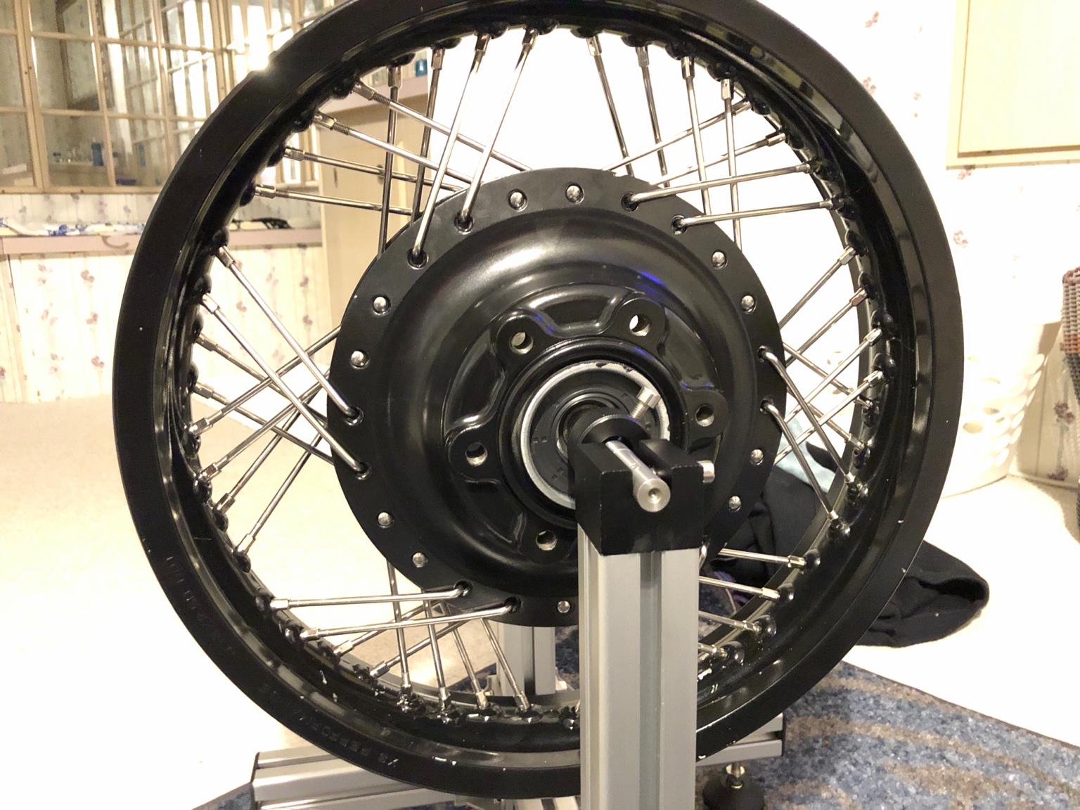

And 12 hours later, we have a wheel. Holy crap...... I completely underestimated how complicated this would be. Took me about 5 tries to get it right, and I still have absolutely no idea what I was doing wrong either time. Can’t wait to do the front lol. Also, I boogered up the paint real good. Not too thrilled about it, but I’ll touch it up. Live and learn
It’s the 46 spoke. Kinda rare, but still available. I believe they only came on US model heritage specials for a couple years. They are a pain in the but for sure. The front wheel is 64 spoke, so it should be interesting.

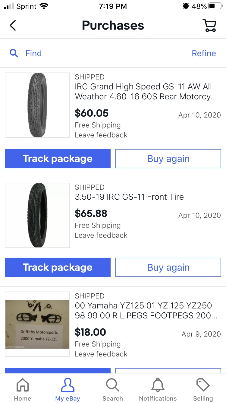

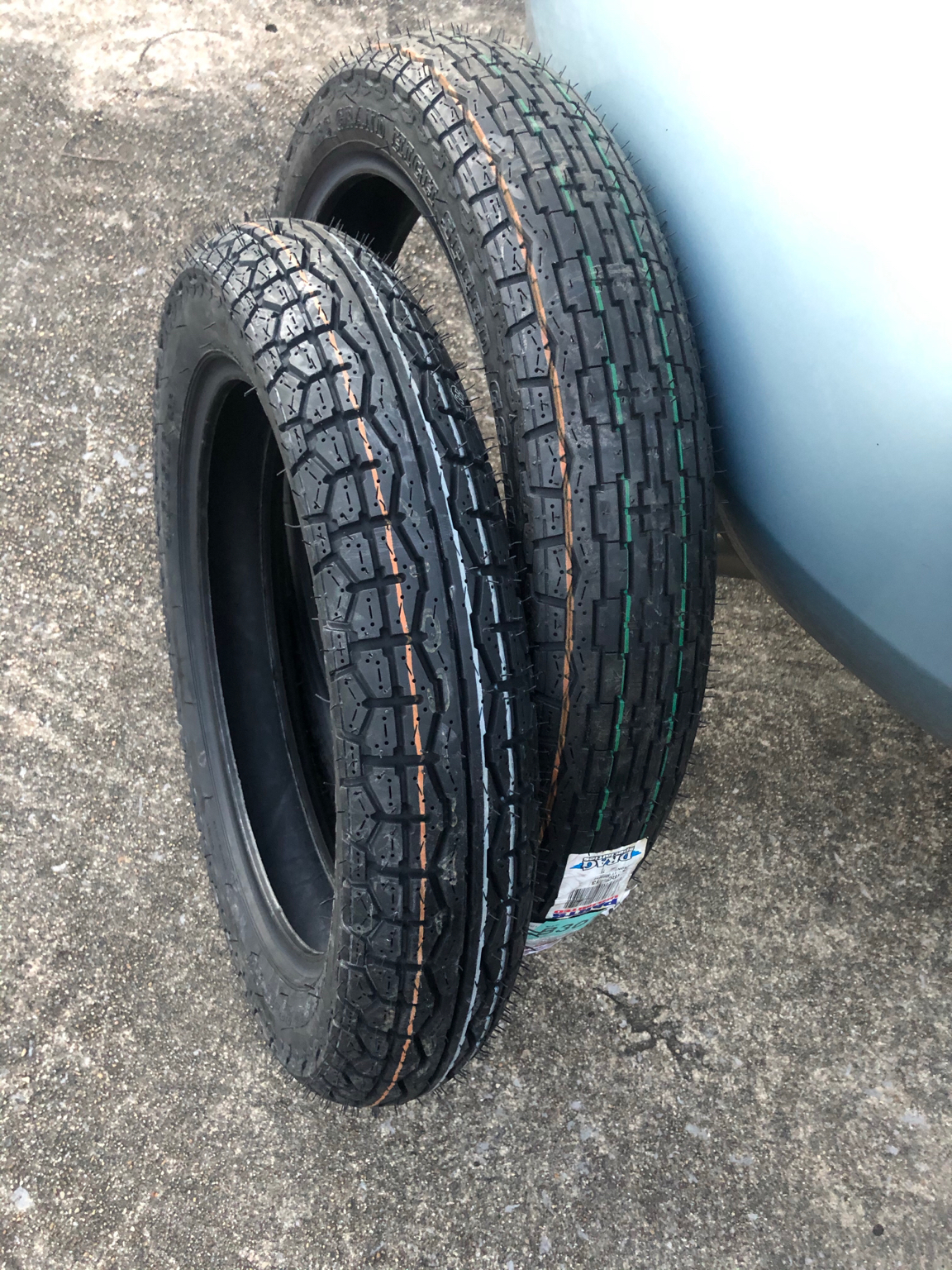

Tires purchased today. I beat my head on the table on this one, but I finally pulled the trigger. The good thing is, if I don’t like them they didn’t cost too much. I do think they will look appropriate, I just hope they perform well. That being said, the xs650 isn’t too much of a beast so I think they’ll be fine. Got some YZ pegs to swap out that rubber slop

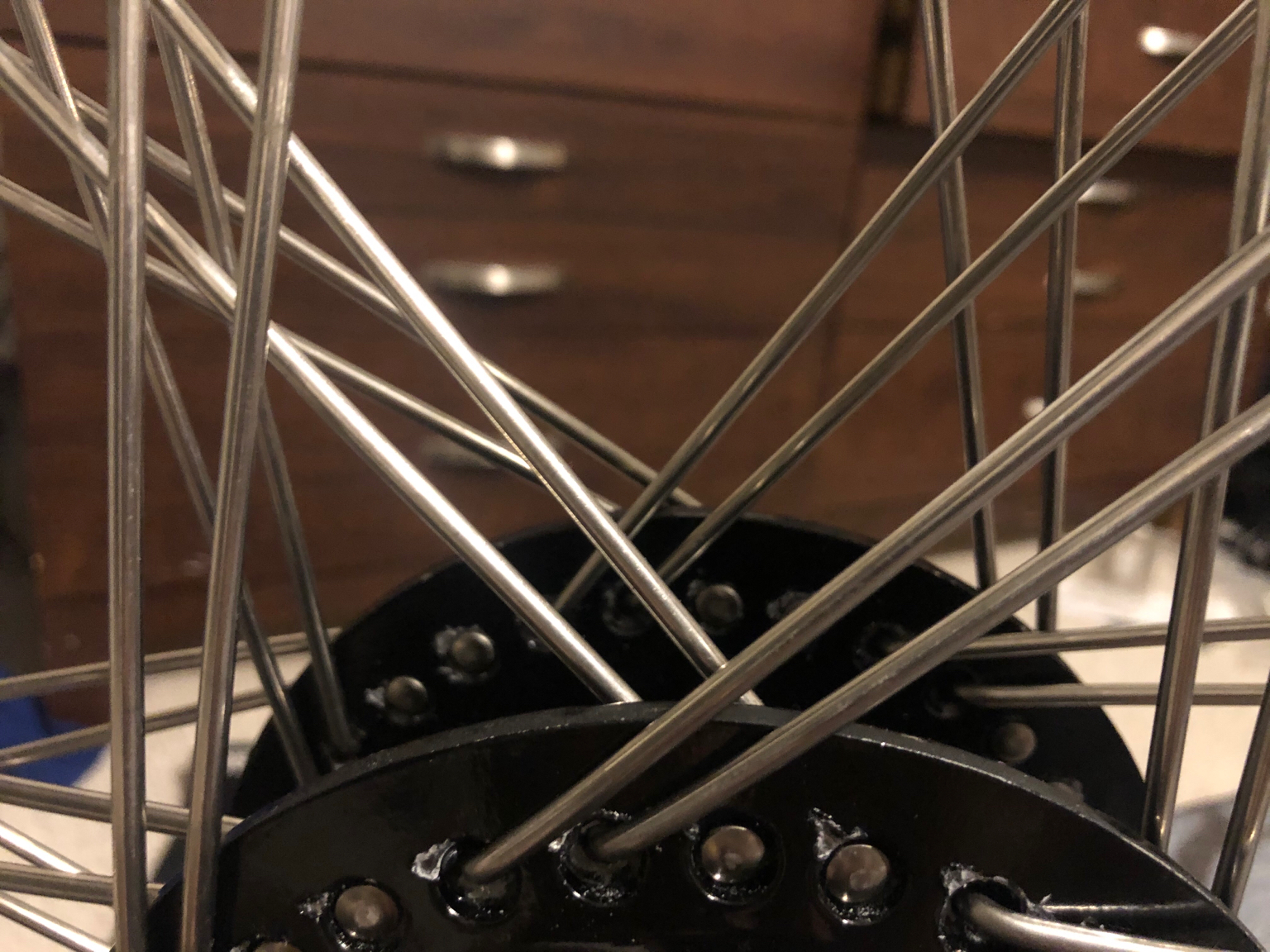

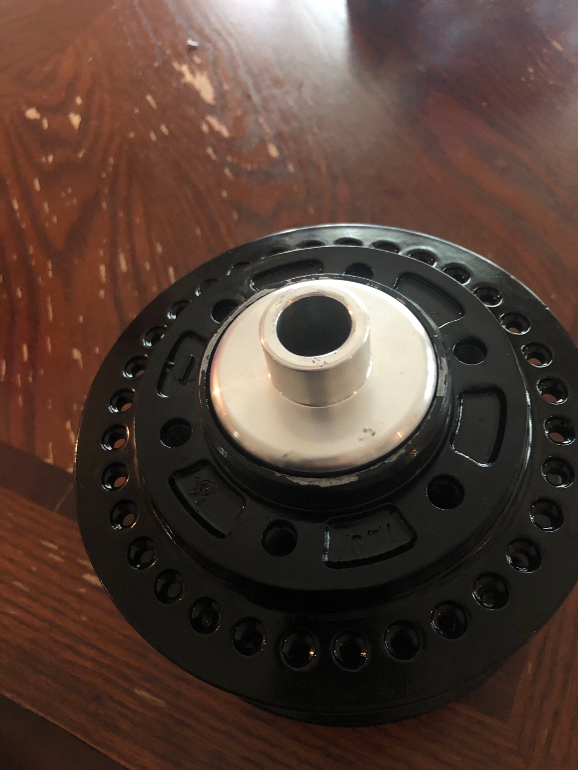

Right now I’ve got the wheel back disassembled. I do have a shot of my last attempt. I took a shot of the inside of the hub. On this attempt everything lined up until the end. The last outer spokes wouldn’t reach no matter what. I tried everything. Also, some of the inners lined up to long.
Hers a shot of my first attempt. Pretty sure on this one the rim was backwards, as most of the outers on one side wouldn’t reach.
I’m going off of a photo of the original front wheel, which was certainly laced by the previous owner. I struggled with disassembling it, so there’s a possibility it was laced wrong. I really don’t know. I do know the bike had a NASTY speed wobble. The bearings didn’t look all that bad.

On the first photo, the outer on one side has a set of inners on the opposite side. Is it possible that this is the problem? Should there be inners and outers in the same holes on both sides? I’m sure I thought of that, but it’s a mind numbing process
Looks to me that in the second pick, your spokes on opposite sides of the hub are one hole off. One thing that I do, and you may already know this, is start with the valve stem hole. You have six holes on the hub split by the valve stem, the forth hole is your first spoke that mounts to the rim next to the valve stem hole. You mirror that on the other side, but you have to build your inners before you flip it. I can't tell where your valve stem is on your built rim, but it appears it's possibly in the same orientation as the PO rim. If that's the case, you're way off.
The valve stem appears to be in the same place. Does the orientation of the hub matter in correlation to the valve stem, or can I just pick 6 holes?
