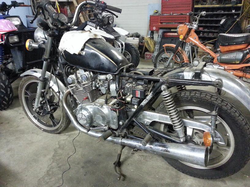

Just got my hands on a 1982 Suzuki GS450.
Been a follower of DTT for a while now, but this is my first build. Looking to go Brat Style Cafe and greatly appreciate any suggestions, tips or feedback.
My first task is to get away from the cruiser stance in favor of a cafe stance. Does anybody know if can just swap out the 16" wheel directly with an 18" wheel of an earlier model? Is the axle bearing the same?
Attaching pics of a little progress. With a little TLC to the carbs it fired up and I was able to take it for a spin.

Welcome! Nice to see yet another GS450 on here.
Yes the axle/bearing size matches up on a swap to an 18" rear. I was cursed with the 83 L Frame and 16" rear tire on mine to start as well. Simple easy swap and there are usually several available on ebay and other sources fairly cheap.

Been working away today removing the unnecessary tabs, rear pegs, fenders etc.
Upon further consideration, I have been thinking about going with spoked wheels and some meaty tires. Would the spoke 18" wheel be a straight swap as well?

I think the GT250 spokes have the same axle. Big Rich is the man when it comes to spoke wheel chice for the suzukis. He would be your best bet on the wheel acts when it comes to spokes. If you could find a set of GS450 spokes they should be a direct swap.
I thought of swapping to spokes and the snowflakes have grown on me for now.
