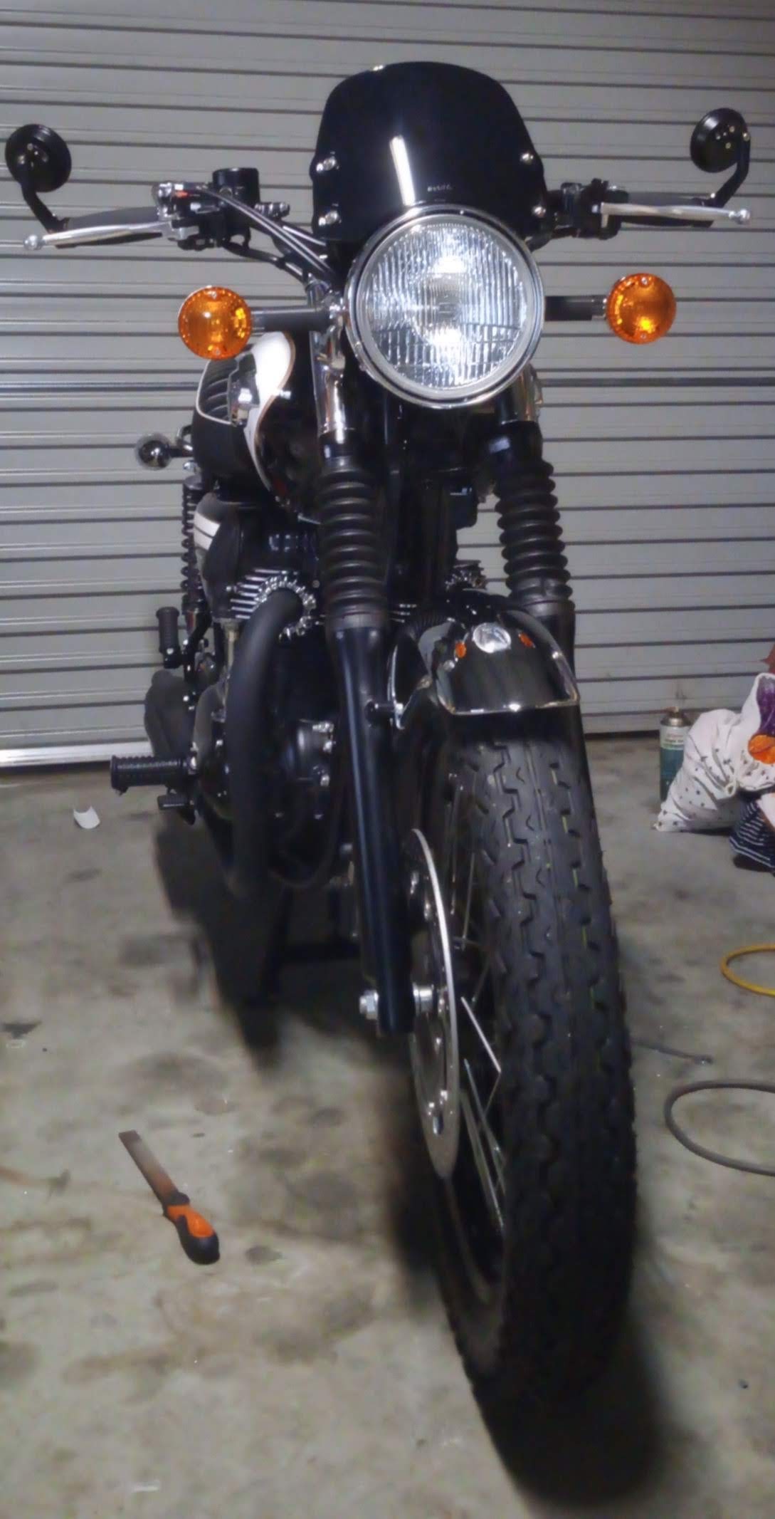

Hi Brodie,
Nice mods on your Kawasaki!
I have the 2014 W800 and I’ve just ordered a pair of bar end mirrors.
Is there any chance you can exchange some tips on how to install them? Seems pretty hard as I don’t see any clear bolts or Alan key points at the end of the handles.
Cheers, regards from Amsterdam, Netherlands,
Michiel

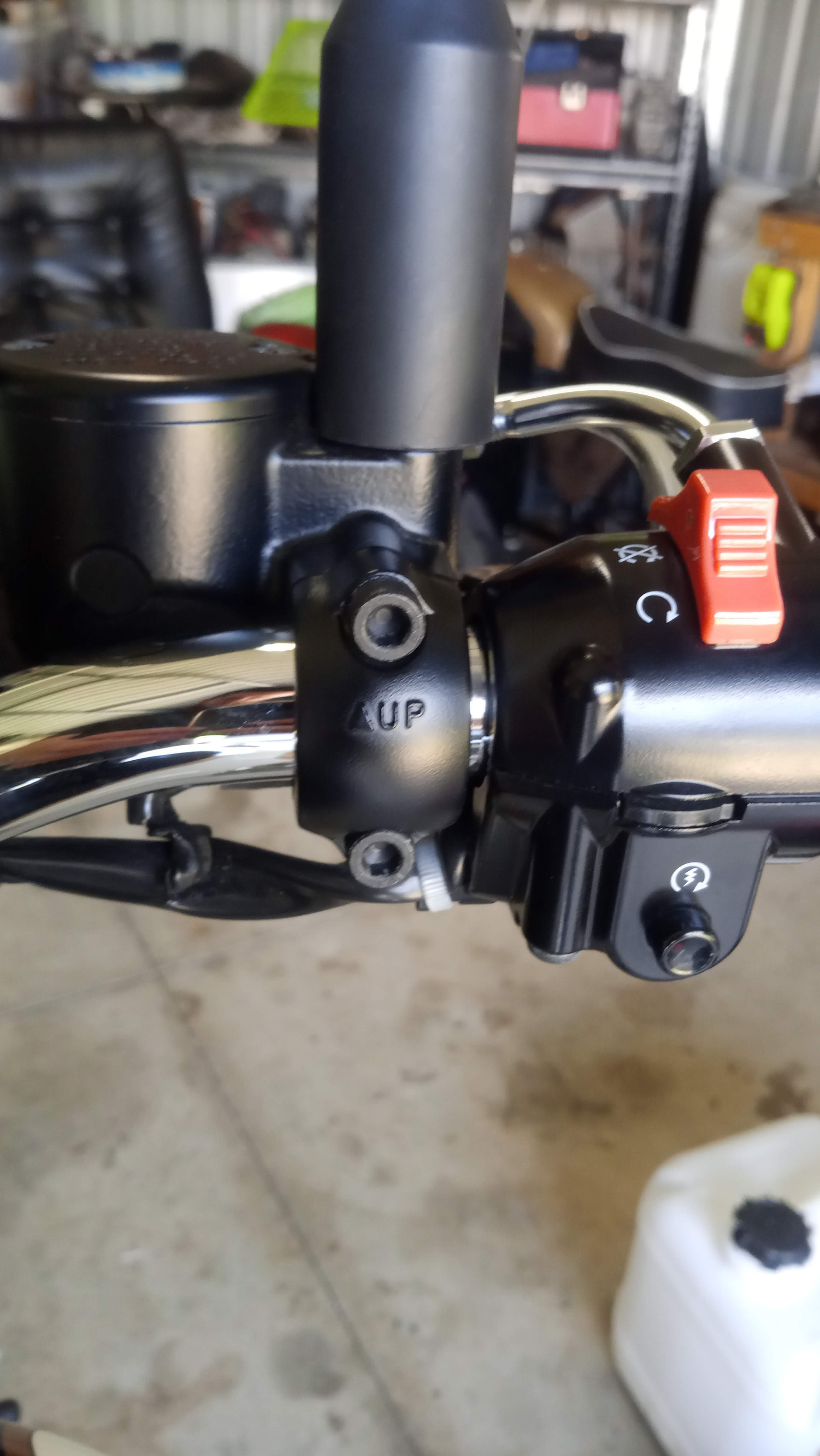

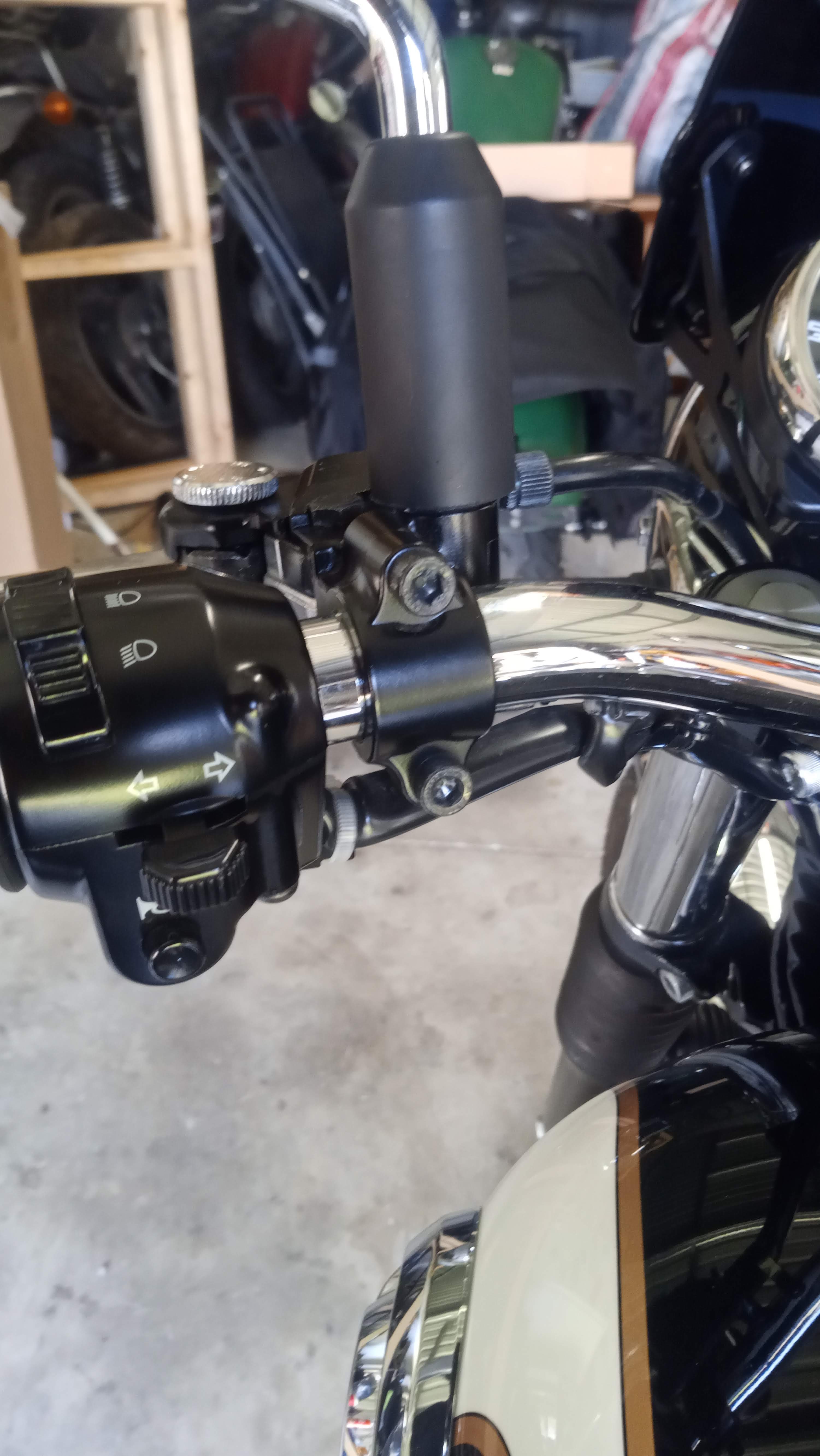

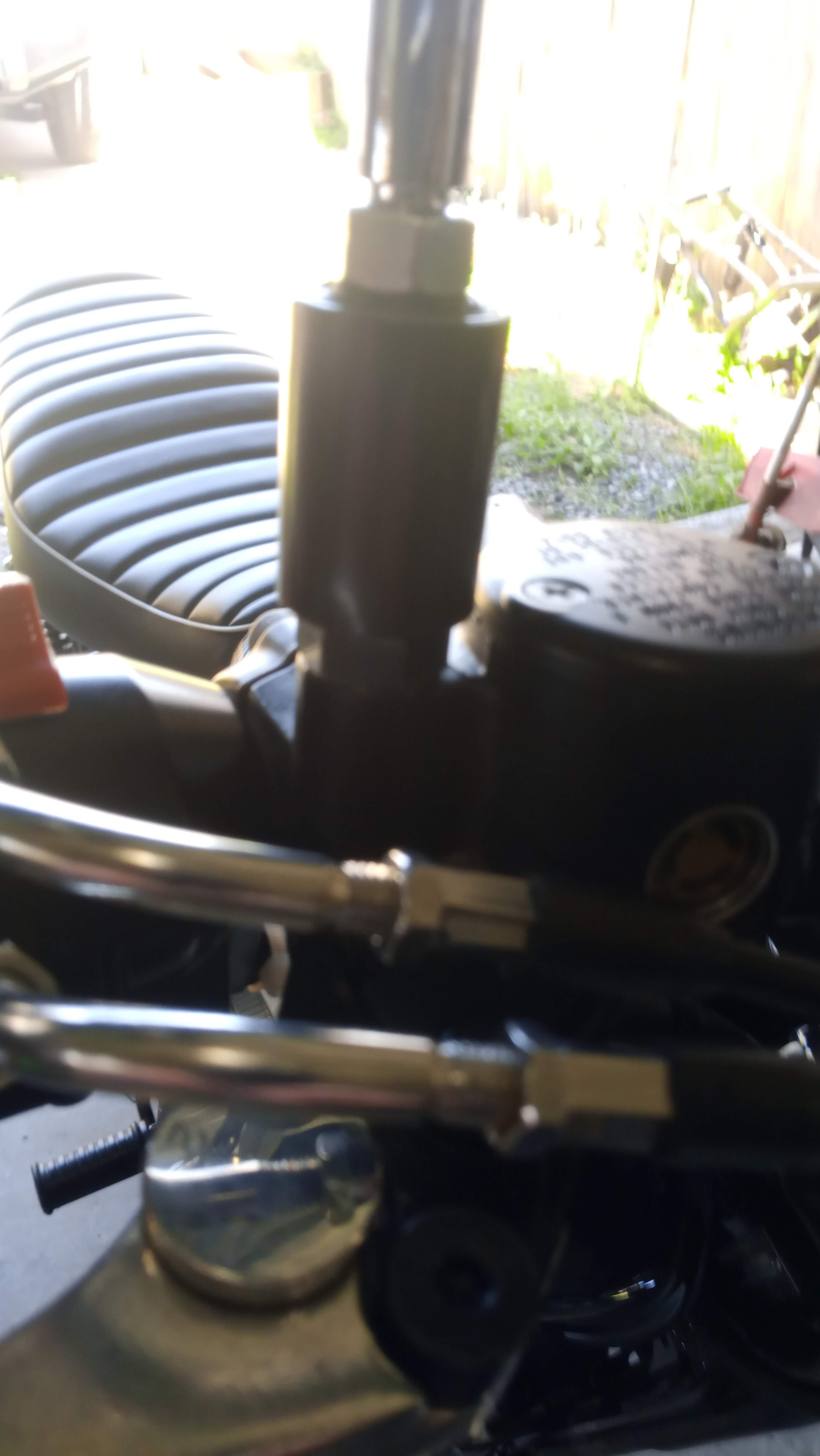

Hoi Michiel,

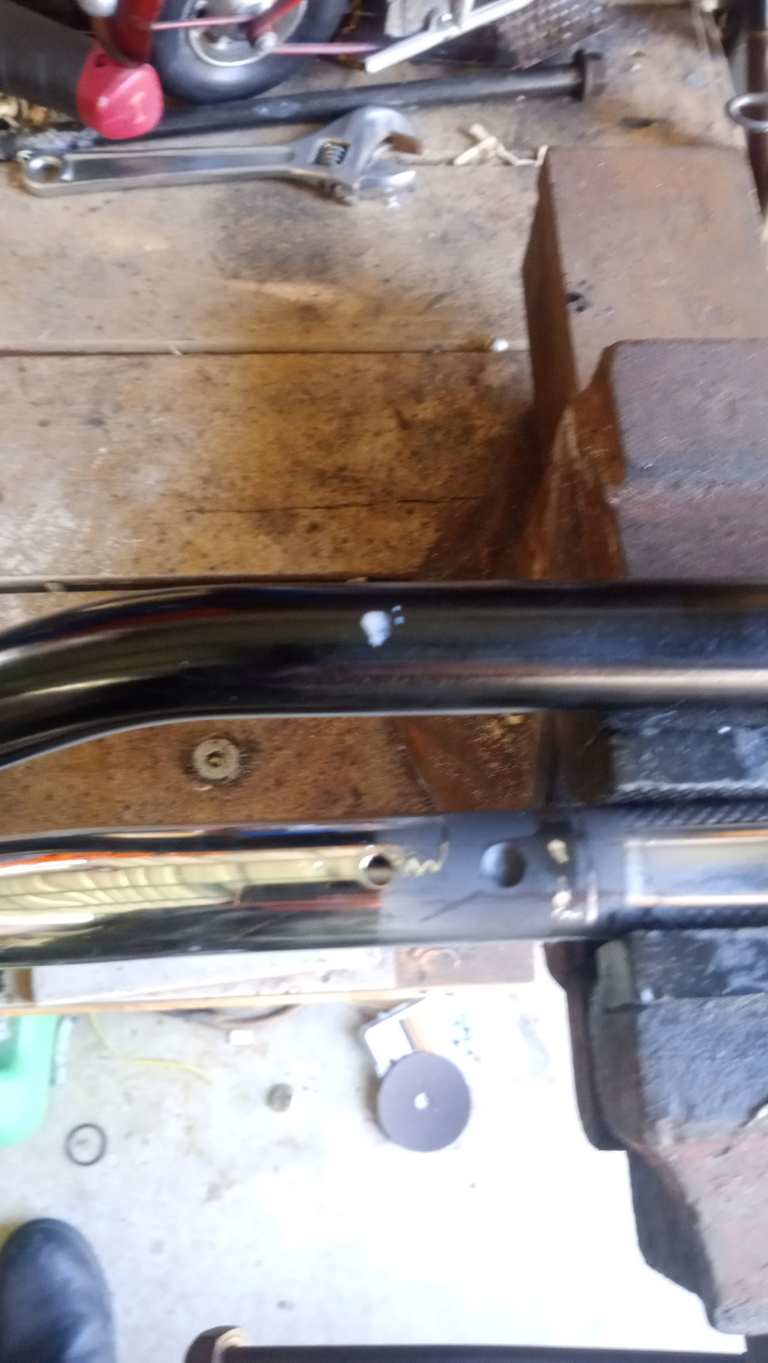

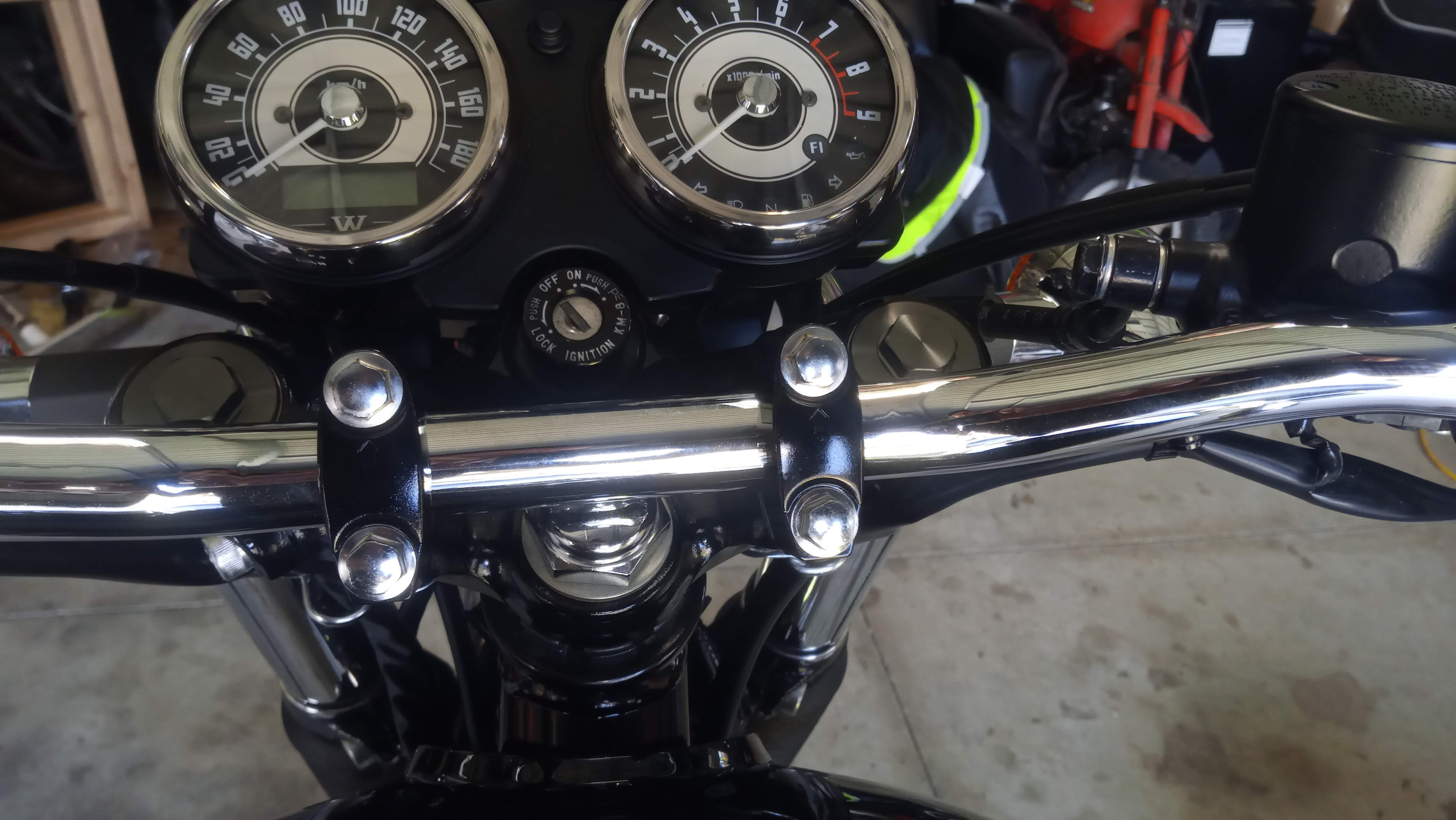

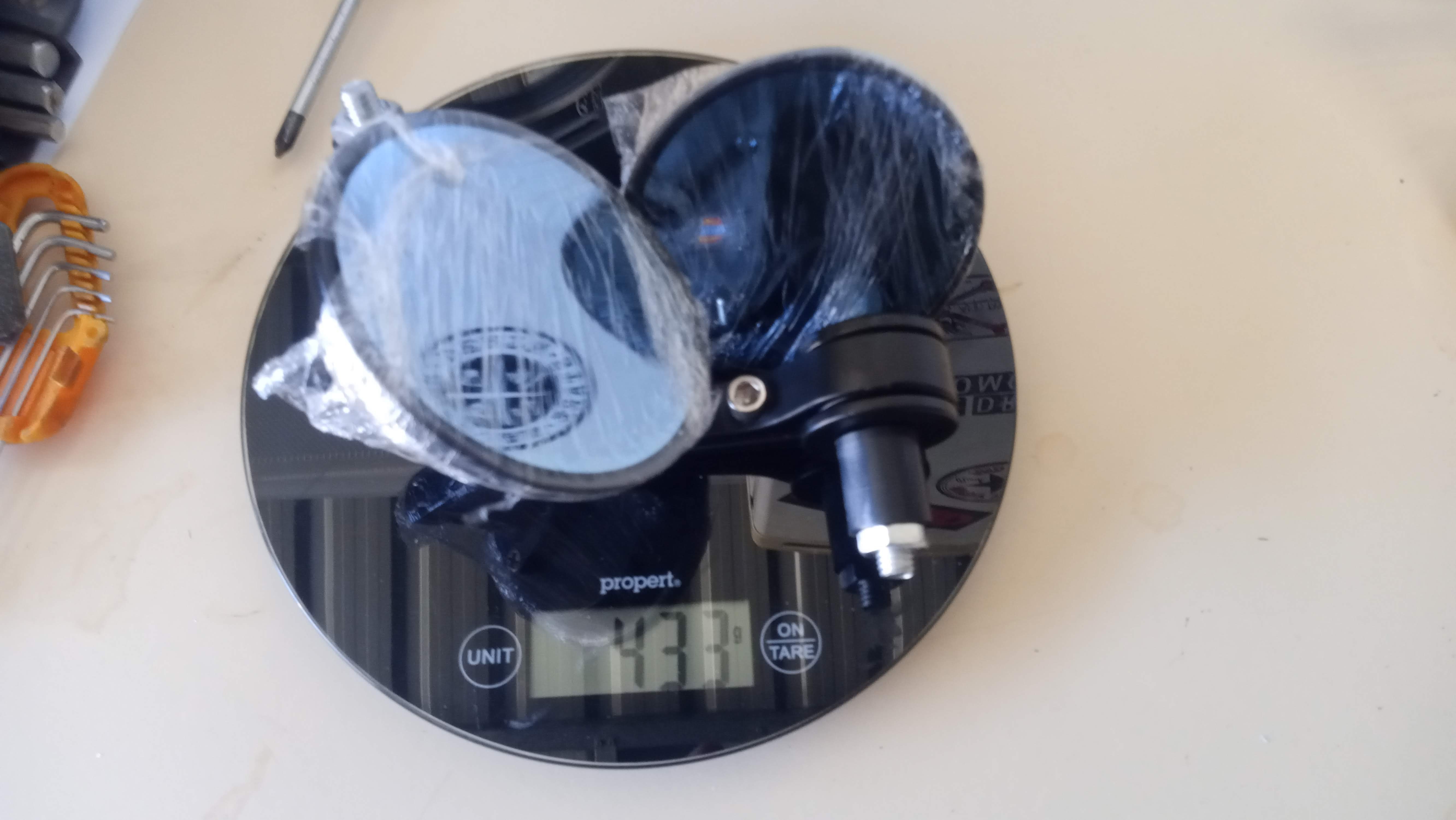

I decided to change the bars on my W800 to a set of light weight alloy bars. The bar end mirrors I used have expanding sleeves to hold them in place. Push them into the bar and tighten the bolt to lock them in place.
Here is a run down of how to change the bars.
1. Lift the rubber boot on both mirrors and remove them.

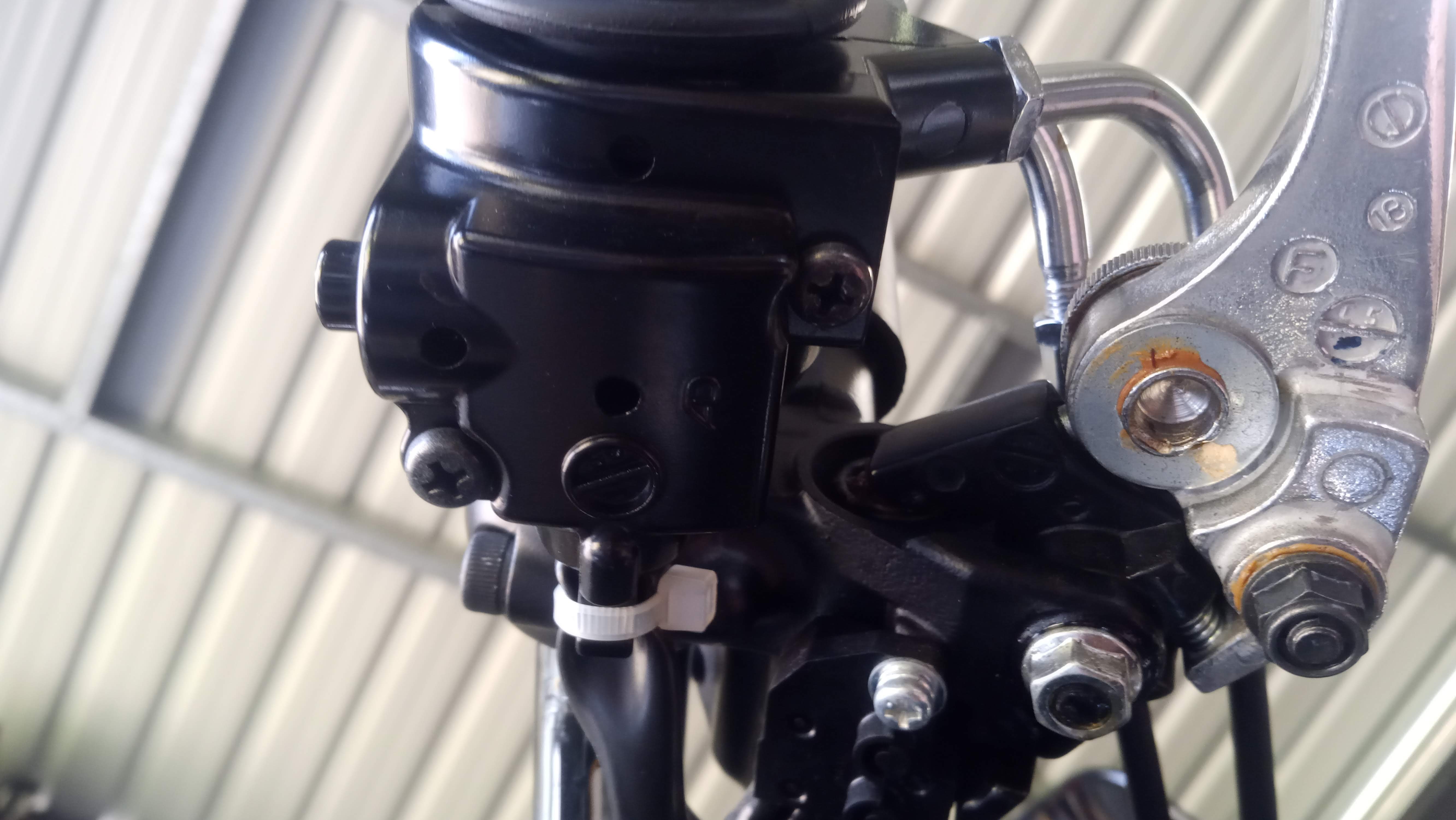

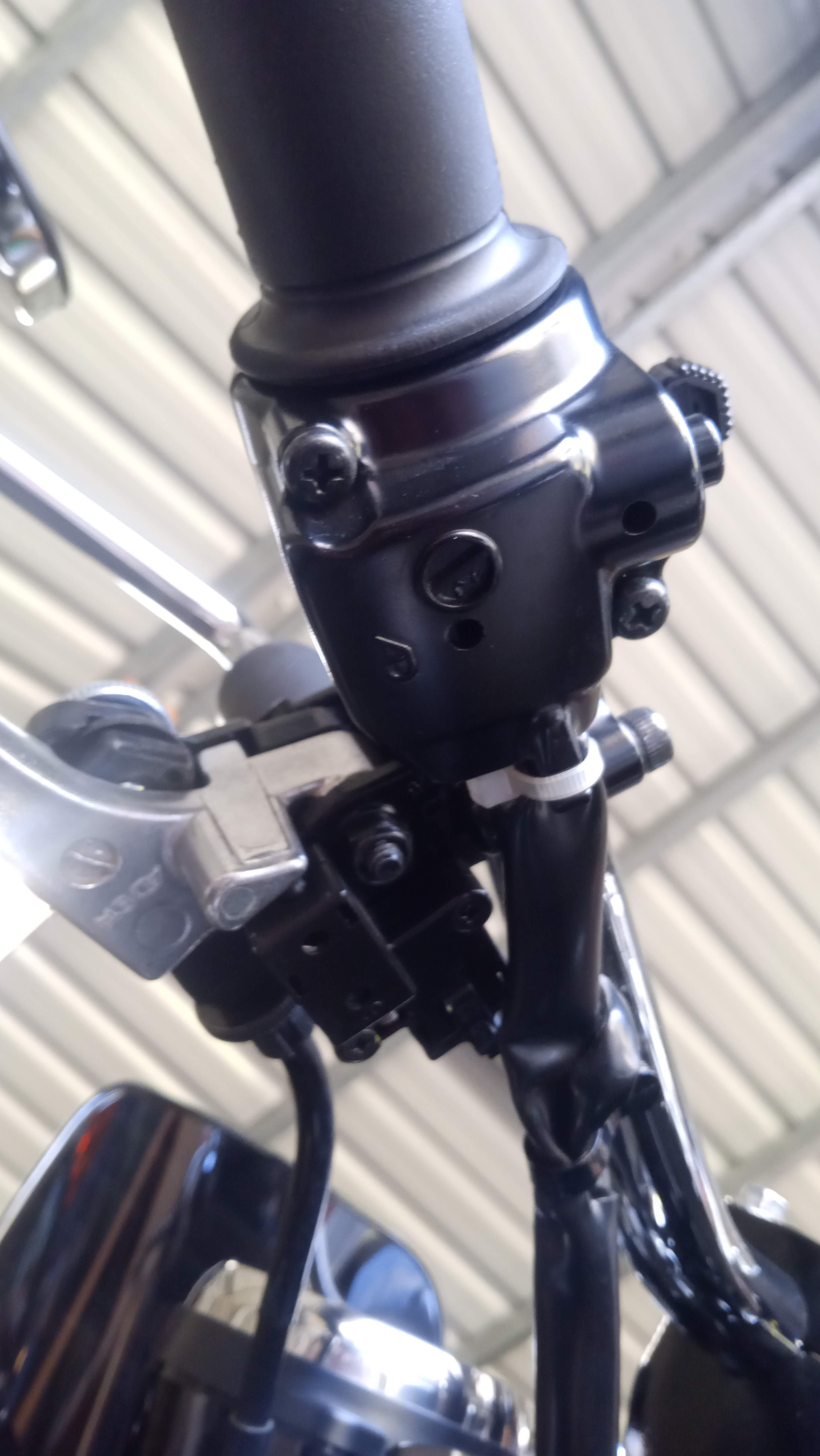

2. Remove both bolts on the left and right lever clamps.

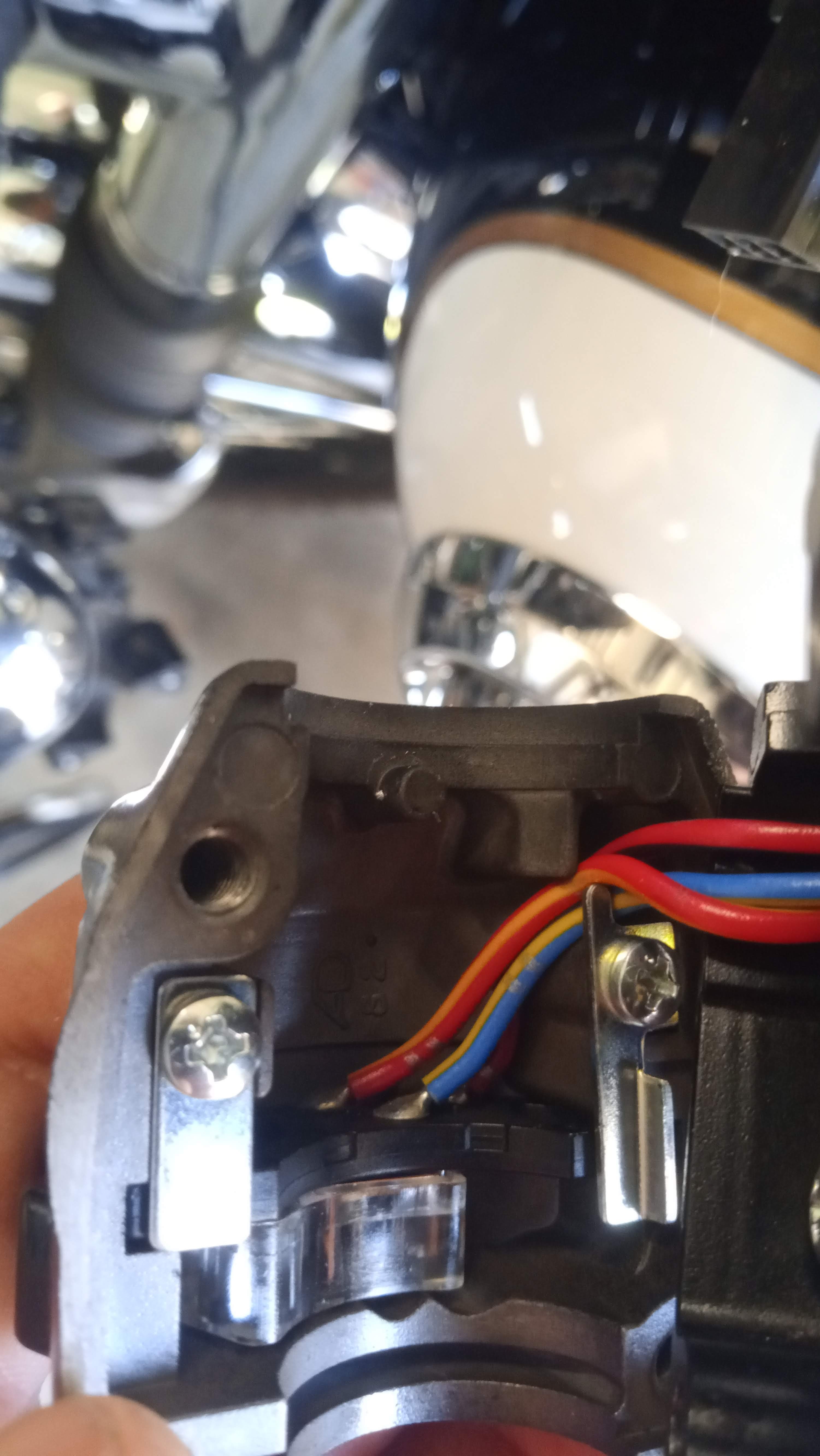

3. Remove both screws under the left and right controls and remove the controls.
4. Remove both grips from the bars.
5. Remove the 4 bolts holding the bars in place.
6. Mark a spot on the new bars to drill to align the controls.
7. Reverse above steps to fit new bars.
8. Slide bar end mirrors into the bars and tighten bolt to expand the spacer/sleeve to hold them in place.
9. Enjoy your new bars and mirrors.
Hope that helps some what Michiel.
Let me know if you need more details.
Thanks for the extensive reply!
Does this mean I have to install new bars to be able to fit bar end mirrors?
I was planning to just insert them in my stock bars, however I don’t see any clear way to fit them.. as there are no contra weights at the end of the handles.
Here’s a pic of the mirrors I bought btw!
cheers,
Michiel
No problem.
I can't remember if the stock bars are open at the ends or not. I do know they have solid pieces inside them to stop vibrations.
You should be able to fit those mirrors provided there is enough space inside the bar.
The ends of the grips will need to be cut to allow the mirrors to slide into the bars.
Check out this video by DCC on how to fit bar ends.

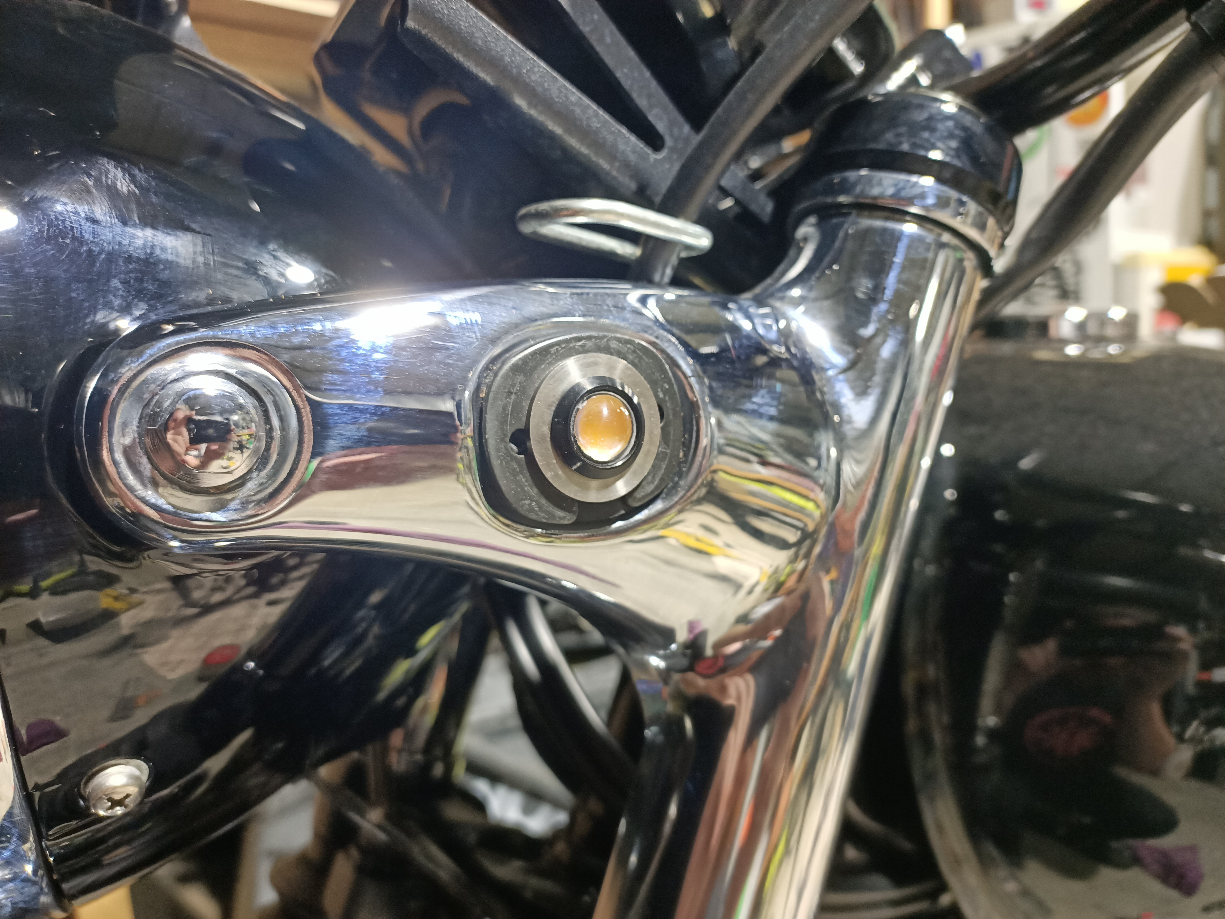

Been a while since an update. Finally got around to changing the front indicators out for the lighter ones I picked up at least 6 months ago.
I had the apprentice fitter at work spin up a few spacers to give the new micro indicators a bit better aesthetics. Thought a stainless spacer would look better than the stock steel plate.
These are at least twice as bright as the old indicators and half the weight. Shaving a few grams.
The old bar end style. Worked well but were hard to see due to low brightness.
The new Mirco indicators. Fits more with my idea of a "classic" didn't "need" indicators in the 50s and 60s.
Decent brightness compared to the others I had.
Still not as useful as usual indicators but I wanted them to blend in and go unnoticed until they were lit up.
