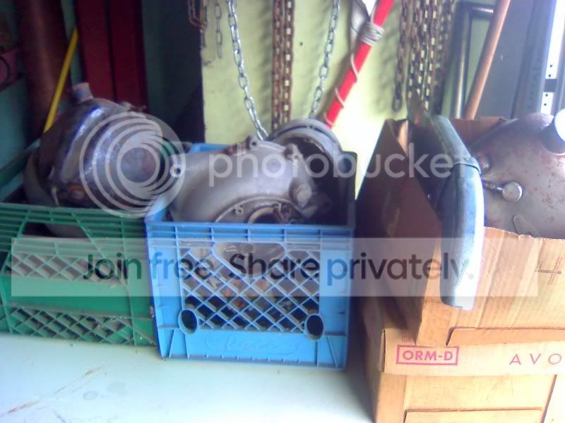

But although he never finished it he got lots and lots of engine parts for it, including 2 other sets of cases + covers and a whole other engine. But never got around to finishing it. So now I'm rebuilding it and I'm left with a whole lot of engine parts, and not many parts of the frame.
So I took this engine and decided to run with the cases from it. But I'm not exactly a british head so I don't know too much about these engines, But I've worked with motorcycles and engines for years. So give me on some critiques and guide me in the right direction if you see me doing something stupid :P. First thing being telling the life story.

So far I've polished the cases and I'm choosing the best looking covers to put on, After that I might tear the rebuilt engine down and work with it.

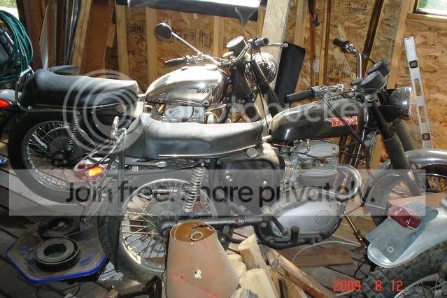

Also, here are some pictures of the frame. I don't really know what I don't have yet. But I have most of it. I'm pretty sure I'm just missing a few things like the original seat, handlebars, gauges, headlight, blinkers, rear fender, exhaust pipes, etc. But in good time I can either look deeper into the pile of parts in my barn or order new parts.
Welcome, which ever way you take it, its going to be a beautiful thing. You can't buy a bike with family history like that and its very cool that you have the opportunity to rebuild such a shit hot bike. Good luck and keep us updated.
