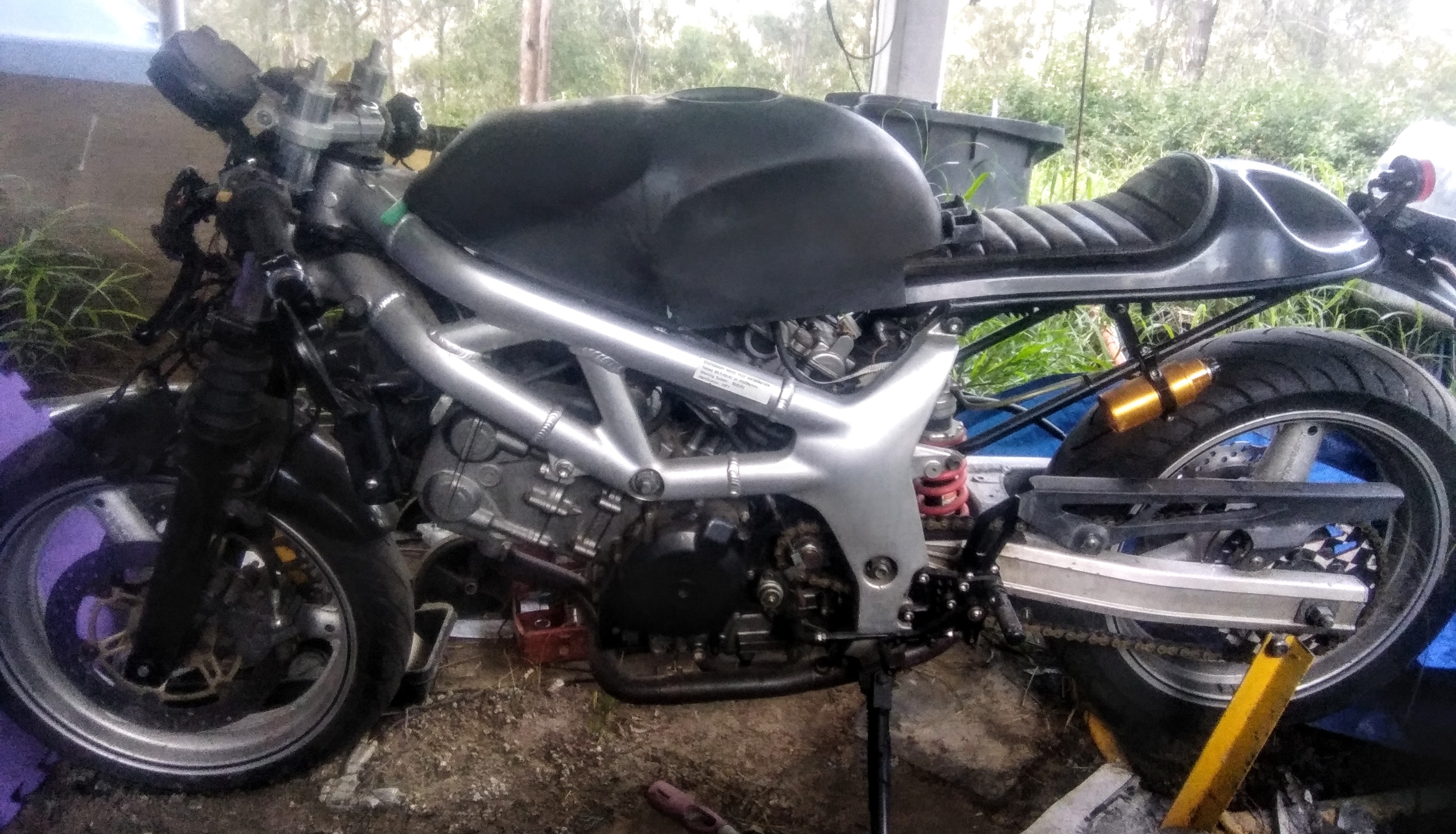

Spent time today doing a final trim of the tank shape, so apart from changing the fuel filler area, that is the look..
That is the final shape no real changes now just need to get stuck in and finish it.
Plan is original hinge mount on the rear, standard petcock, Honda fuel sender compatible with the gauge cluster. Harley sportster fuel cap boss and my quick release pins at the front.
I have all the parts so its all a go.
Apart from that the paddock stand is sinking from all the wet weather and there are match box cars down the muffler I need fish out $%@$

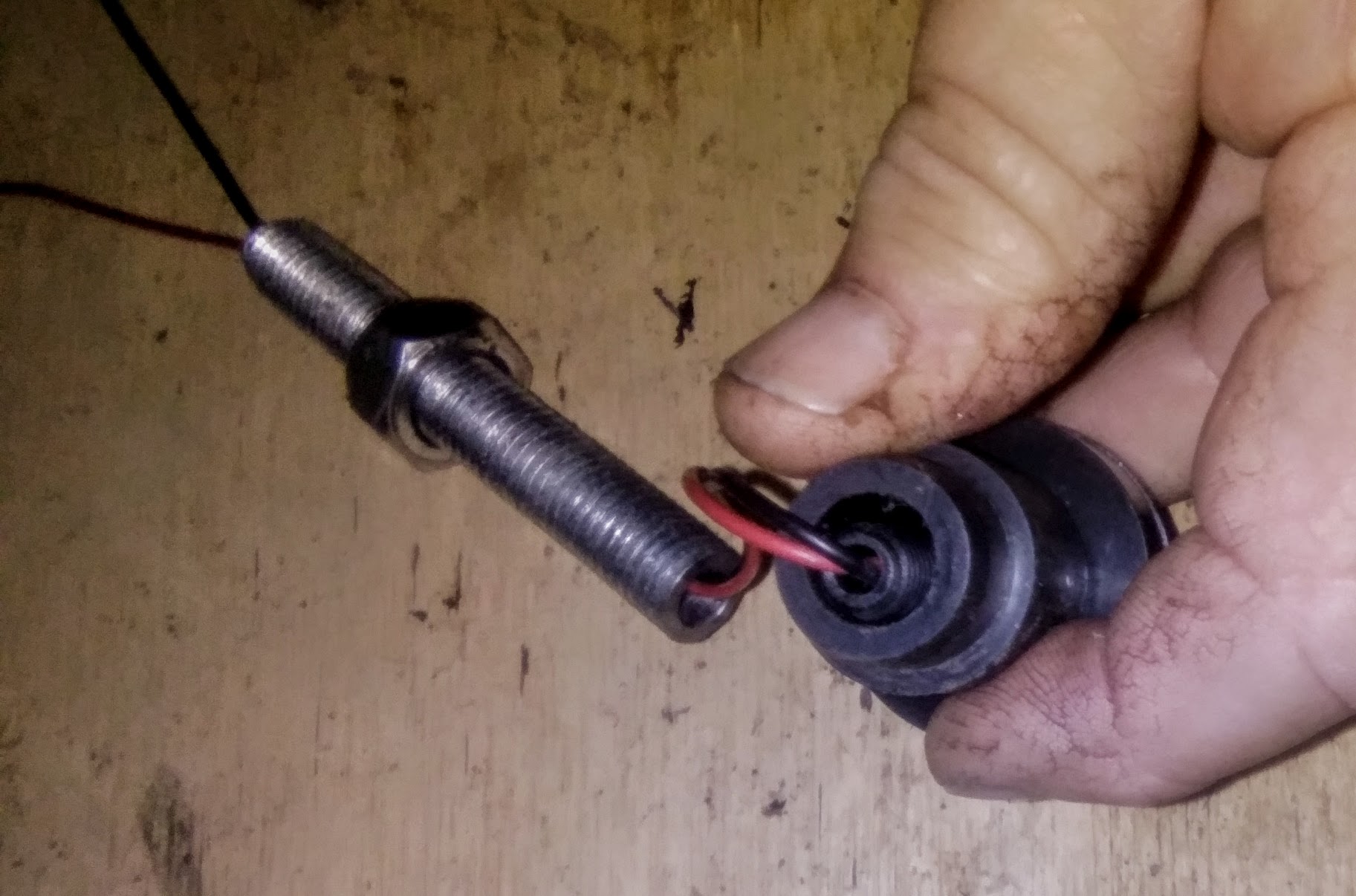

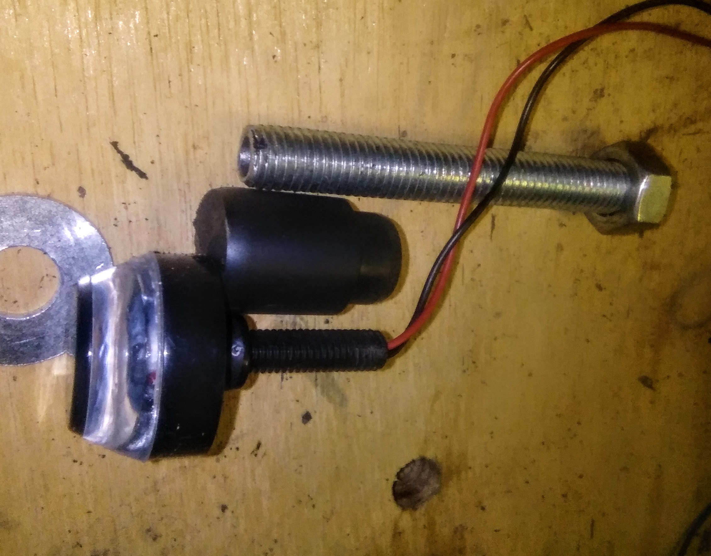

Been a horrible year but getting into it again, the tank still not finished but with the new fairing the plan is to have bar end indicators with the bar end mirrors so this is how the adapter is going for that. Buying some taps this afternoon so it will all screw together
Had a wee failure, nearly finished the second one and I cracked it in half mounting it in the vice to tap the 12mm thread.
After a rethink I have made a new narrower adapter using the alloy mounting bobbin supplied with the mirror.
Drilled and tapped so the weight will be taken on the 12mm rod, just as well because the indicator mounting thread I discovered is only plastic.

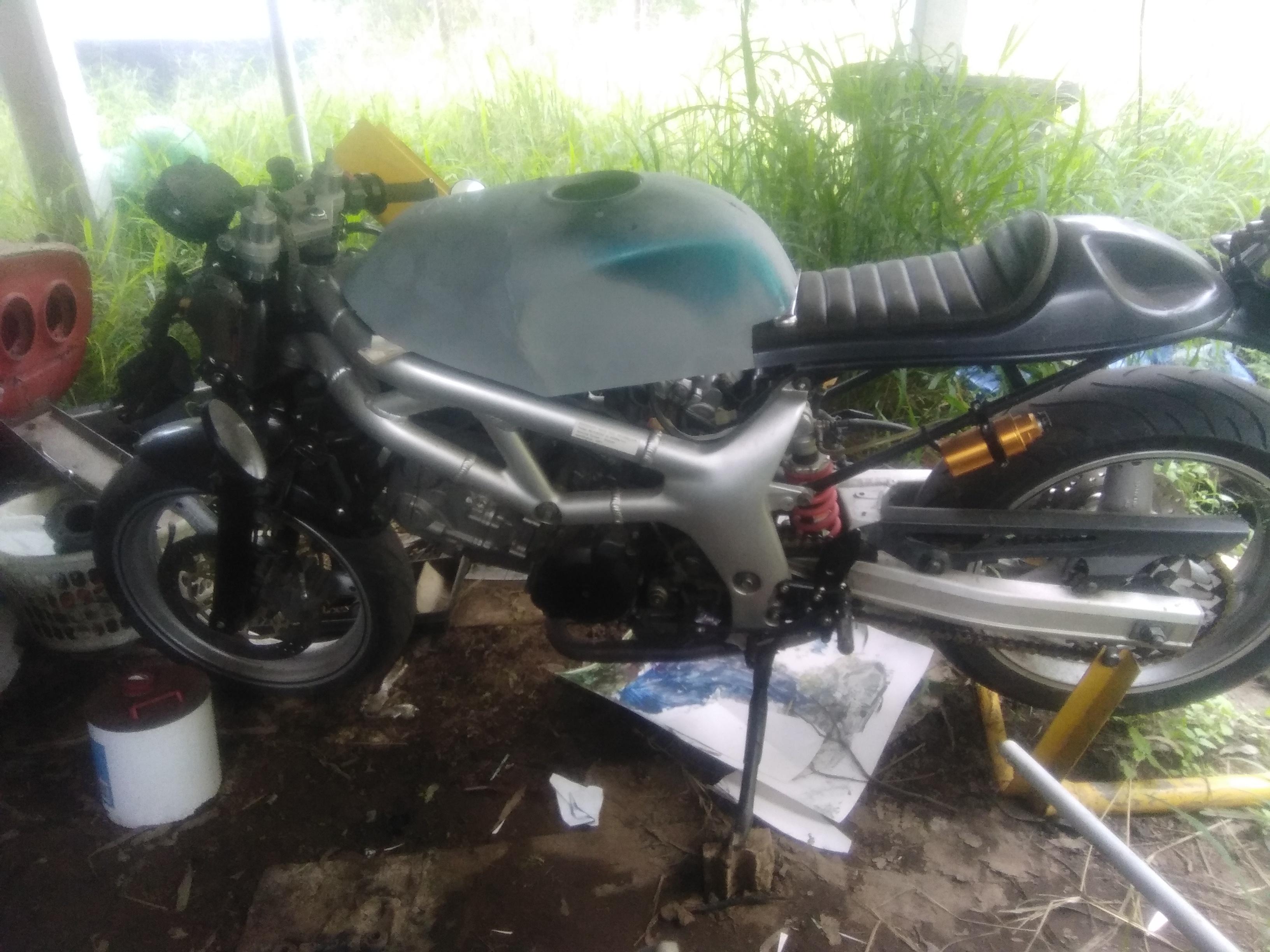

A little more progress. Handle bars in position to suit the fairing. Running my custom bent bars allowed me to rotate them to maintain ergonomics.
Smoothed some welds and massaging knee and bar dents, slapped some black primer on to just get better prospective.
