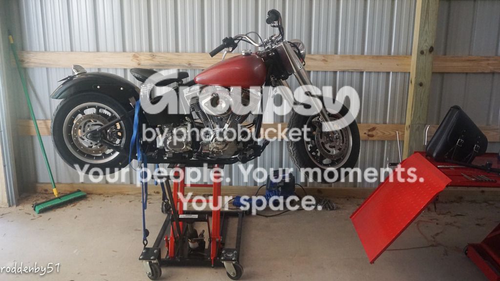

hillsy said:
Probably a bit late now that you're this far in but I think you should lower the rear guard.
I was thinking the same thing, but involved mounting to the swinger rather than just lowering
That's why I said to scrap the idea - pretty easy to do on a hardtail but on a softail it's a bit more problematic.
Not really all that difficult to mount fender to rear swingarm, worst is cutting off the fender struts from frame. Scoot settles about an inch on the suspension when on the ground, and there is about three inches of travel remaining, so the fender stays where it is.
I meant it's more problematic with hanging your brake light, etc off the swingarm and the bumps blowing out lamps as well as adding big amounts of unsprung weight.
Still think it looks a bit weird with the gap between the fender and the tyre....but if it works, it works.
Carry on 8)

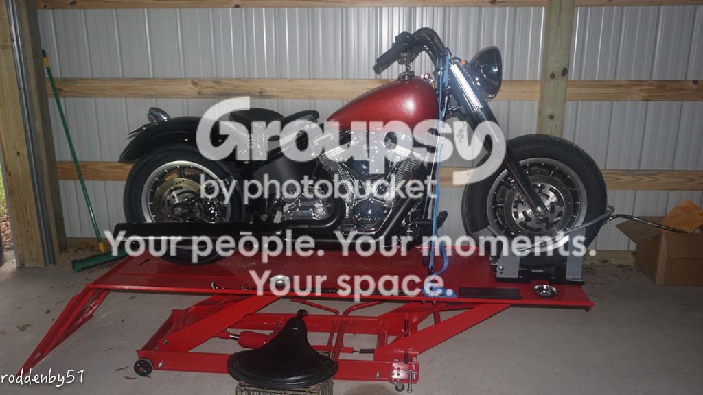

Controls connected, VOES installed (S&S anti-knock system), lambda (o2) sensor ports plugged in header, exhaust header temporarily installed:
Exhaust header (Dragos Dragula 3-step) is ceramic coated inside and out, (not chrome) black heat shields will cover header for an all black exhaust system.

Battery installed, oil lines installed, engine oil, transmission lube... Starter test, bendix engages and disengages properly, starter spins engine, oil pump primed, oil flowing through engine.
These are the lines of this scoot... little will change as the project is completed.
